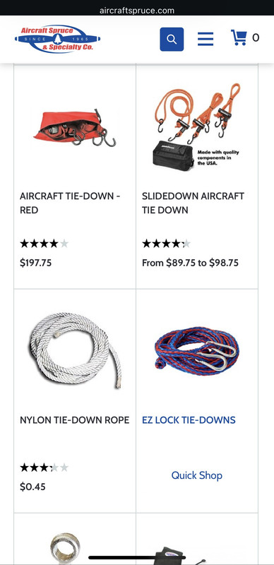

I was thinking about that, noticed spruce has lots of tie downs with the same type hooks, no that means too much

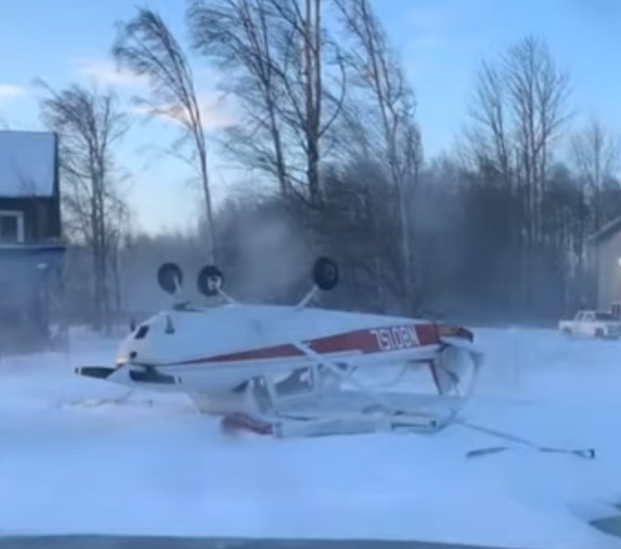

Here was a major microburst, saw it first hand, well kinda as I was in the building, with the rain and all we couldn’t see ANYTHING, but once it finished this was the aftermath
Cessna had some crappy lines tied to it, typically pilot knot work, the two little lines with better knots on the wings broke, the more solid line on the tail the quickie knot just let go
The PA 28 had generic ratchet straps with open hooks, only damage it took was some light paint scratches from the other plane

I've had great luck with the SlideDowns on my 185. It's been through some pretty bad wx on the ground at OSH when I was unable to move it and they held up. Been on a couple 30-50 MPH overnights without a hangar and they worked great.
I leave them in the plan all the time as they are easy to use and lightweight.
Sal the owner is a good guy as well.

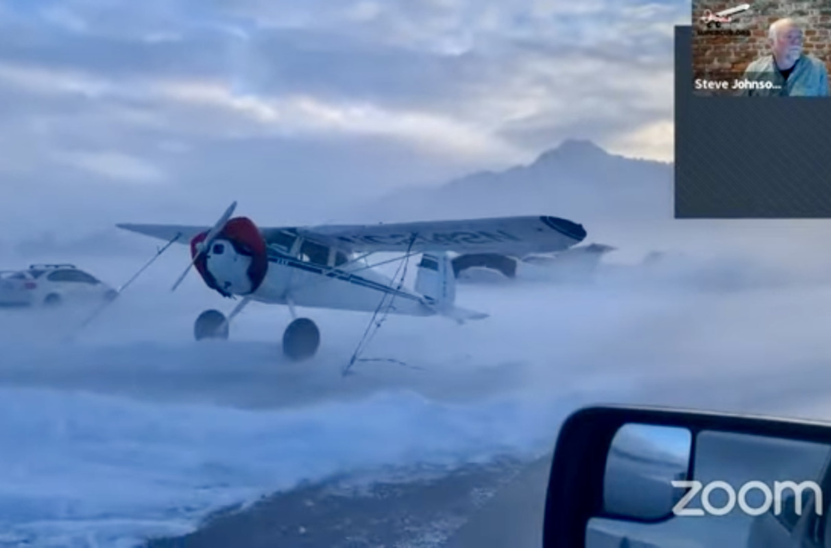

It is not the that the hooks fail, it is that the open hook will come off when the plane shifts and bounces. It is usually the ratchet mechanism that fails (cheap wallmart stuff). A quick look turned up 2 jan 2022 for a post on Flyout Alaska. Merrill Field does not allow tie down with ratchet straps. https://www.muni.org/Departments/merril ... Letter.pdf I have seen my share of crappy ropes and knots also.

Watching that video, these look like ratchets
From how it’s off the line and the tails, looks like a ratchet, plane is trying to fly and the ratchets (if that’s what they are) are not letting go
This one really looks like ratchets, but they are still attached, looks like it did a full loop on them?
Lots of airports are too many chiefs and not enough Indians, so the airport big kahuna “banning” something doesn’t mean too much.
I’m game to learn what I don’t know, but with camera phones being in every pocket for decades are there some good photos of ratchet/hooks failing on tiedowns?
Best I could find was that torture test and that would have snapped my spars before the hooks bent to the point they couldn’t hold the plane
Based on the looks of it both planes are possibly totaled due to crazy winds, so at that point is to make sure the wreckage stays in the same spot?
Biggest thing I learned from that video is if winds are looking to get that high plane needs to be elsewhere or be a write off
