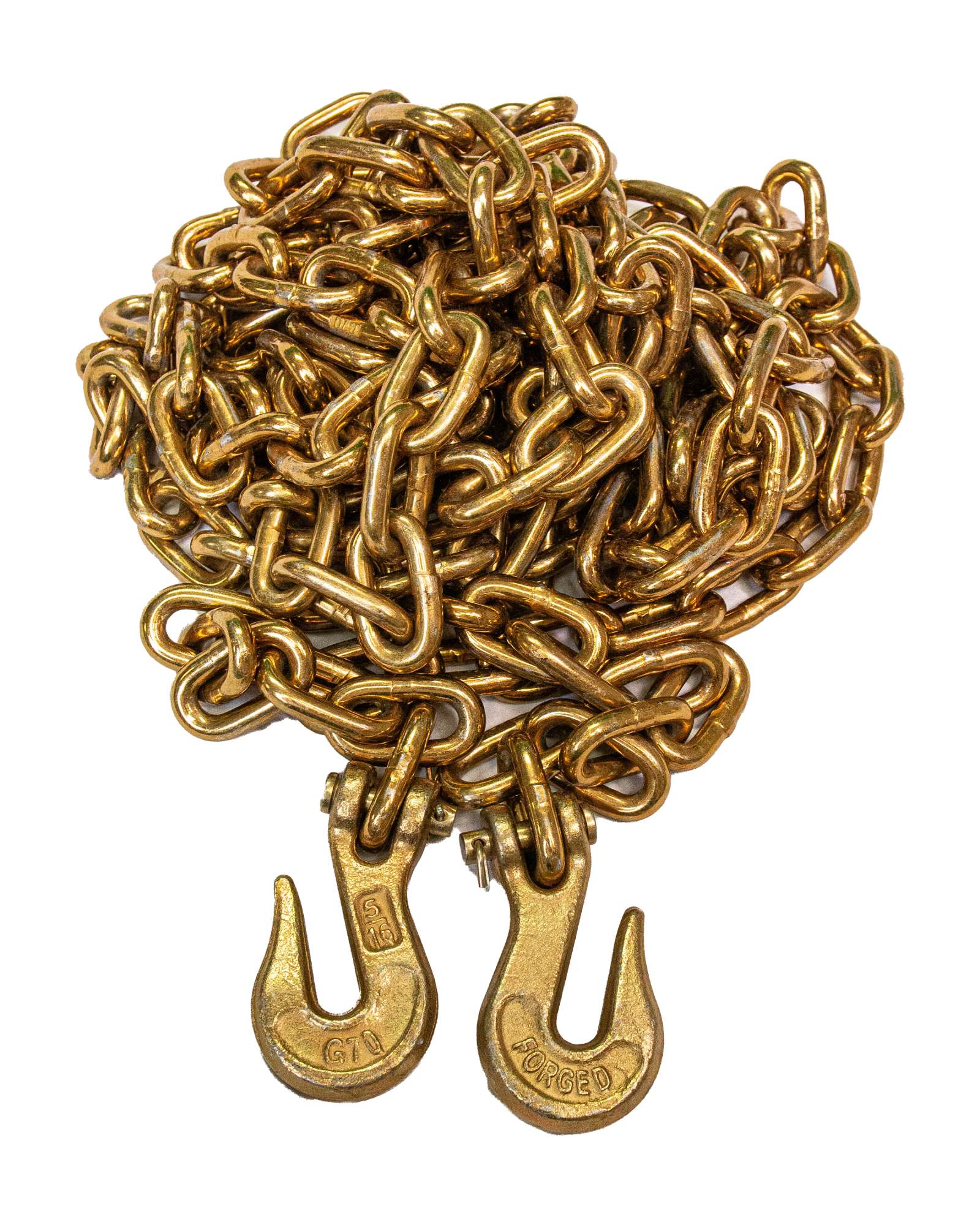

I've contemplated this a lot and my strategy has evolved over the years. For my maule, I use 3/8" transport chain with open hook ends. I find it's quick, affordable, definitely stronger than any plastic rope/webbing/strap, and doesn't have any give so I don't have to worry with the plane rocking about.

asa wrote:I've contemplated this a lot and my strategy has evolved over the years. For my maule, I use 3/8" transport chain with open hook ends. I find it's quick, affordable, definitely stronger than any plastic rope/webbing/strap, and doesn't have any give so I don't have to worry with the plane rocking about.
Lordy, how hard does the wind blow there?

asa wrote:3/8" transport chain with open hook ends.
Stored in a tidy box in the aft baggage to balance that boat anchor out.
