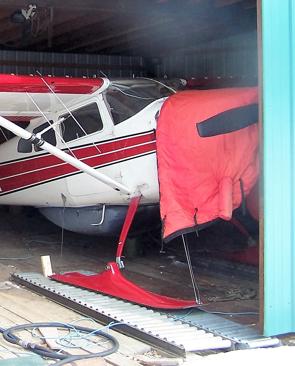

I have 10' roller sections that I use to slide my aircraft into the hangar when on straight skis. The aircraft will not care how it is oriented as once on the track it will move in whatever direction the track is oriented.
Mine depicted are heavy duty. For a light aircraft, the style used by grocery stores back in the day would be fine or fabricate your own. For Kitfox weight, a pipe within a pipe "roller" (multiples) secured to a frame would work. The end result would look like my rollers depicted but "homemade".
Airglas3000 on Rollers.JPG (266.18 KiB) Viewed 1480 times
