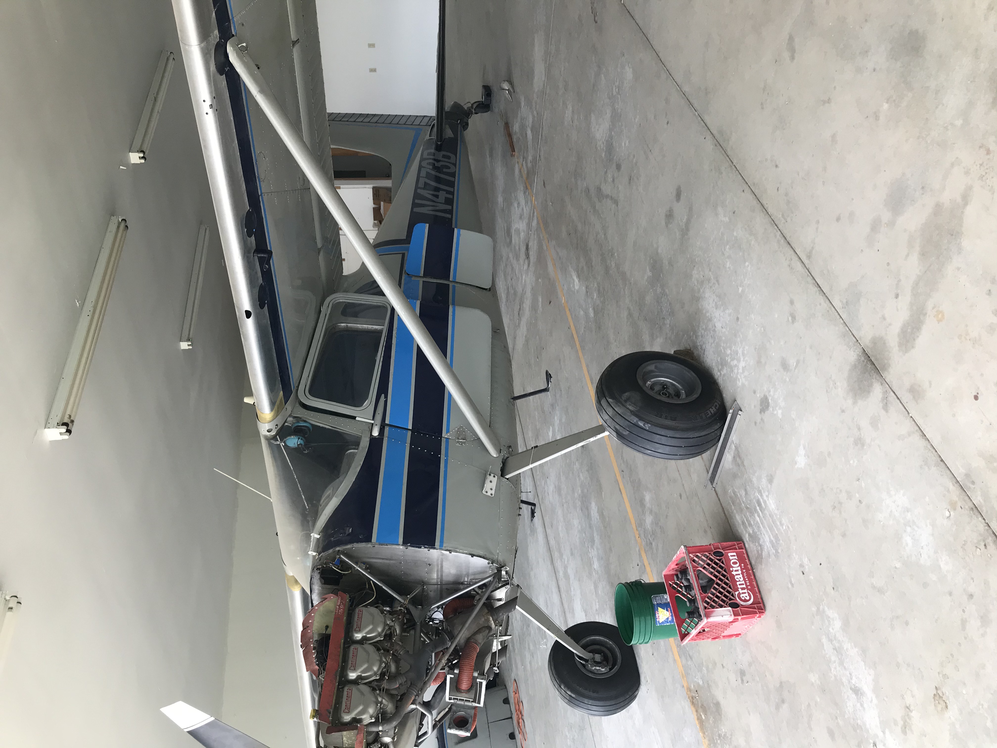

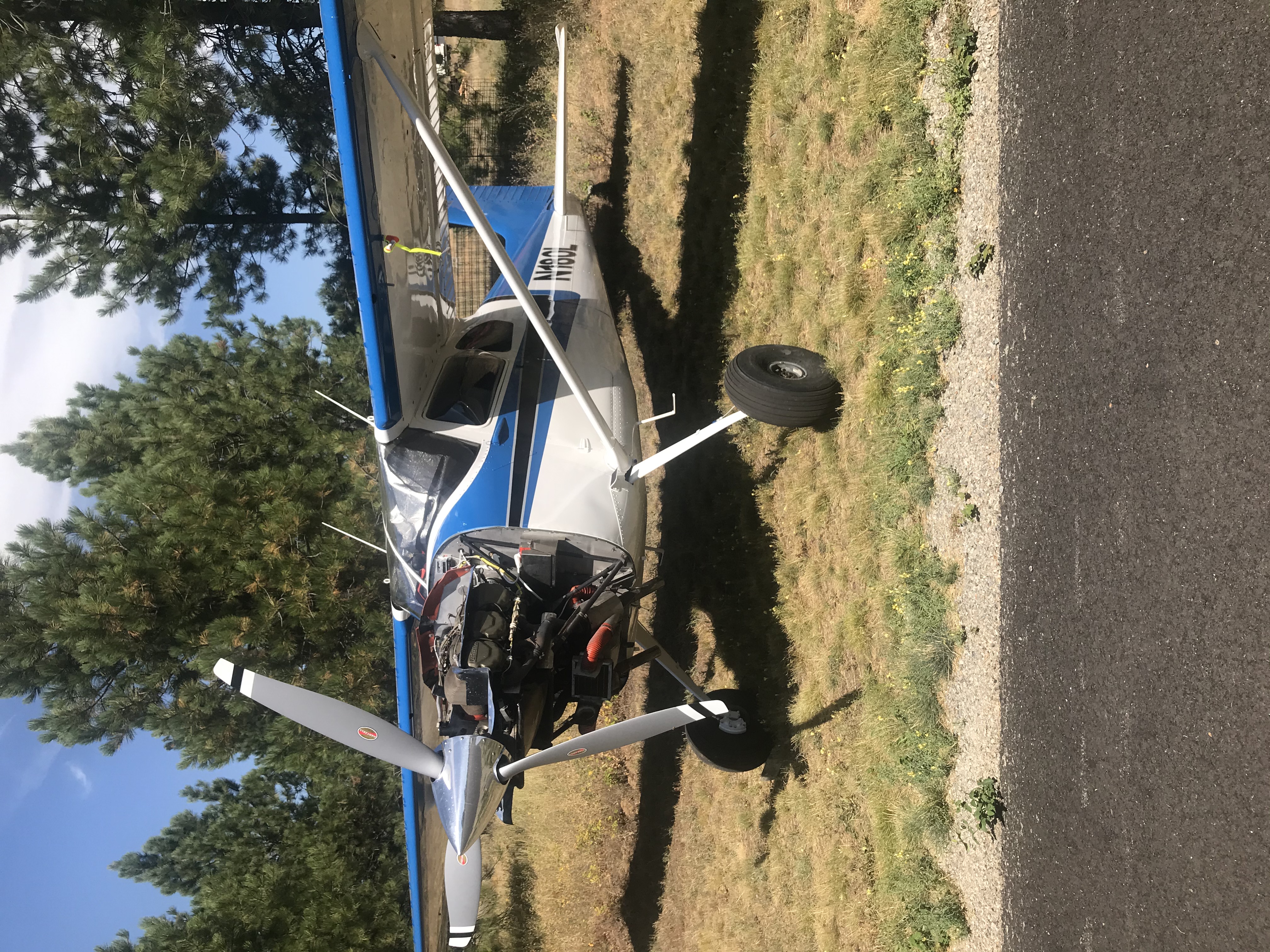

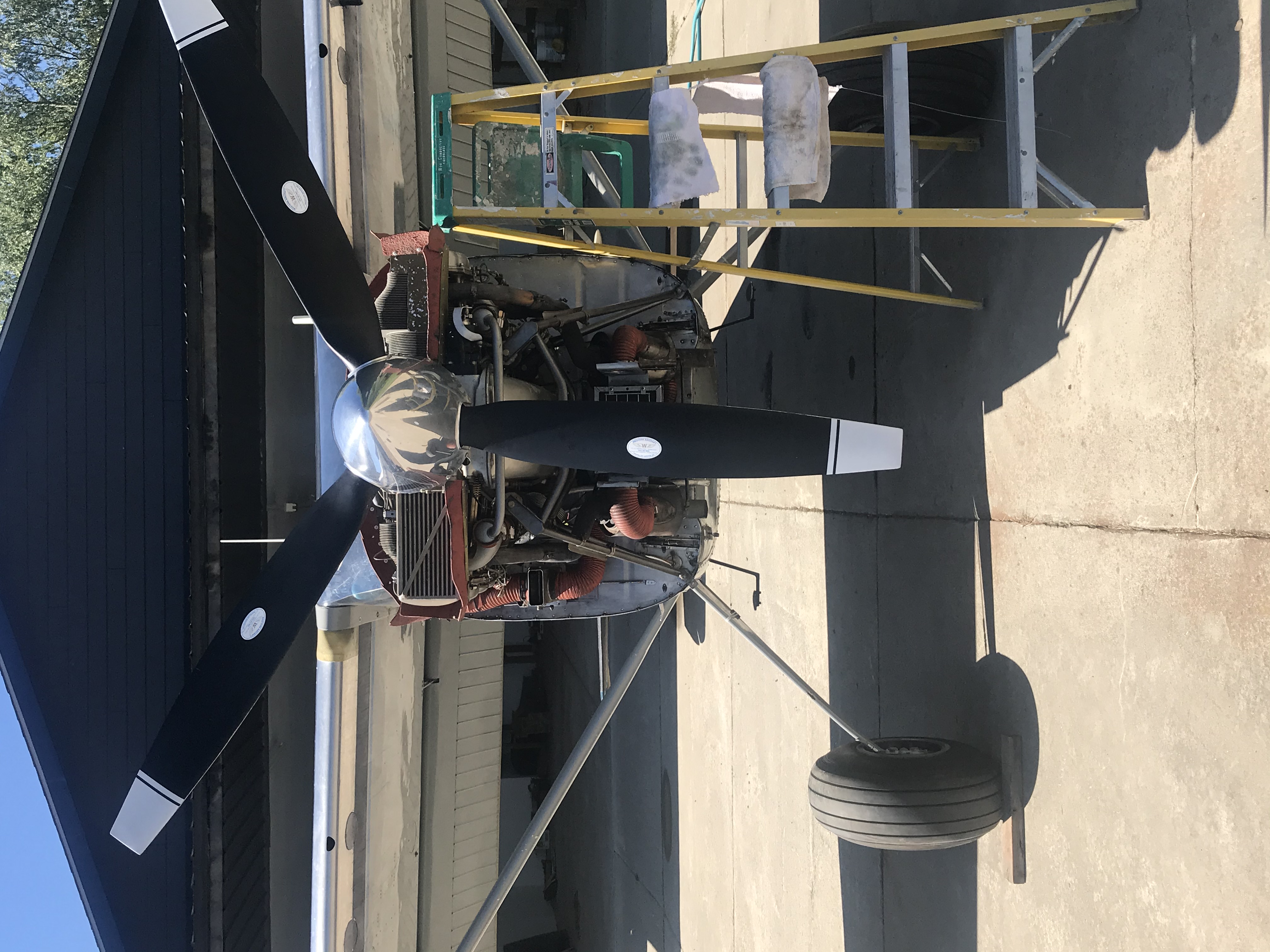

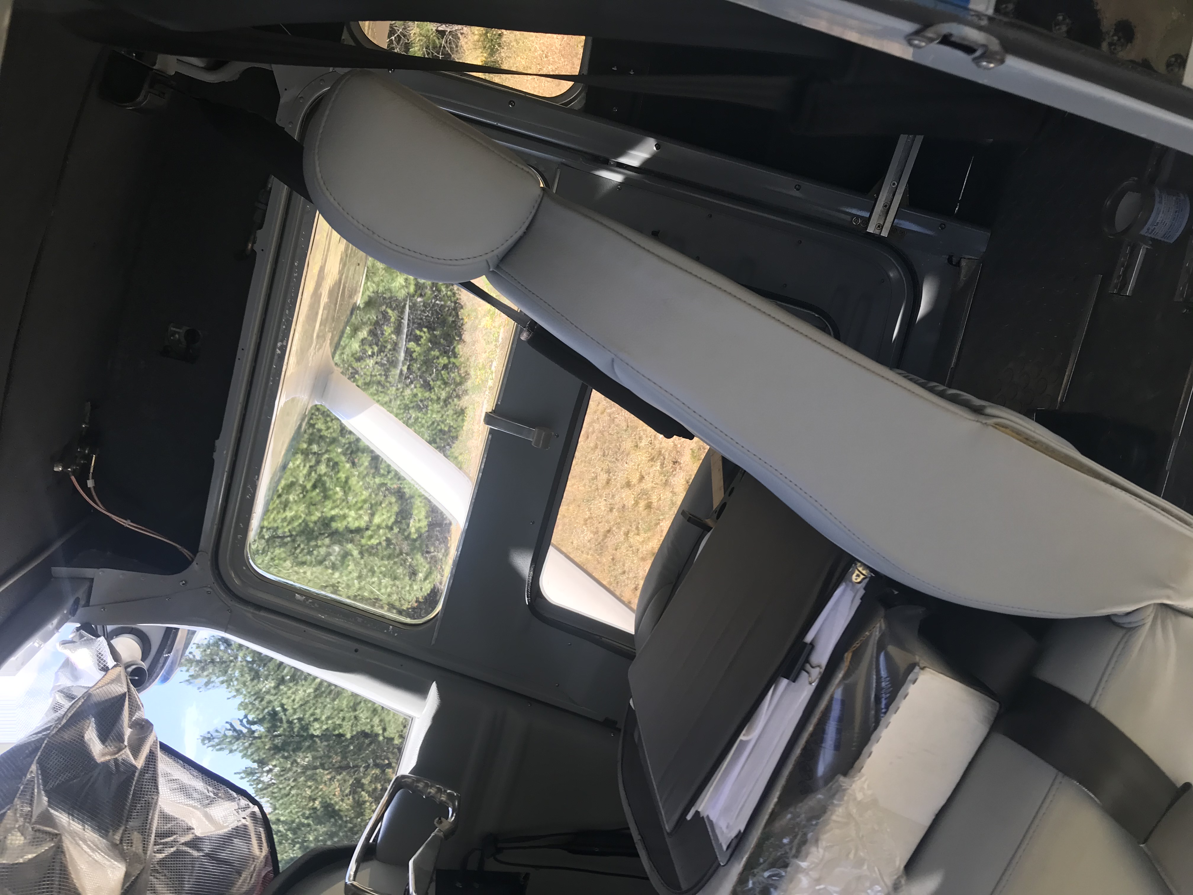

Here's a quick pic (its going thru annual).
My 170 appears to have a new owner, so I'm moving forward on this 180. I think my short list of things to do first is interior (my wife hates the carpeted door panels). I saw a 180 that I really liked today and what they did with the interior.
On edit, I have no idea why the images are turned..

I see you were over at Scotts shop. He’s my neighbor. AAA +++ rated Skywagon man. Extremely Knowledgeable and excellent resource. =D>
RockHopper offline
Posts: 213
Re: Soon to be a 180 Owner
HA! Why yes I was at Scott's shop! Great guy and has a ton of knowledge!

I'm confused because you posted pics of two different 180's. Buy both!
But really, congrats and have fun with the transition. I'm sure it won't be an issue with a good instructor and some time.
Posts: 1532
If I'm following the conversation correctly one is the purchased 180 and the other is the prefered interior.
Mapleflt wrote:If I'm following the conversation correctly one is the purchased 180 and the other is the prefered interior.
Reading isnt my strong point. Yeas that's a nice interior
Posts: 1532
Yes exactly right!
The top pic is the plane I'm getting, the bottom is the interior I was considering doing. More of a "utility" type look. Kinda like it!
