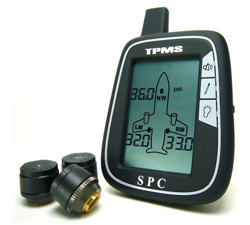

Here is an interesting little gadget for small aircraft. I just put 4 new tires with new remote pressure sensors on my Jeep. Ouch. Anyway, I was curious what the deal might be for small aircraft, and again, Google is my friend. At Aircaft Spruce.

http://www.amazon.com/Accutire-MS-4378G ... B002PMM9N2
$82 on Amazon. And has a spare pressure monitor in case one of the other three goes bad :)

Got a lot of bad reviews and I would be concerned that it would upset the balance of the tires. I just hape driving a vehicle with unbalanced tires.

Geez, guys.....just buy a good digital tire gauge and check pressures once in a while. Cheap and easy. Doesn't have to be every flight, maybe once a month, unless you're running REALLY low pressures. No need for a bunch of gadgets, and more crap in the cockpit. Tires don't fail that often.
Re: Spontaneous flat amphib tire
Ditto on the tire gauge, unless you just have too much money and have run out of other cool shit to buy.
I recently bought my first tire digital gauge when I realized that the three cheapie stem-type tire gauges I had all gave (sometime wildly) different readings. Seems accurate, I really like it. About $10 at NAPA.

Denali wrote:Here is an interesting little gadget for small aircraft. I just put 4 new tires with new remote pressure sensors on my Jeep. Ouch. Anyway, I was curious what the deal might be for small aircraft, and again, Google is my friend. At Aircaft Spruce.
That little device might not be as ridiculous as some think. Picking up a nail on your take-off roll and not realizing you have a flat tire when you land is a guaranteed way to scuttle your airplane. You might bend her regardless, but if you know your tire is flat at least you've got a shot at keeping it under control, and you can burn off excess fuel and choose your landing site with a potentially bent airplane in mind.
I run Norton no-tubes sealant in my tires, but I can attest from using it in bicycle and motorcycle tires that while it helps, it's far from a sure thing.
