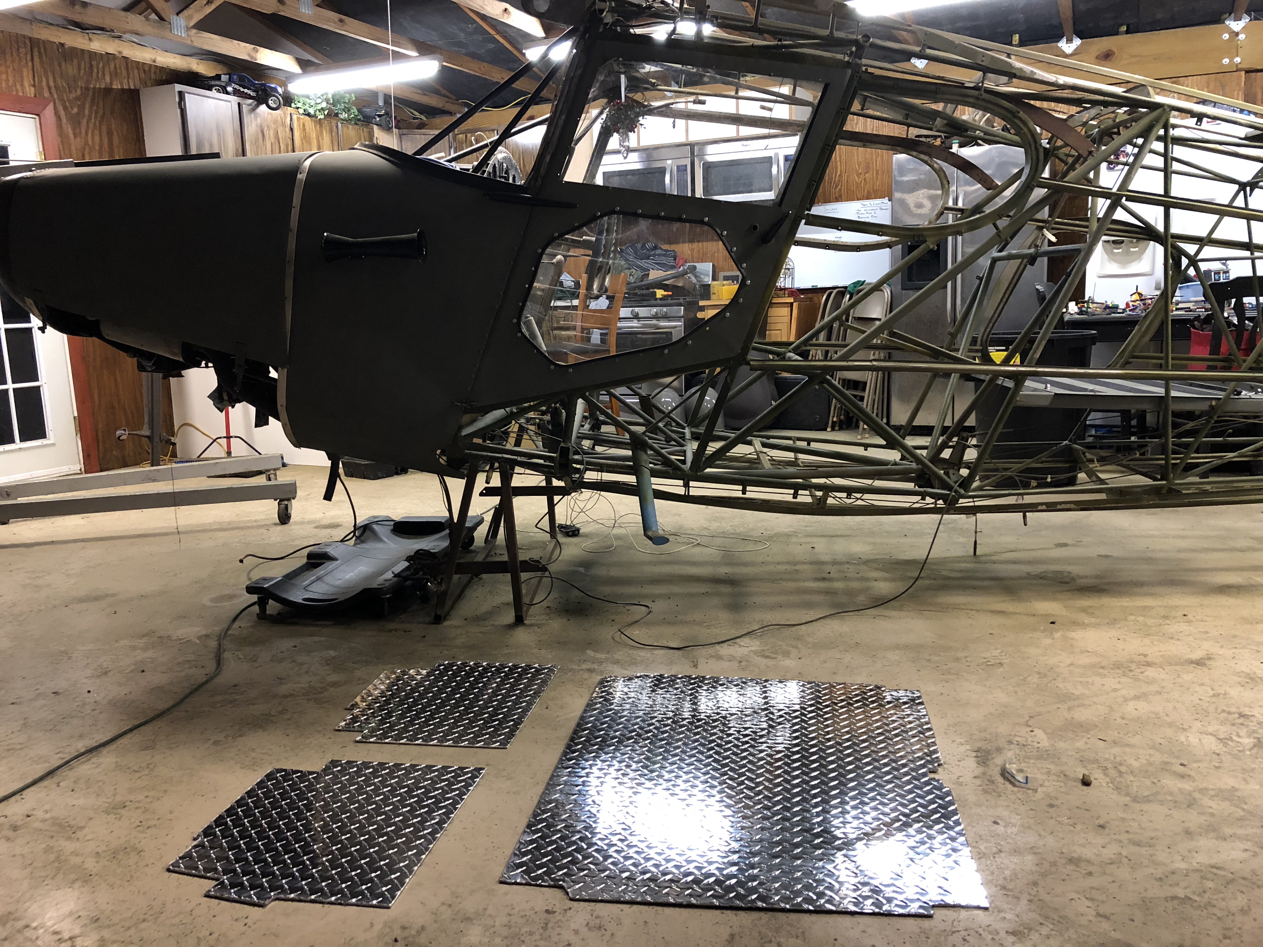

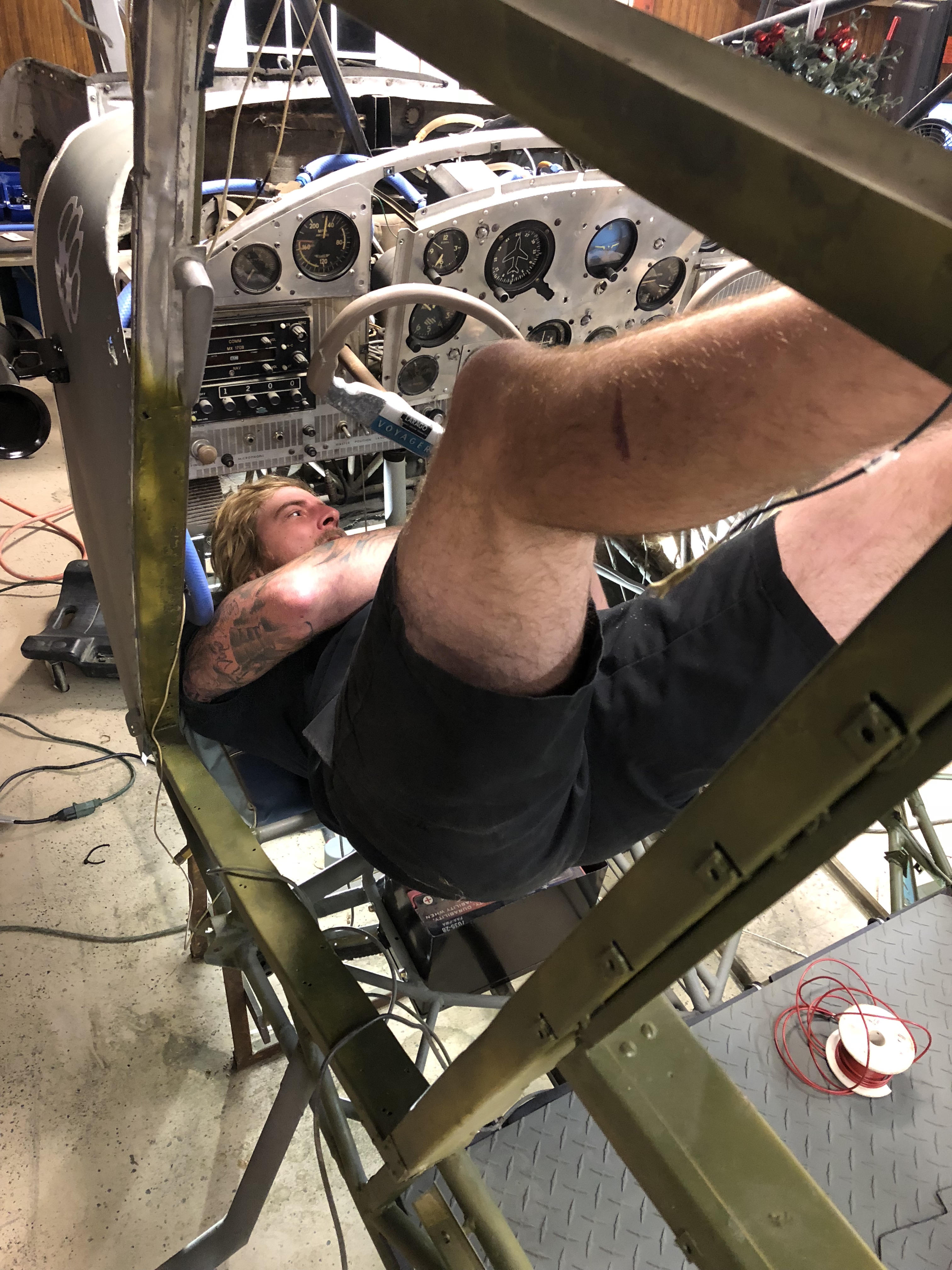

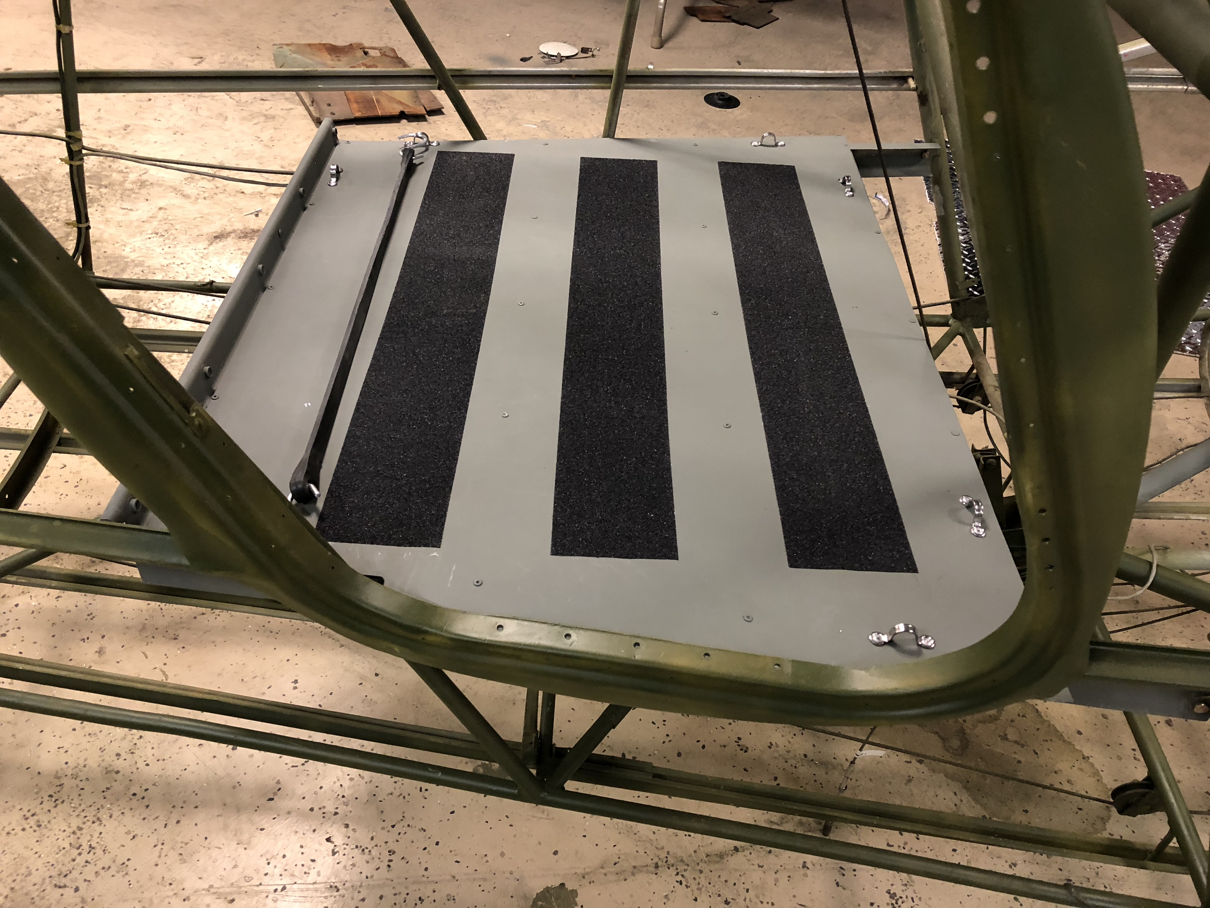

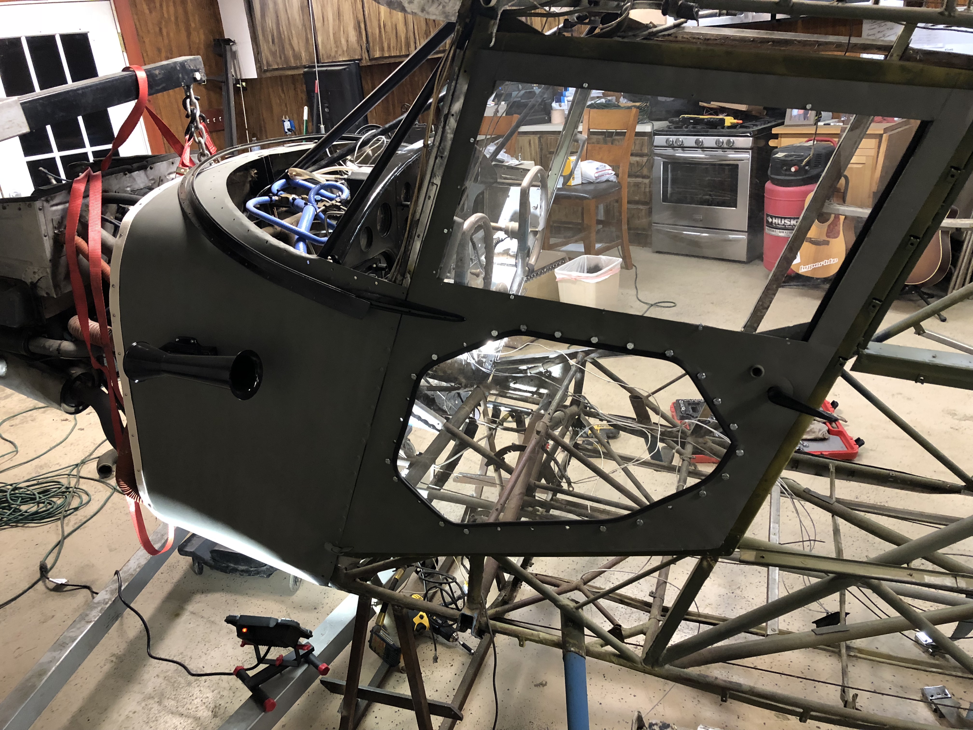

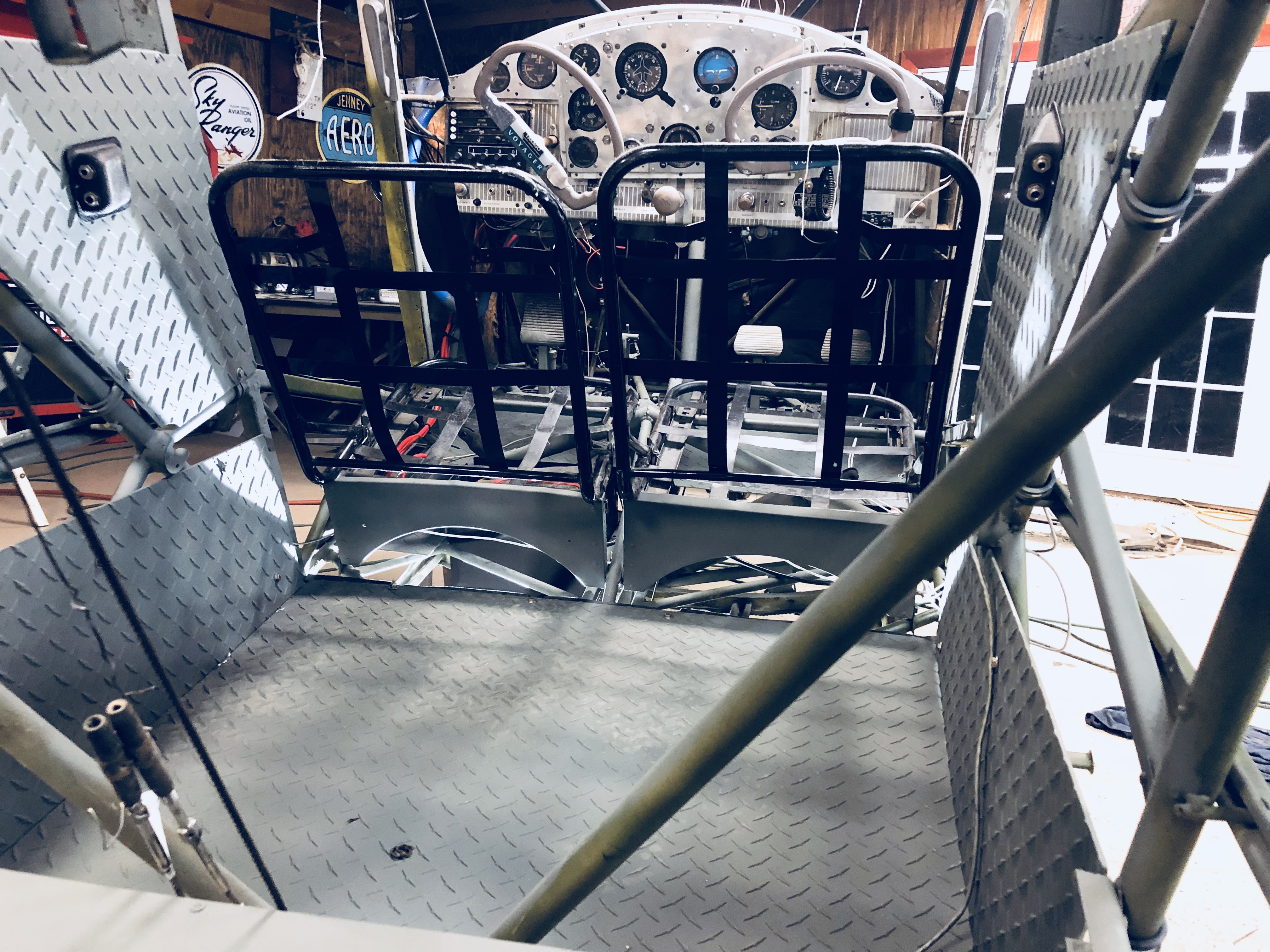

So this Stinson rebuild project is coming along nice.
-alum diamond plate floors
-patrol doors
-completely rewired
-new vac lines, fuel lines
-losing as much weight as possible
-31" ABWS
-new paint
-new fasteners
-new fabric
Super excited to have this bird back in the air. Then, I get to start on the next one... its a bare fuselage though

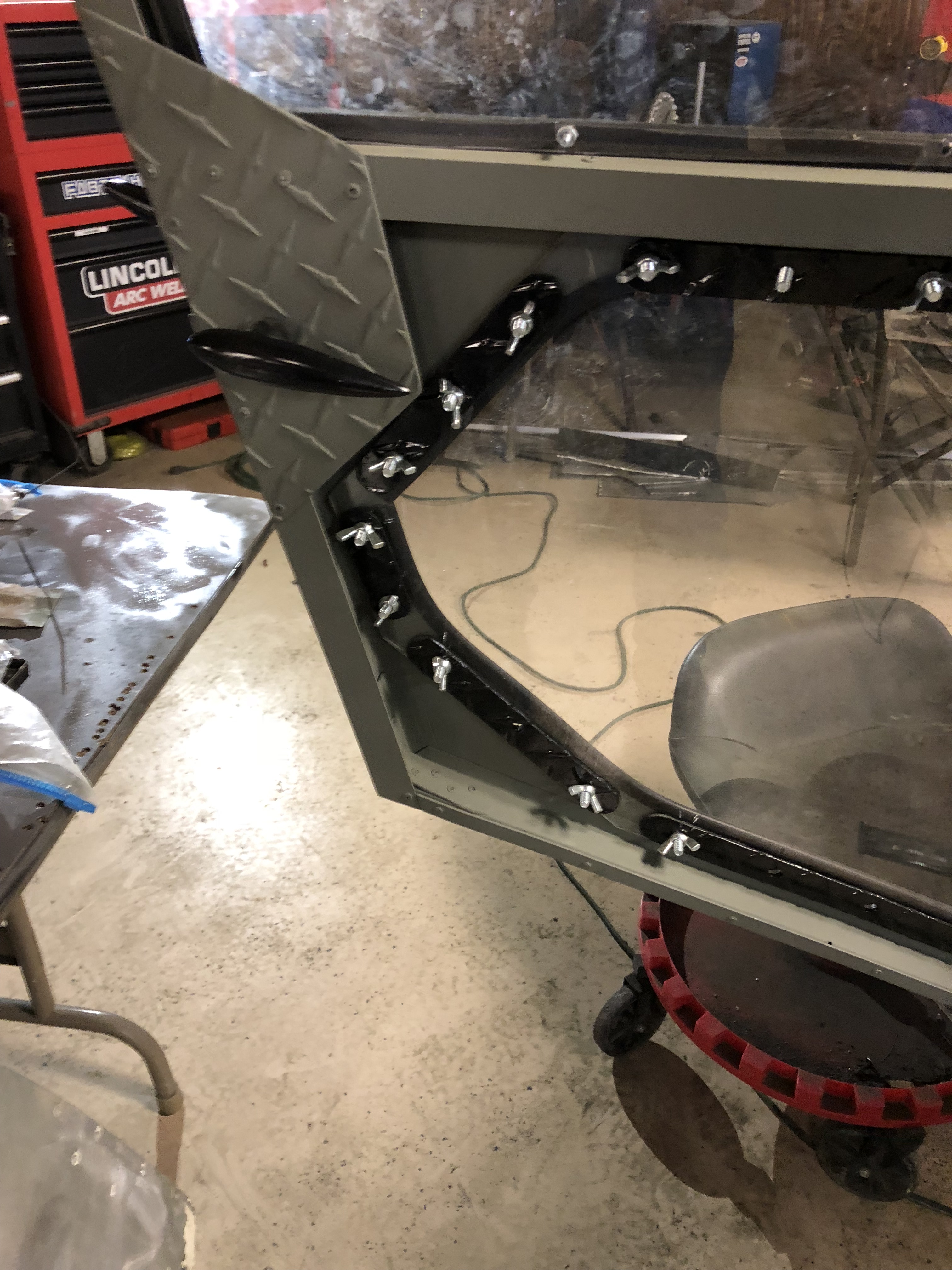

Patrol Door
Patrol Door
Cargo area
floor
plane
interior

How much does the aluminum flooring weight compared to carpet or coin flooring, it looks cool ?

The old interior that I pulled out weighed almost 70lbs and as of right now the new interior weighs 16lbs. I also shaved 9lbs off each door.
I’ve had my ap/ia come out and check on things throughout the build and he agrees that it won’t need to go “experimental”. I’ve gone back and forth with the idea though

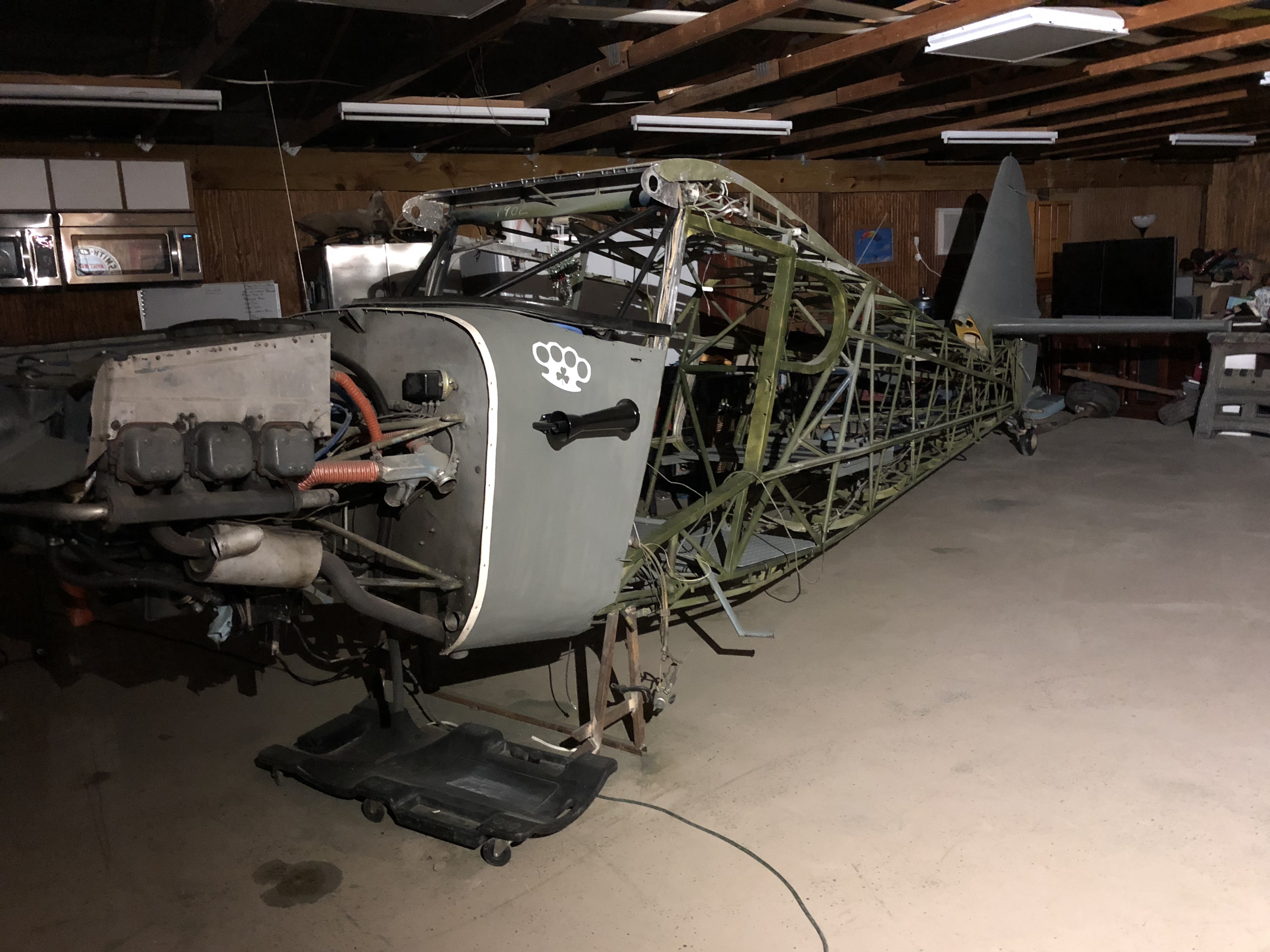

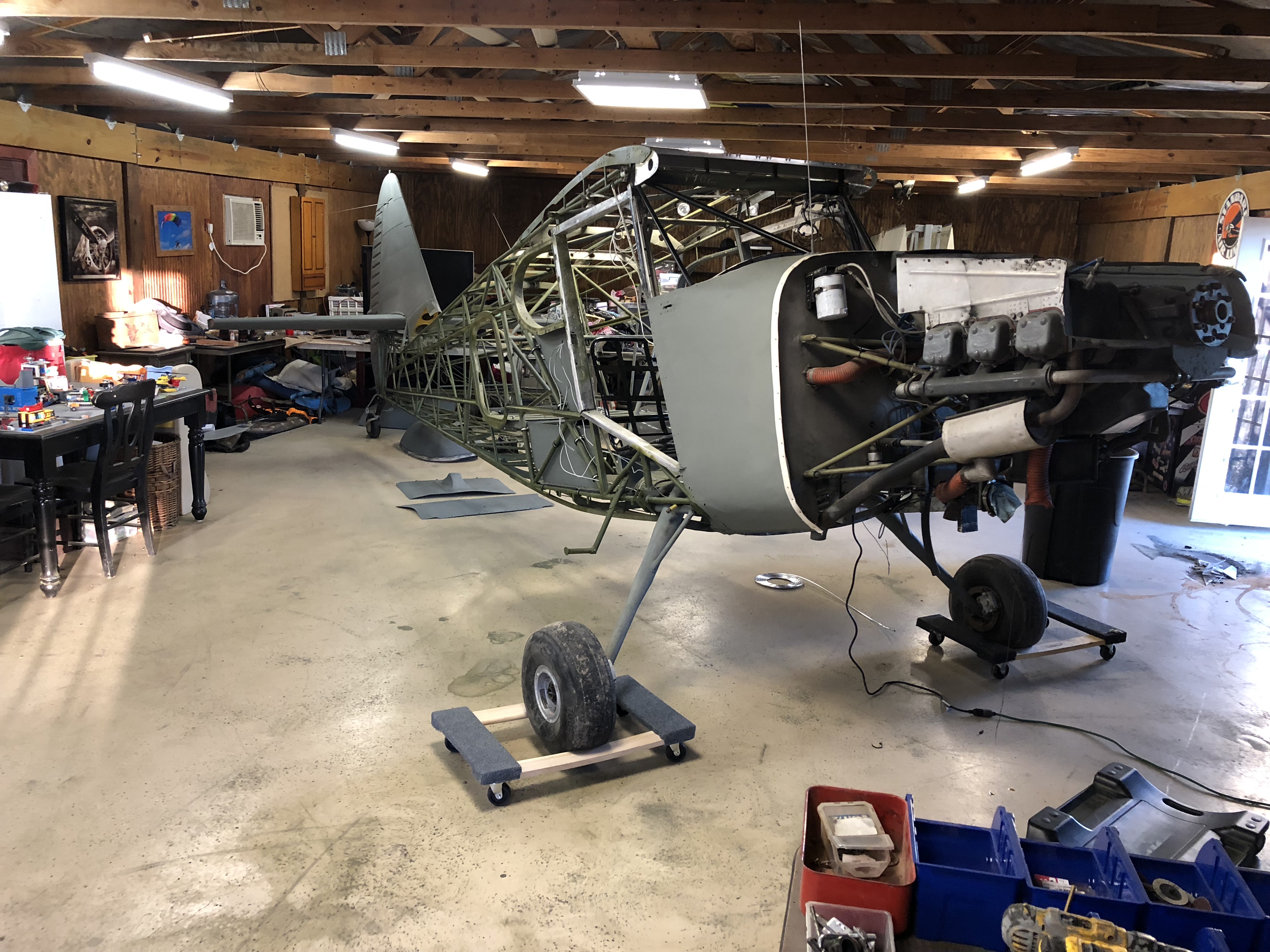

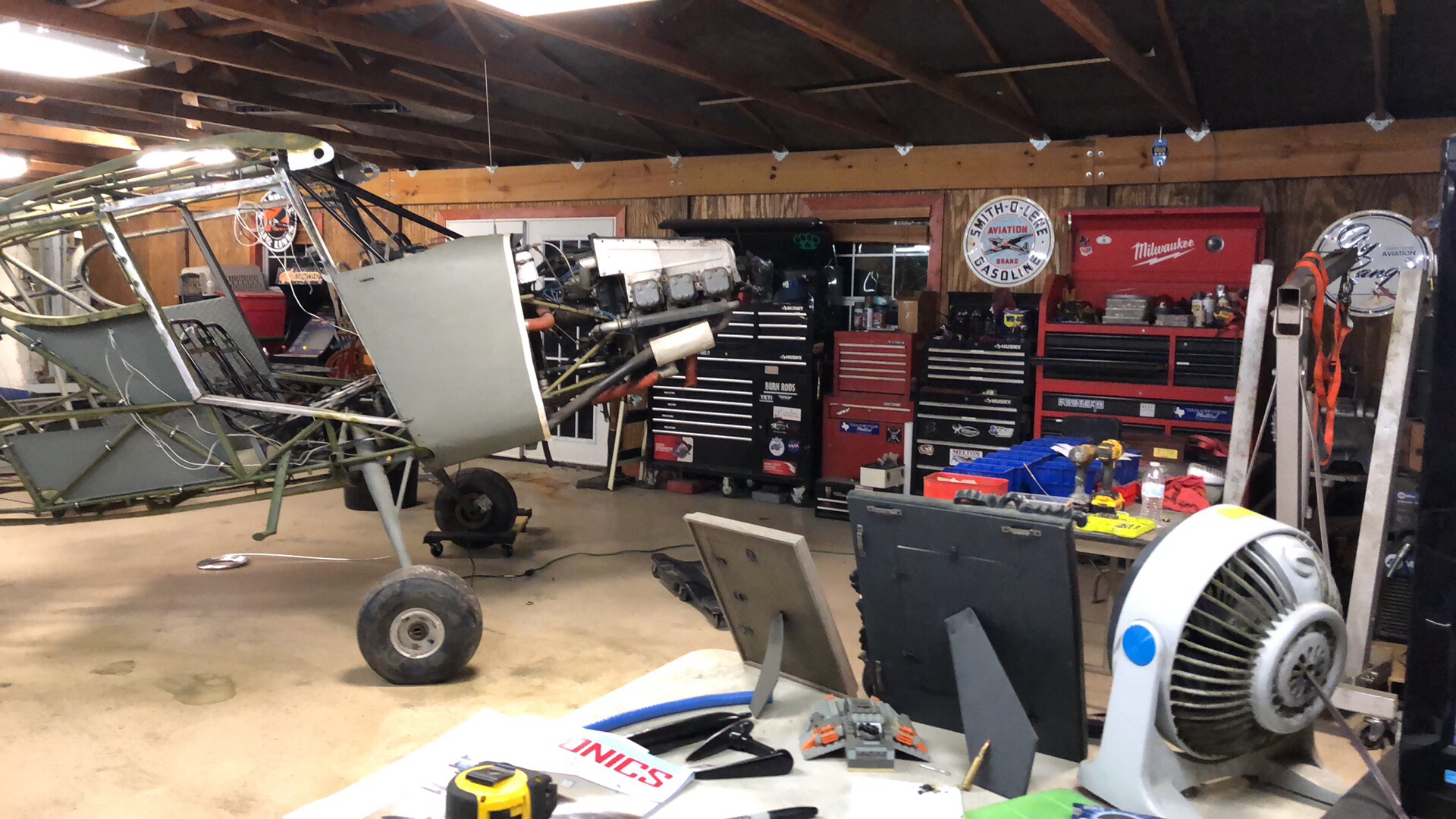

Here’s a little progress update. With a stuck exhaust valves and bent rod on cyl 2 on the Franklin 165, I ran across someone getting rid of a fresh rebuild 150. It has current hours and basically etc. got it for a great price with a seaplane prop included. Figured I’d do the test flying with the 150, and rebuild the 165.
So, the new stuff is a powdercoated engine mount with new engine mounted, patrol doors buttoned up, powdercoated yolks and stems, new throttle and mixture controls, and a spare “lot” of parts that included this fuselage and a ton of other stuff
