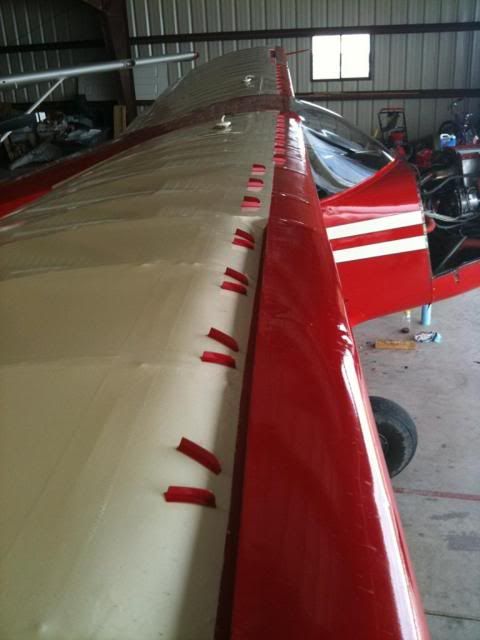

EZFlap wrote:The VG's will also improve STOL performance to one degree or another, because (as advertised) they add energized air into the boundary layer which keeps the flow attached to the wing at slightly higher AOA than otherwise possible. The slots will also do this same job (as mentioned), but on a Stinson the slots are only on half of the wing. So you should still see a noticeable benefit by installing the VG's, even if the half-span slots are already there. Even if the VG's don't do anything the slots don't already do (arguable), the VG's will be on the whole span which the slots aren't. Although I do not have any personal experience with Stinsons, I would expect there to be some measurable reduction in stall speed and max Alpha with the VG's.
Although definitely NOT do-able on a certified airplane without a bunch of testing and an official approval... adding the VG's likely would allow you to remove half or 3/4 of the twist (washout) on the Stinson wing... because the VG's are now there to get rid of that softened aileron control and tip-stalling problem which the twist was intended to solve originally. Having the wing flat instead of twisted would give you better STOL performance, at the cost of the airplane being less idiot-proof at low speed. Also, you would theoretically have to reduce your maneuvering and gust speeds because the twist lessens the loads on the wing during gusts and hard maneuvering.

EZFlap wrote:.... they add energized air into the boundary layer which keeps the flow attached to the wing at slightly higher AOA than otherwise possible. The slots will also do this same job (as mentioned), but on a Stinson [u]the slots are only on half of the wing......
.. adding the VG's likely would allow you to remove half or 3/4 of the twist (washout) on the Stinson wing... because the VG's are now there to get rid of that softened aileron control and tip-stalling problem which the twist was intended to solve originally.......
Maybe the slots were there to make the wing root stall first, before the airlerons lost authority- same reason that Grumman Yankees have stall strips on the inboard leading edge. If you get rid of the washout, the tip might stall at the same time as the root-- bad news. If you added VG's only on the outboard end of the wing, you could maybe get rid of the washout, but like you said- that's an experimental mod.
I'm assuming that the Stinson VG's install aft of the slots on the "secondary leading edge"?

The slots could have been put there for that reason, but IMHO washout/twist would do the same thing without the extra complexity of the slot. Many airplanes with no slot and no stall strips still stall at the root first. (stall strips still tall... that's a good tongue-twister for a Dr. Seuss book!)
I'm guessing the slots are there on a Stinson to keep the ailerons working well at and perhaps beyond stall angle. Perhaps if there are any legit trained aerodynamicists lurking around here they can answer this definitively?

Well I'm not a legit trained aerodynamicist, but I can testify as to the efficacy of the slots. They are designed to preserve aileron authority deep into the stall and on the Stinson they do this very well. With a more conventional airfoil, aileron inputs beyond the critical AOA (or the point at which laminar flow is lost and boundary layer separation begins) are likely to generate roll away from the desired direction of roll due to adverse yaw.
The Stinson was designed to be "spin proof" - to achieve this they incorporated the slots and they also limited the up elevator authority with the flaps retracted, premise being that limited elevator authority will only allow you to get so far into a stall. This is where the legit trained aerodynamacist could provide a more credible explanation, but the ailerons remain at least somewhat effective (and more importantly don't generate enough adverse yaw to enter a spin) all the way to whatever the max AOA the Stinson is capable of achieving. Stalls in a Stinson consist of the yolk buried in your lap with a stabilized significant rate of descent - but there is no break, it just mushes down. Rudder inputs are of course more effective in generating roll but the ailerons do still work. When you put the flaps into either of the lowered positions you then have full elevator authority so that you can flare it out in the landing.

Re: VG's on a Stinson, I'm guessing that the placement is staggered due to the slotted leading edge- in other words, the VG's are up close to the leading edge on the inboard end of the wing, then are placed behind the slot on the "secondary leading edge" on the outboard end. Hmmm?

The aileron VG's are aft of the slats and the flap VG's are forward of the slats. Probably why one gets excellent aileron control at all speeds. Hope that helps.
Micro VG's makes a great/complete product.
