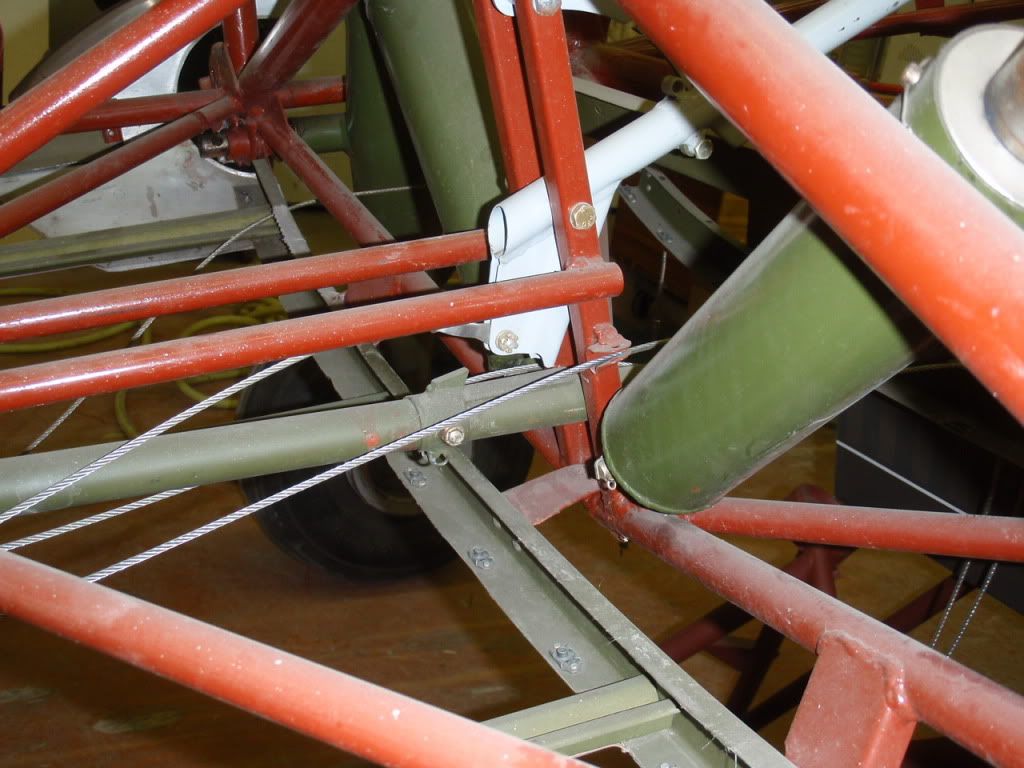

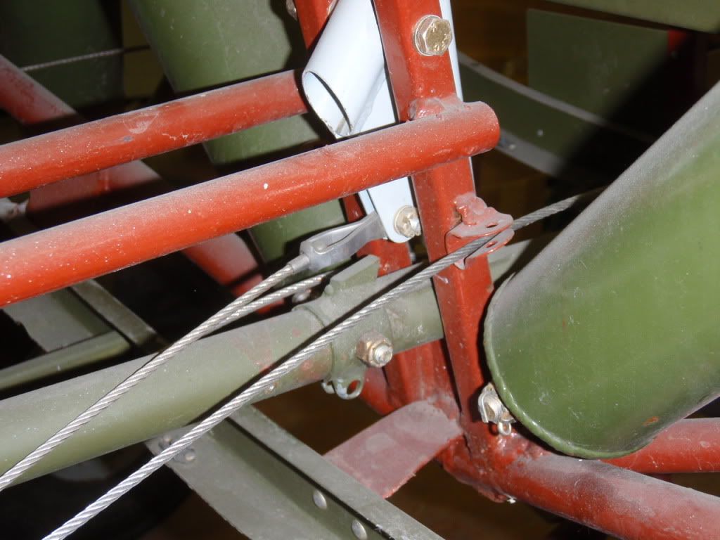

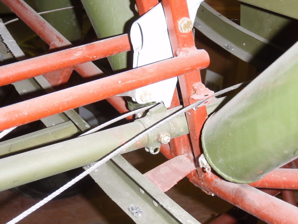

Vick wrote:
hotrod150 wrote: So you're saying that the flaps are linked to the elevator controls, to disable full "up" elevator unless the flaps are deployed? I'm definitely no Stinson authority, but this is definitely the first time I've ever heard that.
Eric
It's actually a very simple interface. The elevator torque runs just below the flap handle. There is a lip on the torque tube. When the flaps are up (flap handle flat on the floor) the lip on the torque tube runs into a limiter on the bottom of the flap mechanism when the yolk is pulled full aft. When the flaps are deployed the limiter rotates out of the way and torque tube travel is uninhibited, allowing for full up elevator deflection.
Every 108 series is that way. If it's not, it's not a legal plane.(I've come across more than one that someone had removed) Elevator travel is specified as such: Elevator (flaps up) 16.5 to 17.5 degrees up, 19.5 to 20.5 degrees down, (flaps down) 25 to 26 degees up, 19.5 to 20.5 degrees down.
Here's a few pics of the really simple "catch" that's built on the bottom of the flap handle, that engages the stop on the elevator push-pull tube.
Flaps up, elevator neutral:
Flaps up, elevator up:
Flaps down, elevator up:
hardtailjohn offline
Posts: 924
Location: Marion, Montana
Re: Stinson STOL modifications?
Excellent photo's showing the elevator-limiting feature! That stop on the elevator tube looks to be a bolt-on/clamp-on arangement- I notice the clamping bolt is gone in the photo. I'll bet someone removed it on my friends 108-3. The airplane's not flying now, but if and when he gets poking around down there in the process of getting it airworthy again we'll have to check it out.
