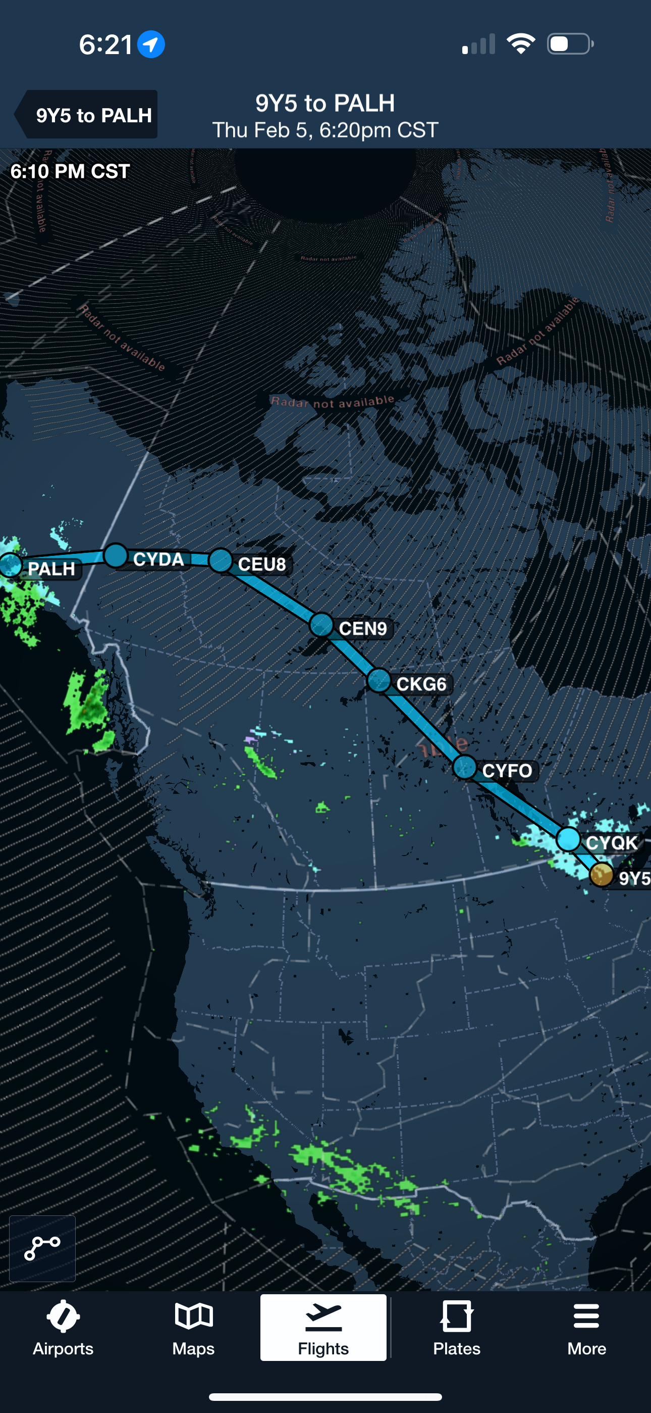

This is one route I came up with, looks like you can get 100ll on the water at all of these with some prior planning, with the exception of possibly Dawson City.

Not sure I’d count on Uranium City (CKG6) but I’m pretty sure Stony Rapids would work. But I seem to recall the guy at UC has a 100LL truck so maybe he’ll bring it to you. Not sure.
If it were me on departing Yellowknife I’d pick Fort Simpson, Watson Lake, and Whitehorse, but that’s just me :)
Always call ahead no matter what the CFS says. Especially if there’s fire activity going on.
