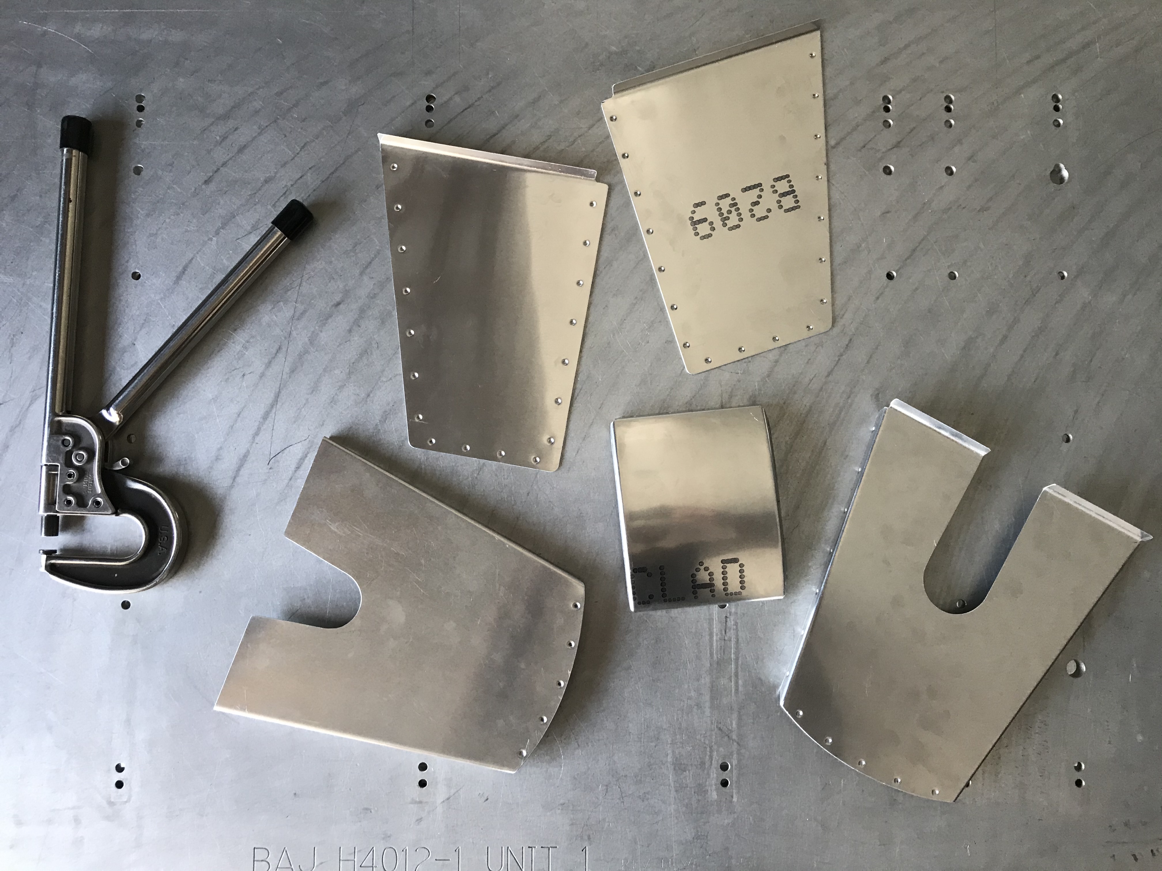

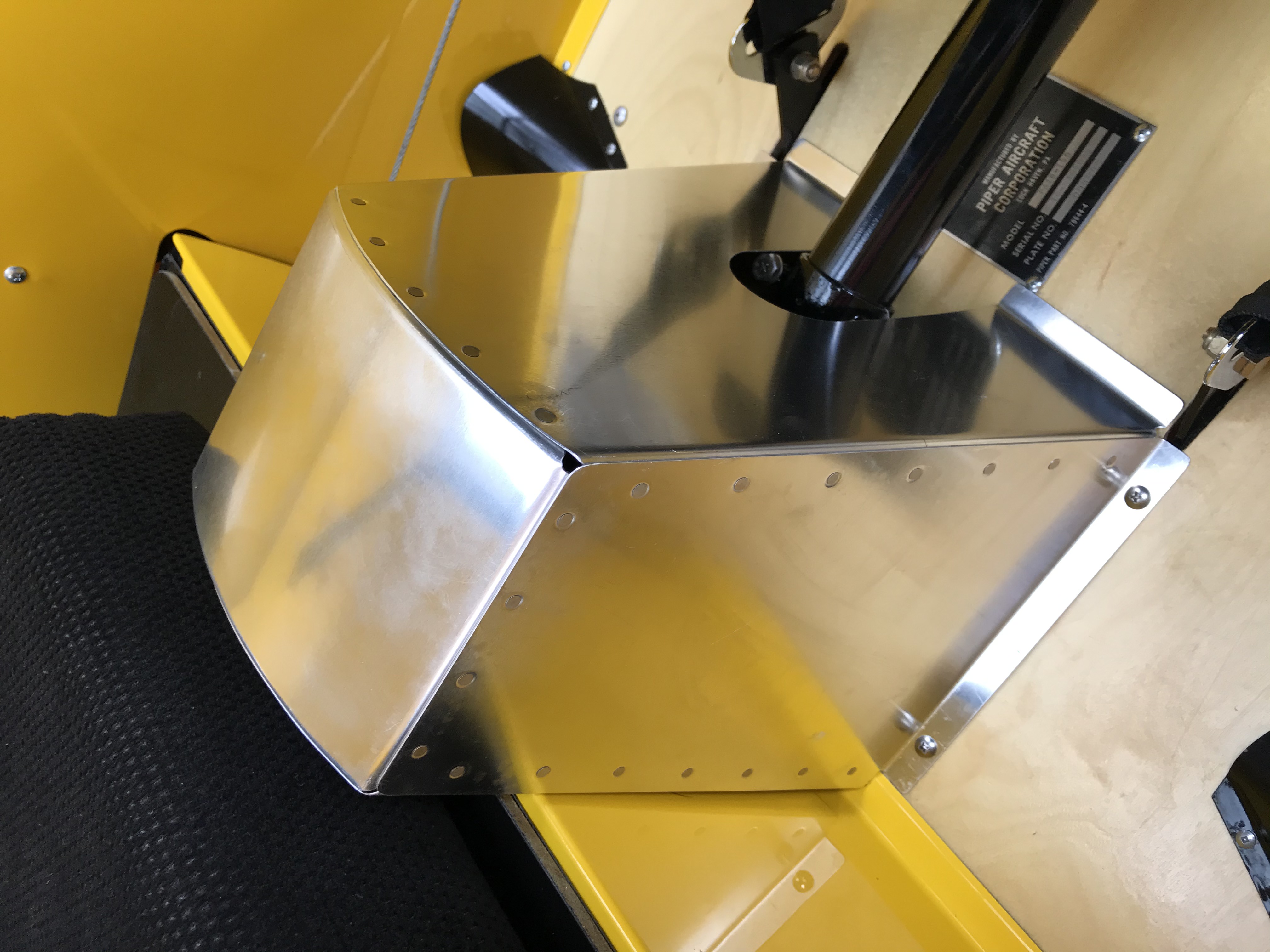

Just finished a rear stick cover for a PA-18 from .032 2024-T3. It has a curved top and three angled sides. I used a small hammer to set rivets in the areas where the squeezer couldn't reach. The project was ridiculously time-consuming but I'm happy with my amateur results. I intended to paint it but think I'll just leave it au naturel.

Wow! Thats nice! Good work.

Very nice! Our old stick covers were somewhat similar, but rectangular, with a flat top that was easily removable with a couple clamps. Pull the top lid, insert stick and rear seat has controls.
As much labor as something like this incurs, price a plastic stick cover from Atlee Dodge......
