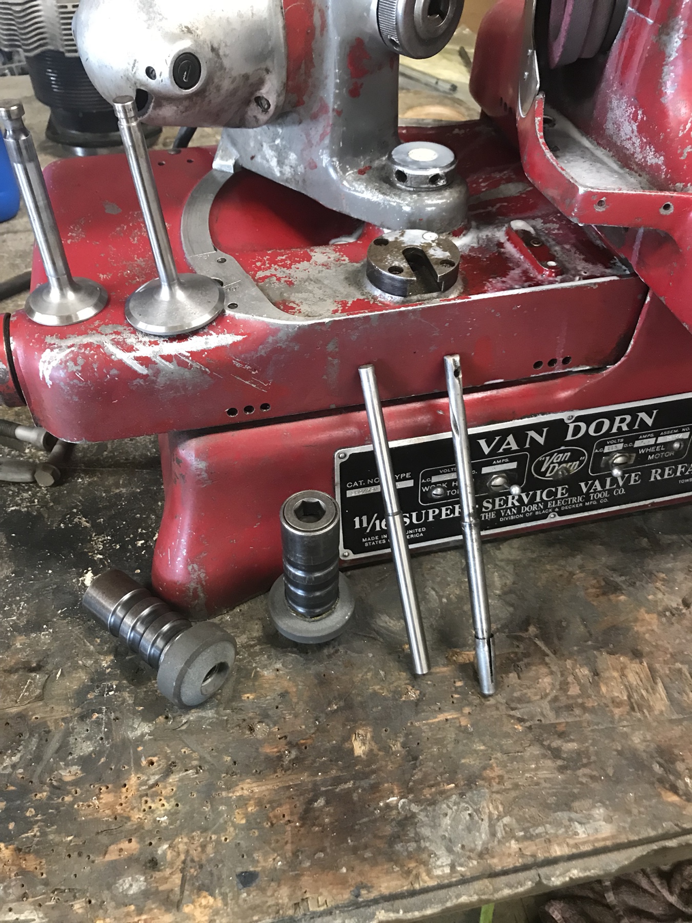

Rebuilding a set of O-320 Millennium cylinders in the middle of nowhere....Platinum Ak. Came to a screeching halt when I discovered I don’t have the correct pilots for the Black and Decker stone tool holder. Pictured are Continental pilots and Goodson is out of stock on the exhaust pilots...posting up here hoping someone in the Anchorage, Palmer Wassilla area has a couple I can rent or buy. Top end of the pilot is 0.375”. Guide size/s are 0.404” and 0.4985”. Adjustable would be best.
