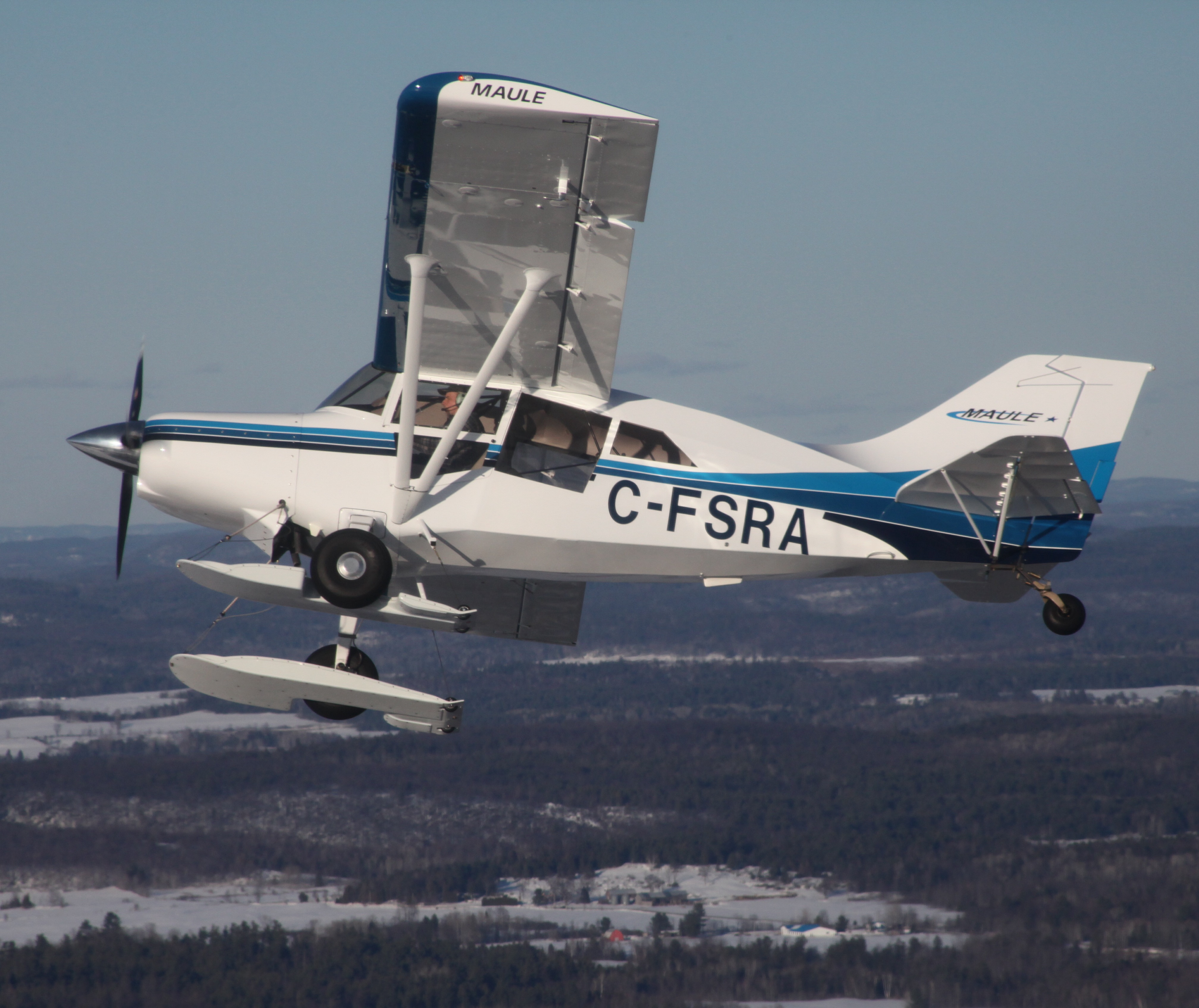

Wondering what you guys are doing for a tail ski for the M7 235C. I made some inquiries today only to find out Trickair is no more. I don't think many companies (if any) have STC'd a tail ski for the M7. I know many guys don't worry about it and even use a modified shovel but was hoping to keep it all legal.

Well I waited too long and missed my chance for a new Burl tail ski to fit the Alaska BBW. Anyone who's not up to speed at this point should know Burl is shut down and their STC is up for sale.
I'm now looking to find any used ones out there for sale. Is there a place on this forum that list items for sale?
I did contact Trickair but they don't have tail skis to fit the Maule tailwheel so I'm SOL there as well.

Re: Tail ski options for Maule M7
Your pic shows a Scott so I don’t realize you had a Maule tailwheel. Not many people going to make one for the old Maule tailwheels.
Buy a used Scott tailwheel and you have lots of options. Personally I wouldn’t worry with an STC
Posts: 1533
Summit Aircraft Skis makes a tail ski for the 3200 Scott / ABI style tailwheel. Info can be found by emailing [email protected] (CubCrafters manufactures the Summit line of skis)
