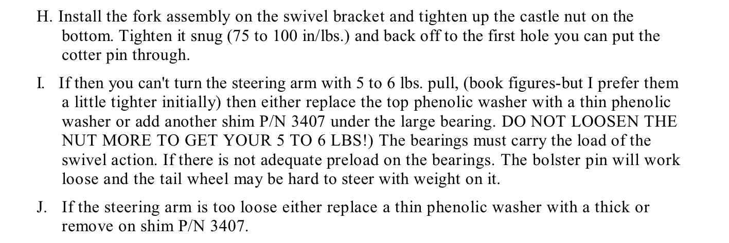

I tighten the fork to head nut by hand, until it wont move and I back off the nut a flat or two, just so the fork/head will turn by hand. Once its on the plane, pump grease into the zerk as you turn the fork back and forth until it starts to come out (either the dust shield or the bottom). This will further tighten things up.
Folks seem to know about the caster angle, so that is good. A bigger tire will decrease that angle. But usually bigger tail wheel goes with bigger mains, so that doesn't matter much. With the BBW, these guys I work with don't really land on pavement, but with the harder tires (404 or garaero) I inflate them to 45-55 psi.
Sounded like the OP could turn right but not left....... there is something not right internal. It's going to be something with the steering arm, the paw, or... likely... the spring that they work.
