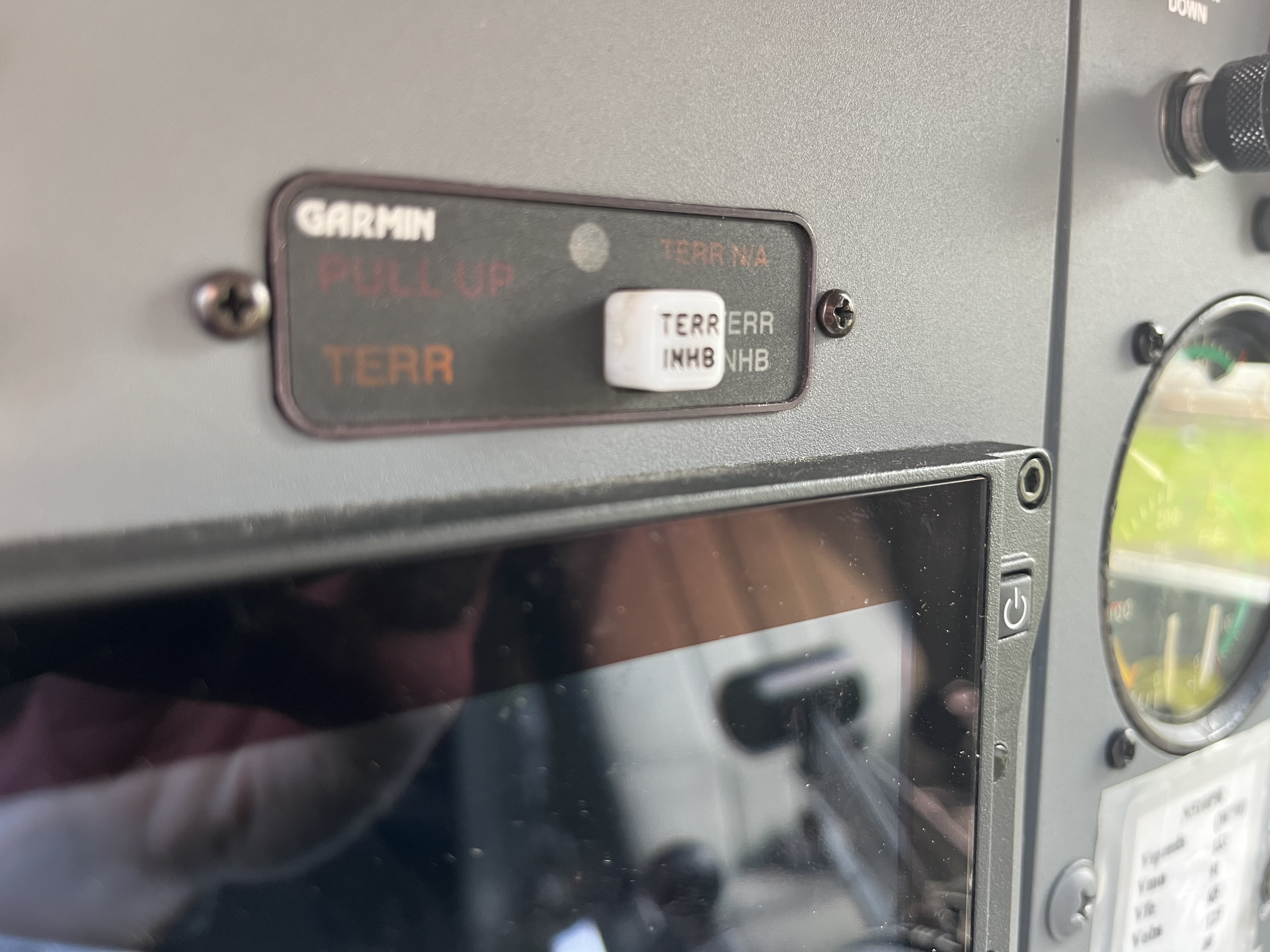

Do you have an external TAWS inhibit switch? It’s key. No more going through menus to inhibit the warnings. I use it 5x/day at work for glacier landings. Never use the terrain system on floats but I imagine same problem.
It doesn’t need to be the garmin brand annunciation panel like this, a simple momentary switch can be wired for the function. Same for traffic warning.
