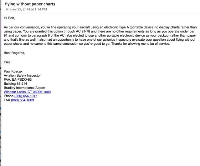

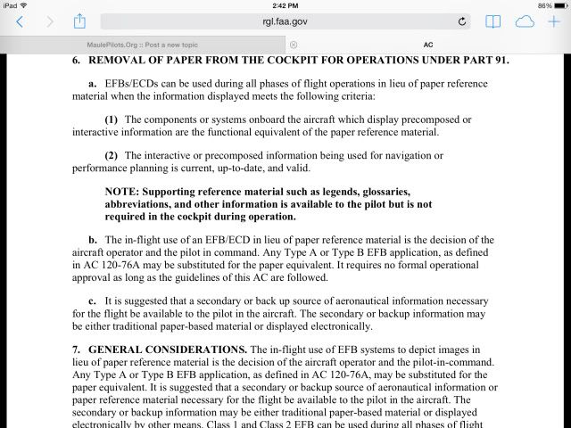

According to FAA Advisory Circular 91-78, it is up to the Pilot in Command as to whether he will utilize an EFB or Paper Charts.
Just to make sure that my interpretation of the regulations were accurate, I put the question to the FAA themselves.
As I fly the Maule in IFR quite often, it is nice to know that a reasonably priced program like ForeFlight is a 100% legal replacement for paper charts and approach plates, and that the very expensive (~$1000/yr) Jeppesen or Garmin subscriptions are not required.

Nice to have that in writing, certainly dispels some of the misinterpretations floating around. Your question aside, also nice to see positive engagement with and responsiveness from an FAA rep.

Good info Rob. Thanks for posting this!
I'm surprised by the friendly tone of the letter......nice to see that kind of response from the FAA.

I too asked this question a while back. I asked if an I Phone running ForeFlight could be used as a backup to an I Pad running ForeFlight. The answer was an unequivocal yes. Nice that one subscription to ForeFlight can be used on two devices, so....
Amazing, actually.

To clarify, and as per the above AC 91-78, this inquiry was only to determine if I could eliminate the Paper Charts & Approach Plates, if I had a Class A portable device (iPad) with a program like ForeFlight installed for IFR flight.
The answer, as stated above, is YES, I am no longer required to carry paper.
AC 91-78 does NOT state that you can use the EFB in lieu of required navigational equipment for IFR flight such as a CDI or WAAS enabled GPS for RNAV Approaches.
Just wanted to make sure it was clear................Rob
