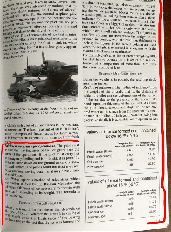

Be cool if someone made a excel program for this

The above article talks about radius of influence... Landed at this ice house because it had atv's around it - turned out it was only 6 inches of ice and water began flooding up through the holes all around the trailer! Loaded up and scooted out of there right after this pic!

NineThreeKilo wrote: Be cool if someone made a excel program for this
Awesome!
https://docs.google.com/spreadsheets/d/ ... sp=sharing
