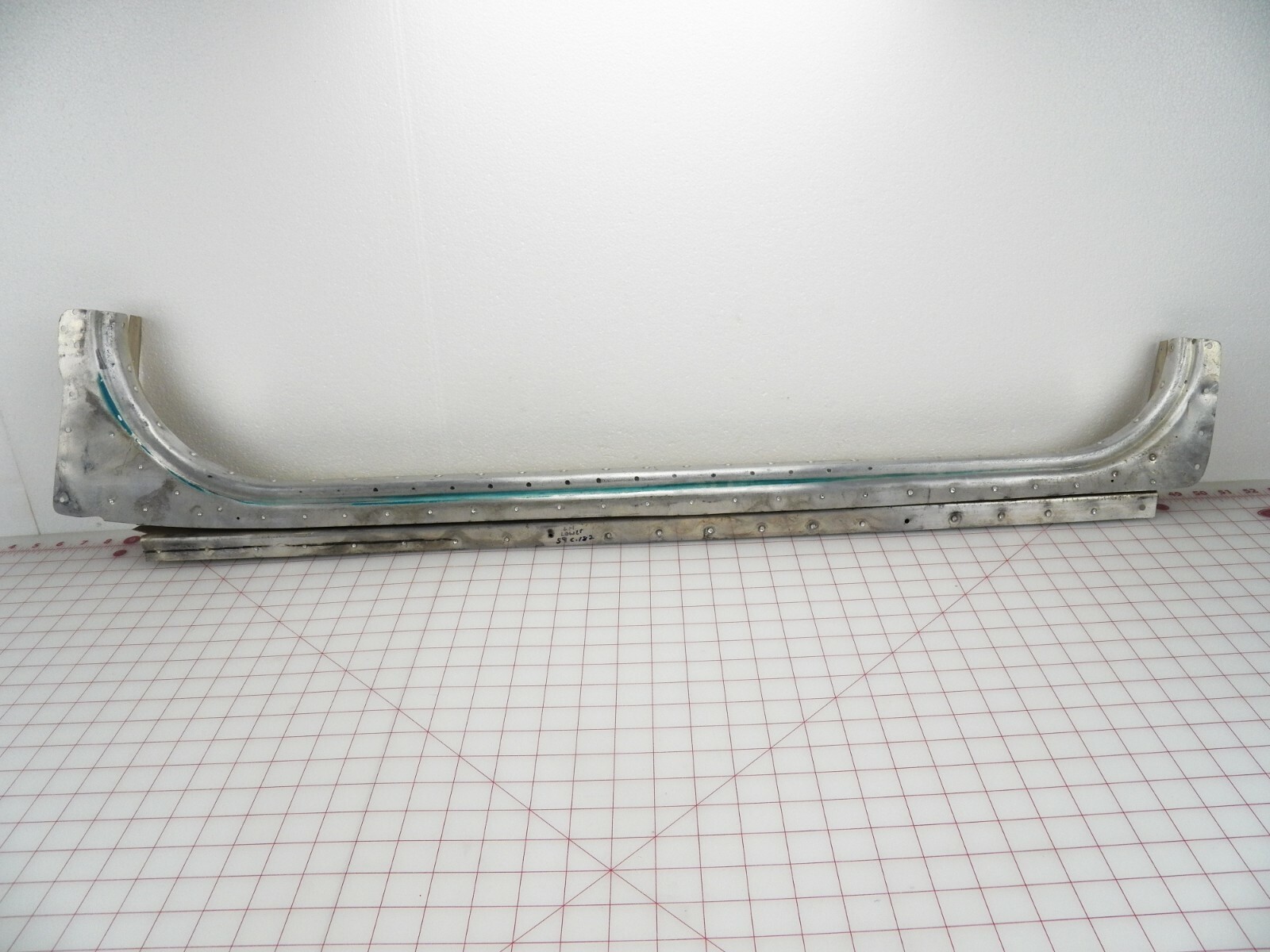

Now I'm looking to get some more cool tools, specifically, what would I need (if this was my airplane) to put this back together without using blind rivets like cherry-max?
I'm specifically looking at this section on our airplane. My starboard side lower door sill is really wonky and it is something that I would like to look into replacing.
