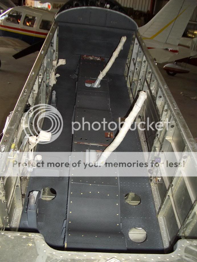

I am in the middle of the long painful process of converting my skywagon's interior over to a "utility" or military cargo style look. I started by completely stripping the old interior. Next is the worst part, removing the sound deadening crap Cessna applied years ago. This takes day and days of dealing with messy chemicals. Next I primed everything with zinc phosphate primer, giving it the military look. I'm at the step of installing a sound proofing/insulating foam kit sold by Selkirk Aviation. This eliminates the issues MTV brought up. Selkirk even sells the foam kit for the extended baggage area which I installed as well. When completed it will look pretty hardcore. Oh yeah, don't forget the awesome cargo netting system from Mountain Wave Avaition. Keeps all your gear in the back where it belongs. I got the idea from Mike Perkins. Here is a picture of his 185 with what I call the "Perkins Mod".
I do have to warn you in advance, this is not a simple project. It is very time consuming. I'll PM you a link to Mike's website so you can see the full process.

I've seen a 185 painted with zolatone inside. It actually looked really good, I though. I've been temped to do the same. One consideration in removing interior is that the fuselage will now "sweat", so get ready for some drips, especially if you keep it outside.
Noisy? Cold? Most of the Cessna's (save for the 206 I have now) I've ever owned are anyway. Headsets and proper attire usually take care of that.
That insulation BW has in his pictures looks good, but it still gets moisture behind it if you live in rain country. Condensation, I guess. Good news is that it doesn't soak. I would not recommend gluing anything to the metal. No way to inspect for corrosion without ripping it off. I've seen the results of this first hand...not pretty.

Here's a photo of my Interavia E3 interior after I shot the zolatone during its "Westernization". I was able to remove 90 pounds of unnecessary equipment and furnishings during the process. The side panels were not yet installed. This is what I had in mind for the interior of our Cessna.
