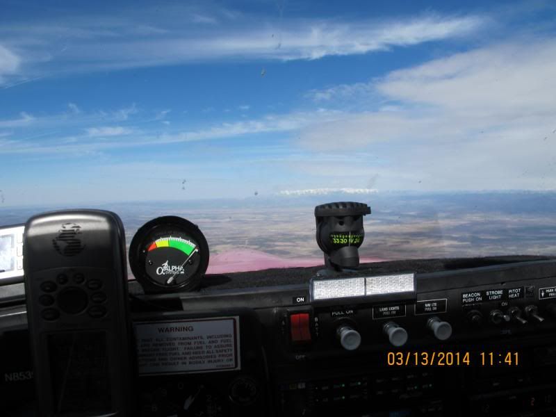

I got tired of maintaining my OEM Airpath in my P172D. It was requiring a swinging every few months, it was leaking, and finally I said screw it, I want a new one. There was a thread right here on BCP about compasses, which led me to getting a new SIRS compass from Spruce. Looks a little funny, but once swung, it hasn't wavered a bit--still accurate after a year. It's much easier to read, too, both day and night.
