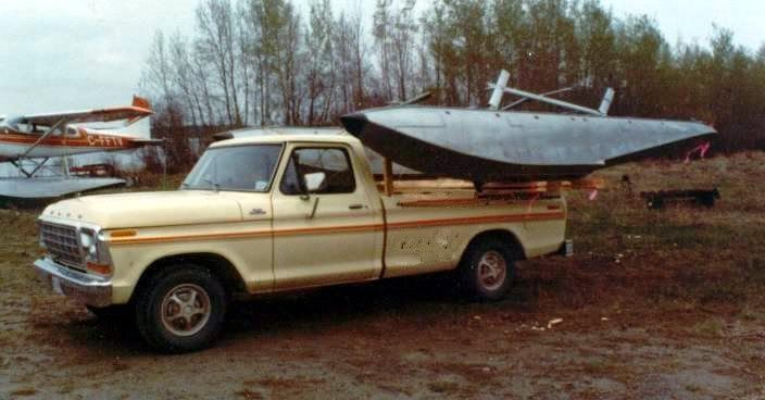

Heres how I moved a set of CAP 3000's from Sudbury to Sault Ste. Marie years ago. I just layed some 2x6s across the box, set the floats on them and strapped them down. Red flags on the rudders. It went well, but it was hard to open the driver's door wide enough to get into the cab.
