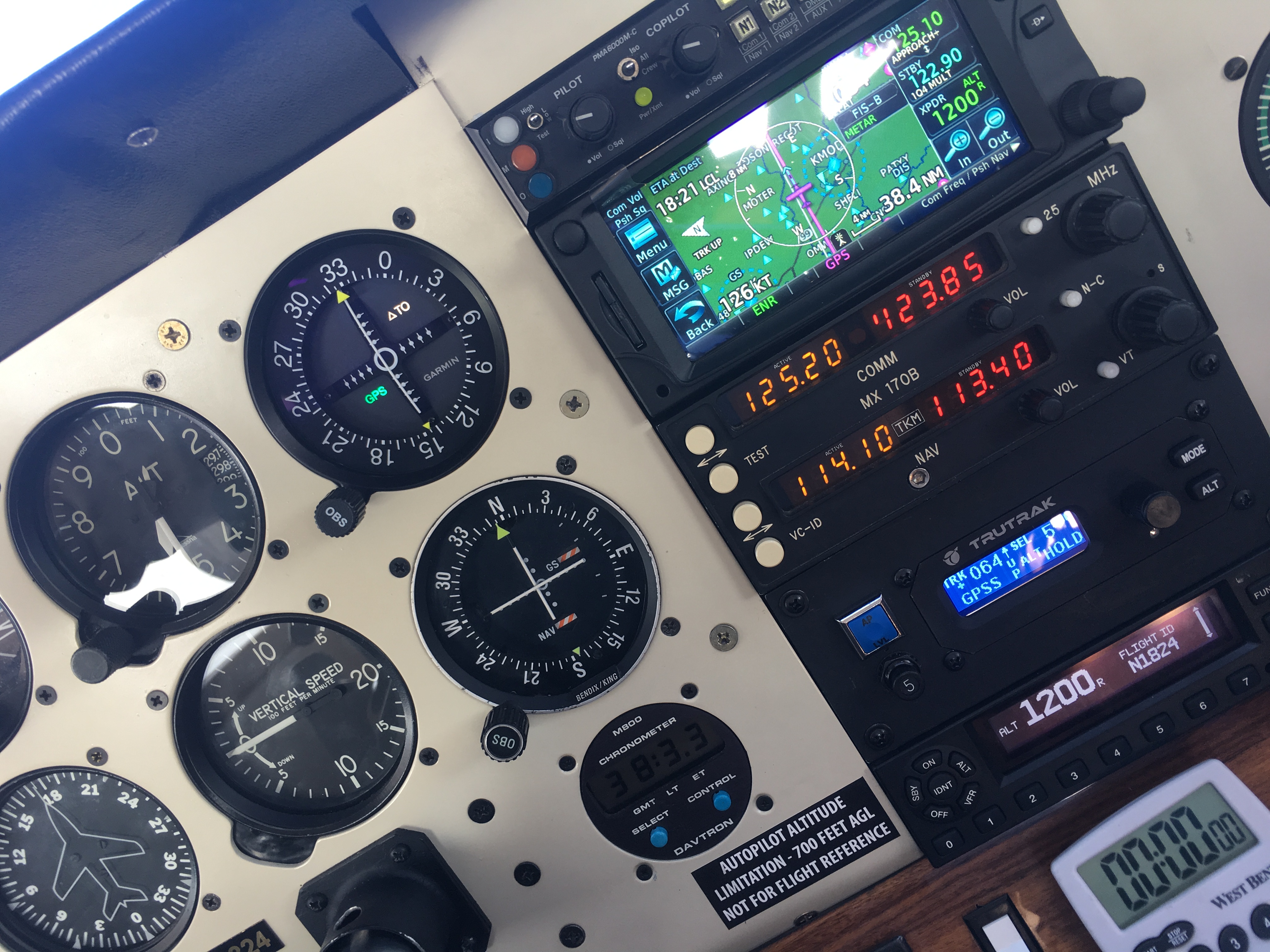

I'm finishing up a trutrack install right now. Also installing 2 G5's and integrating with a Garmin 650.
I can answer questions if you have any.
