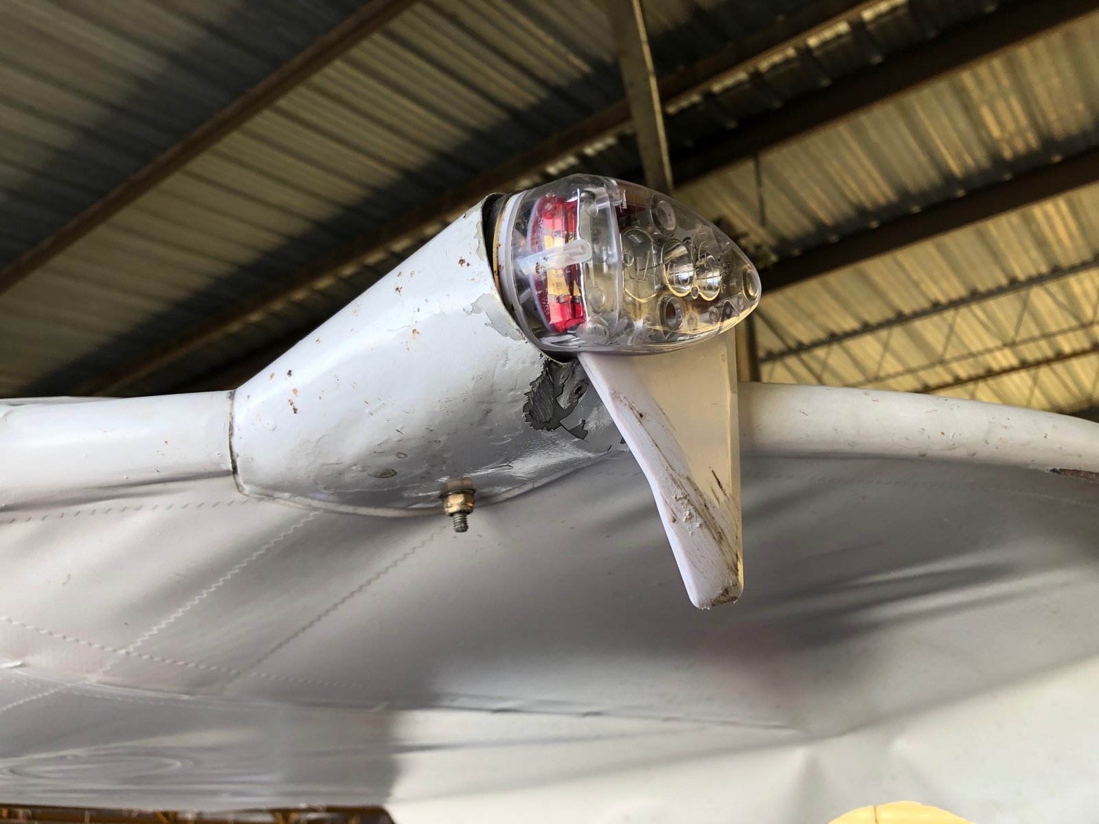

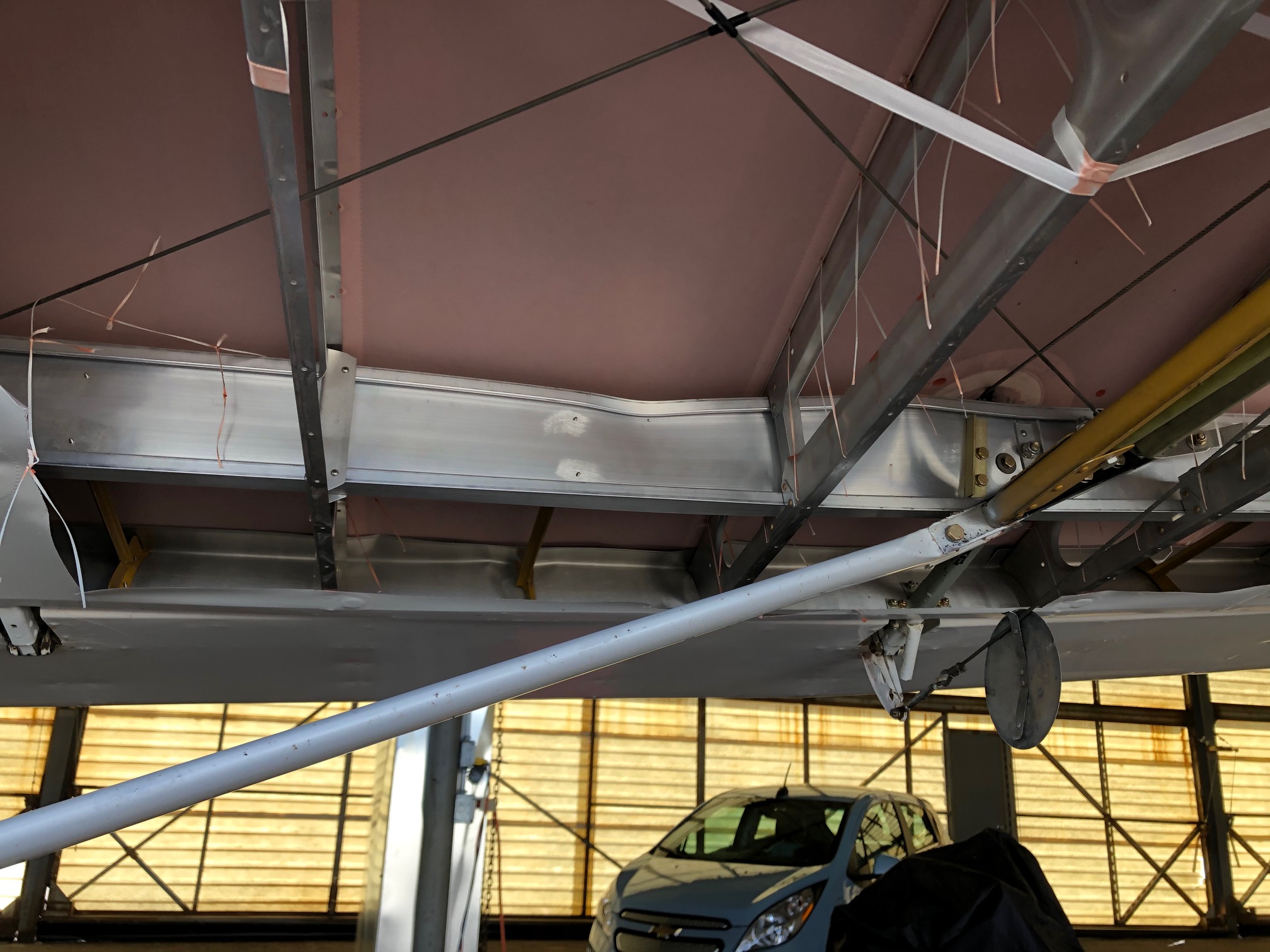

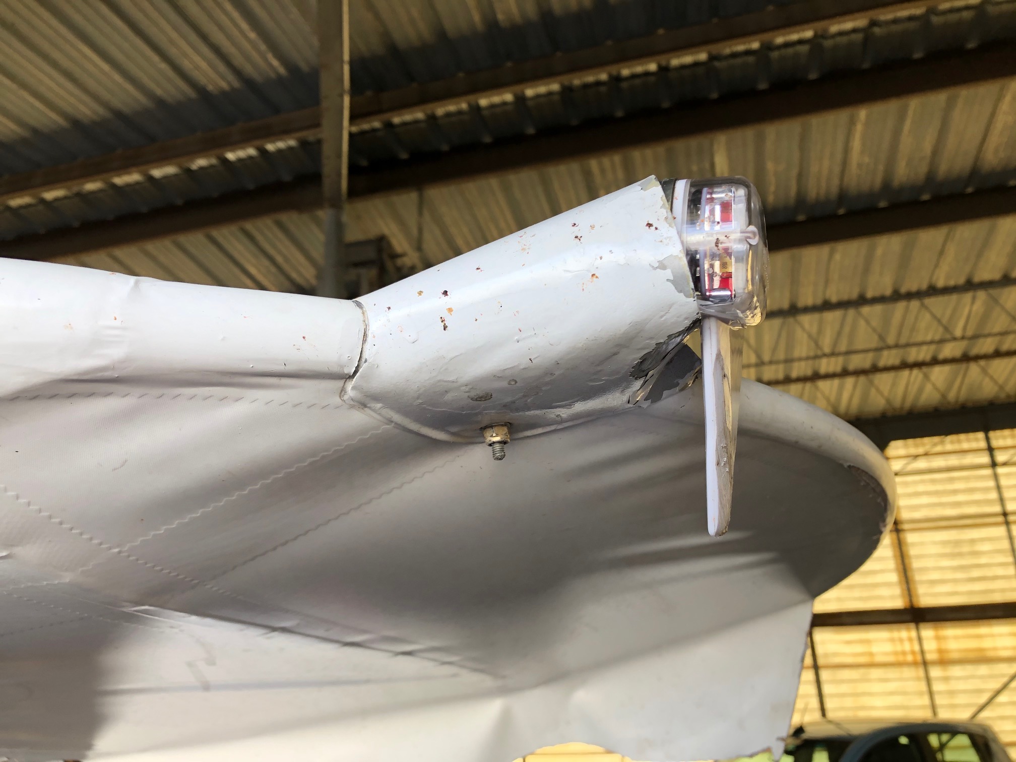

asa wrote:However the antenna on the skybeacon did not bend or break, just had abrasion.
Maybe they should build them to absorb some energy and not bend spars... :twisted:
