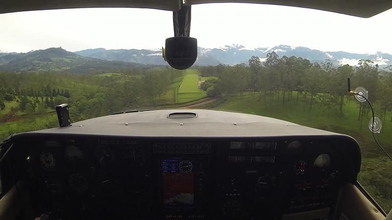

Today I went to a grass strip, 1500ft.
The first 1000ft had a difference of 40ft, between the beginning and the 1000ft mark, after that the las 200 ft were flat.
Did 3 landings the first one I felt the ground came to me very quickly, landed fine but have to flare it full elevator aft, or else would have been a hard landing.
The other landings better with a bit of power at the flare.
What are the recommended technique for this kind of runways?

Thanks for the info.
Here is landing 3.
