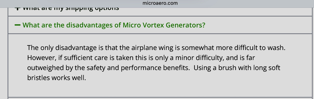

Well if the VG aint there anymore it ain’t there anymore lol
I’ve been flying for half the time as you, big and small planes with VGs, IMO I like them in the air but I don’t like them in the hangar, if that makes sense
from a VG manufacturer
Cleaning
they include extras for when one ends up coming off (for whatever reason)
Apparently they REQUIRE you to keep the replacement kit and glue with the aircraft at all times
Been debating adding them to my skywagon
