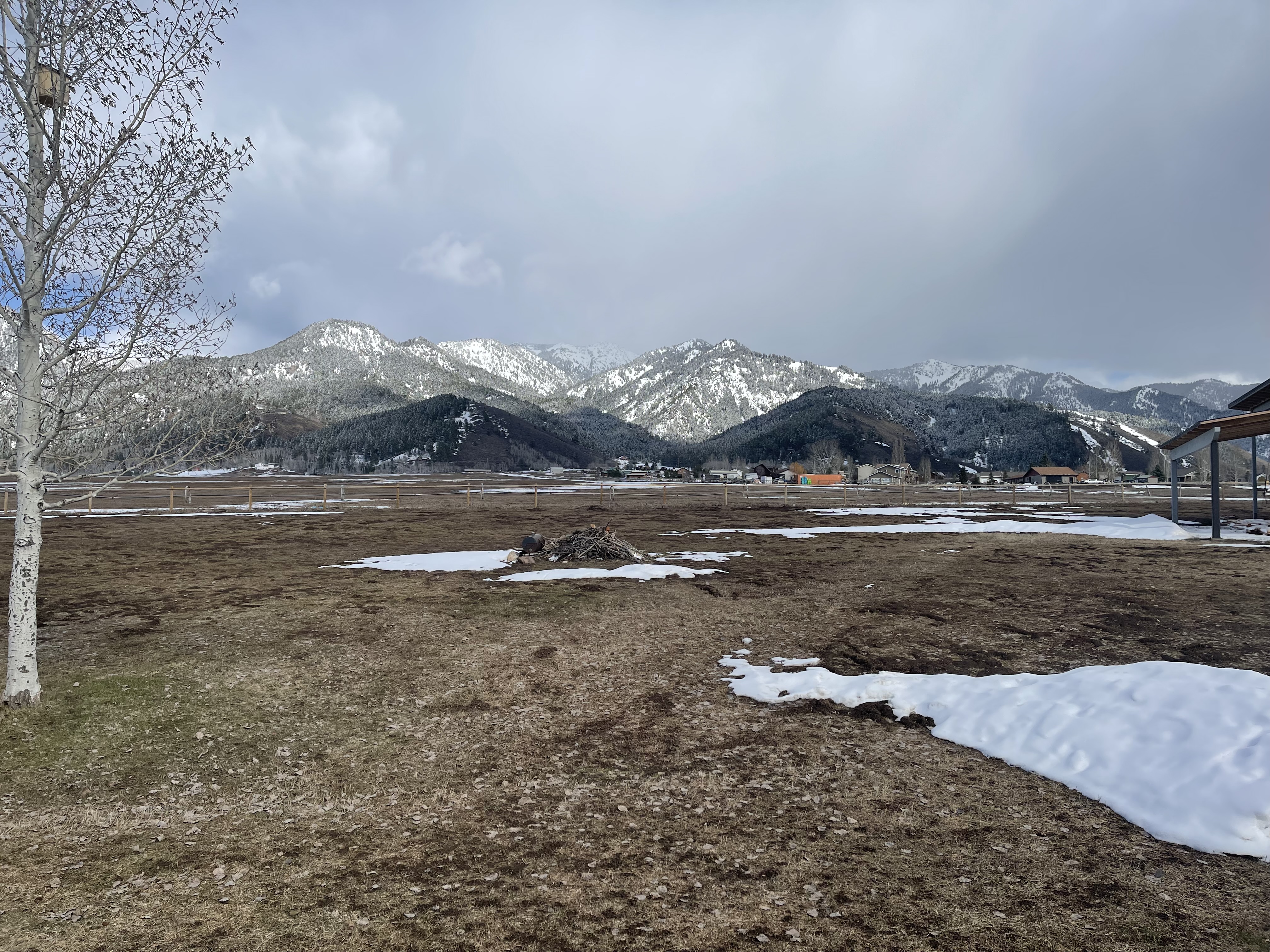

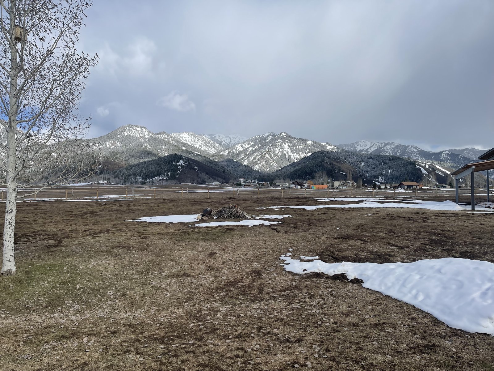

Before

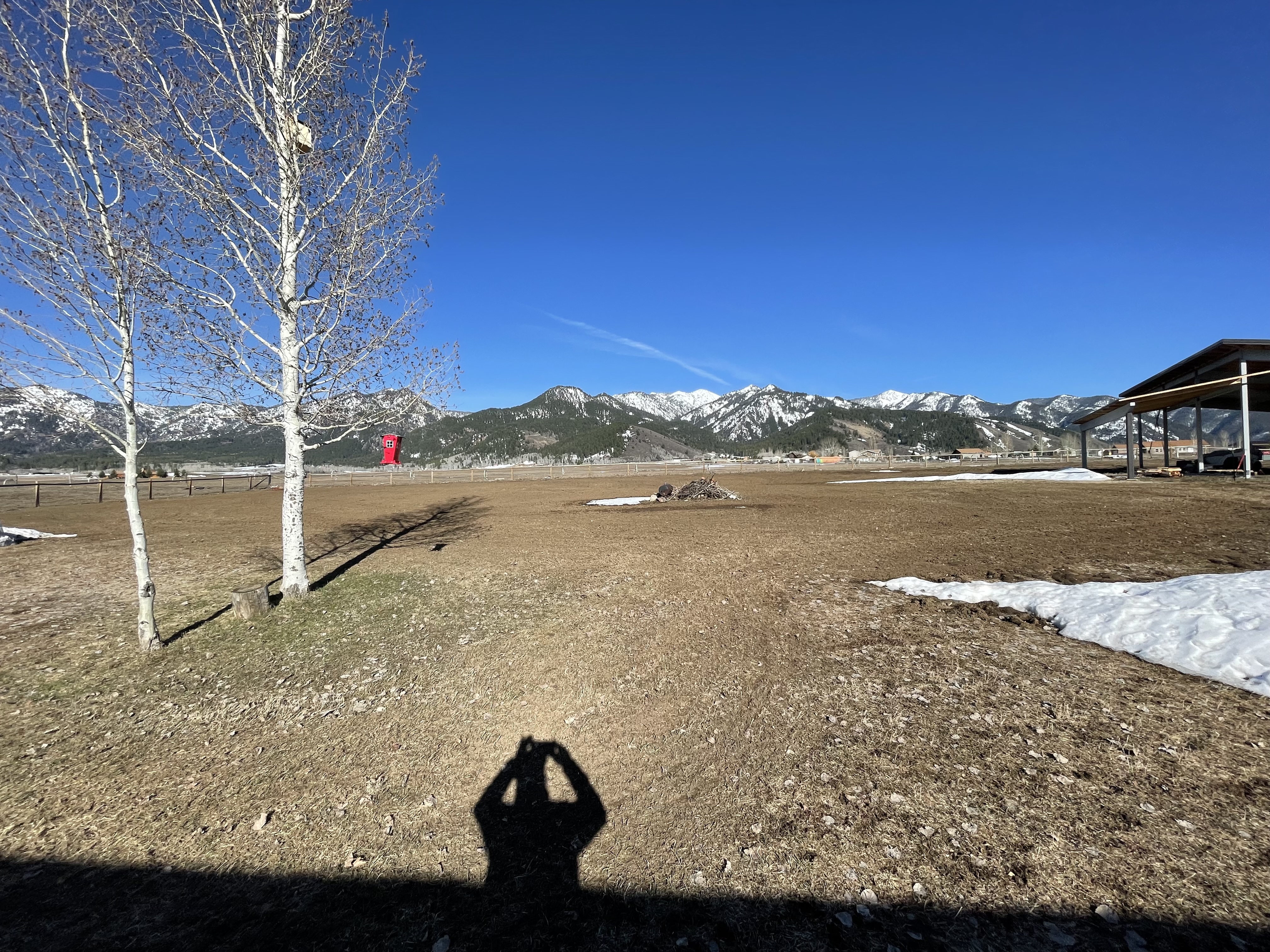

Re: What grass to plant on runway?
After. Filled well.

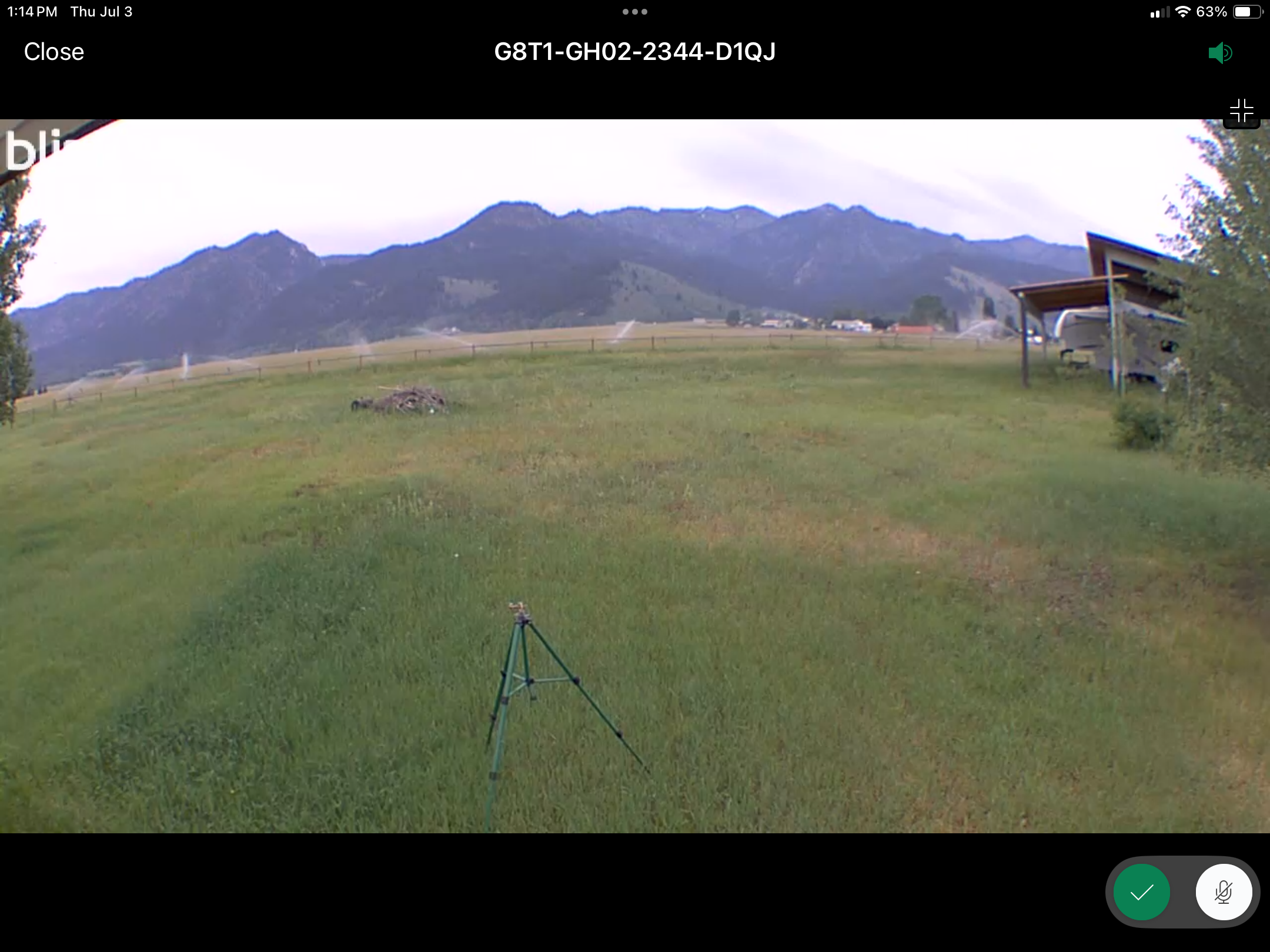

Needs a mow.
