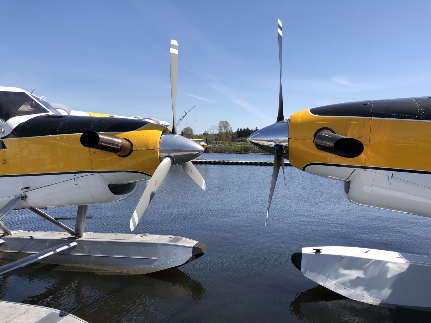

Here’s a fun photo-
On the left is a turbo-beaver on wipline model 6100 straight floats, on the right is an identical turbo-beaver on aerocet 5850 straight floats, the difference in buoyancy is pretty apparent. The additional prop clearance is a big bonus for a floatplane.
