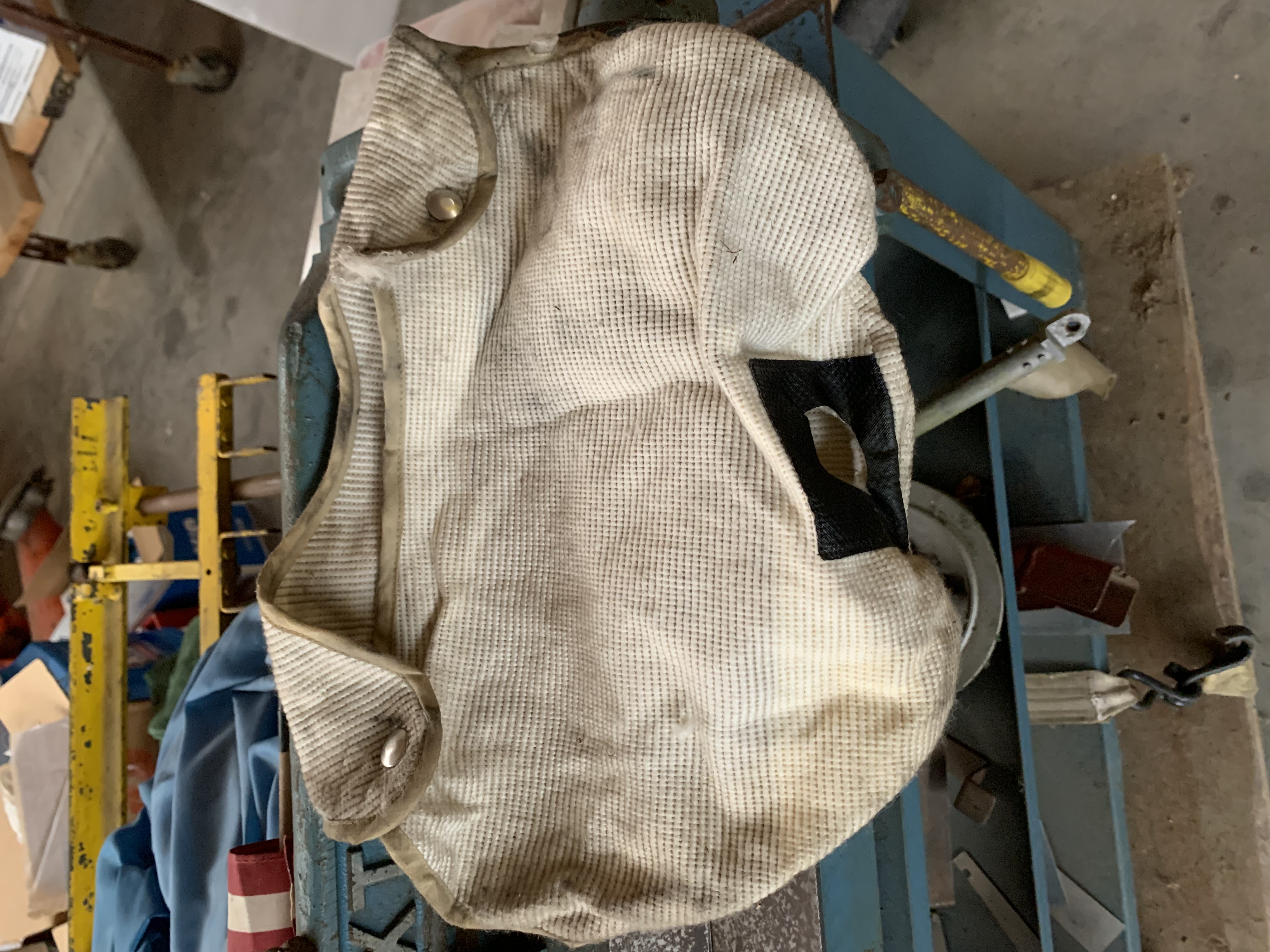

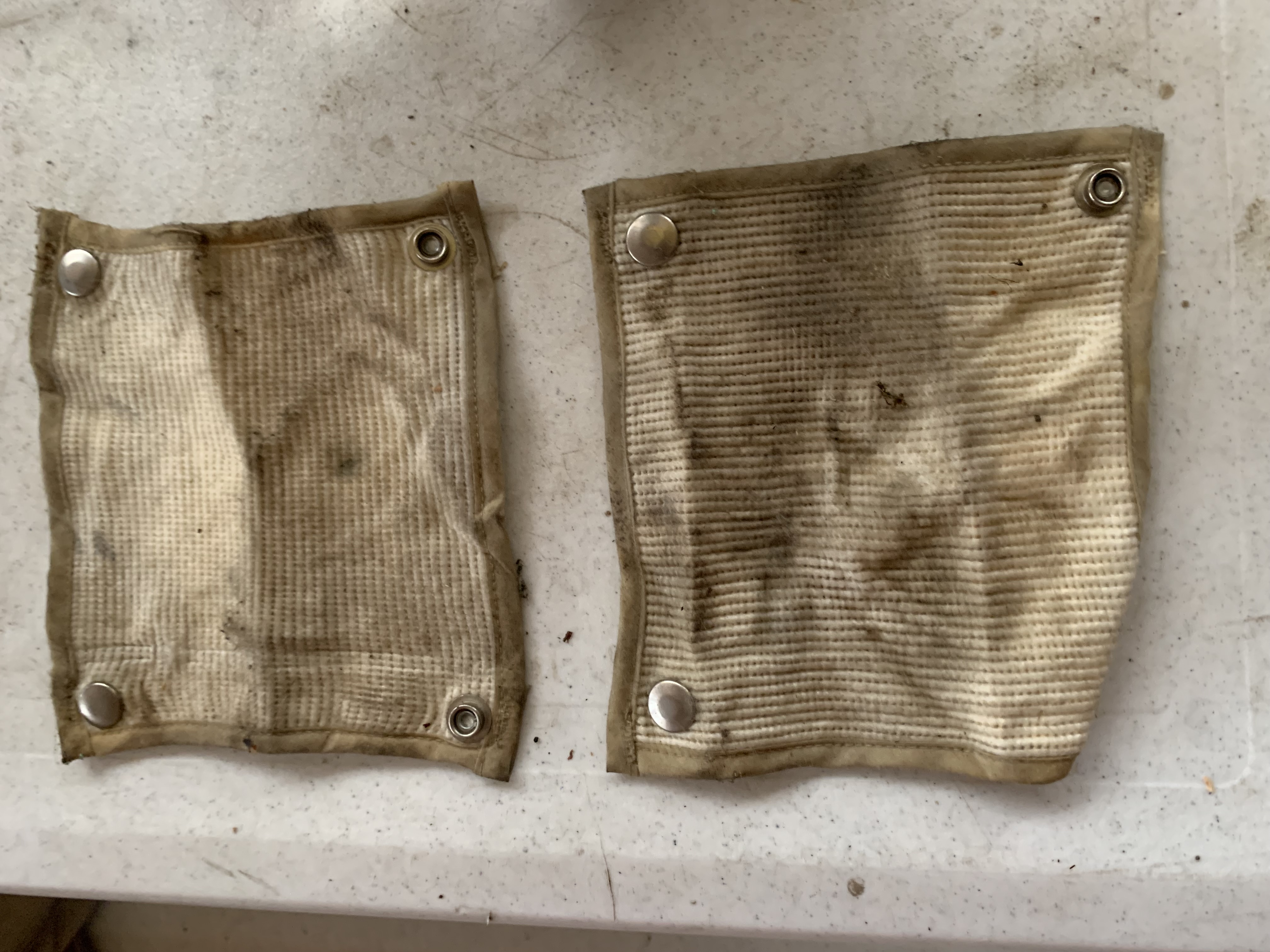

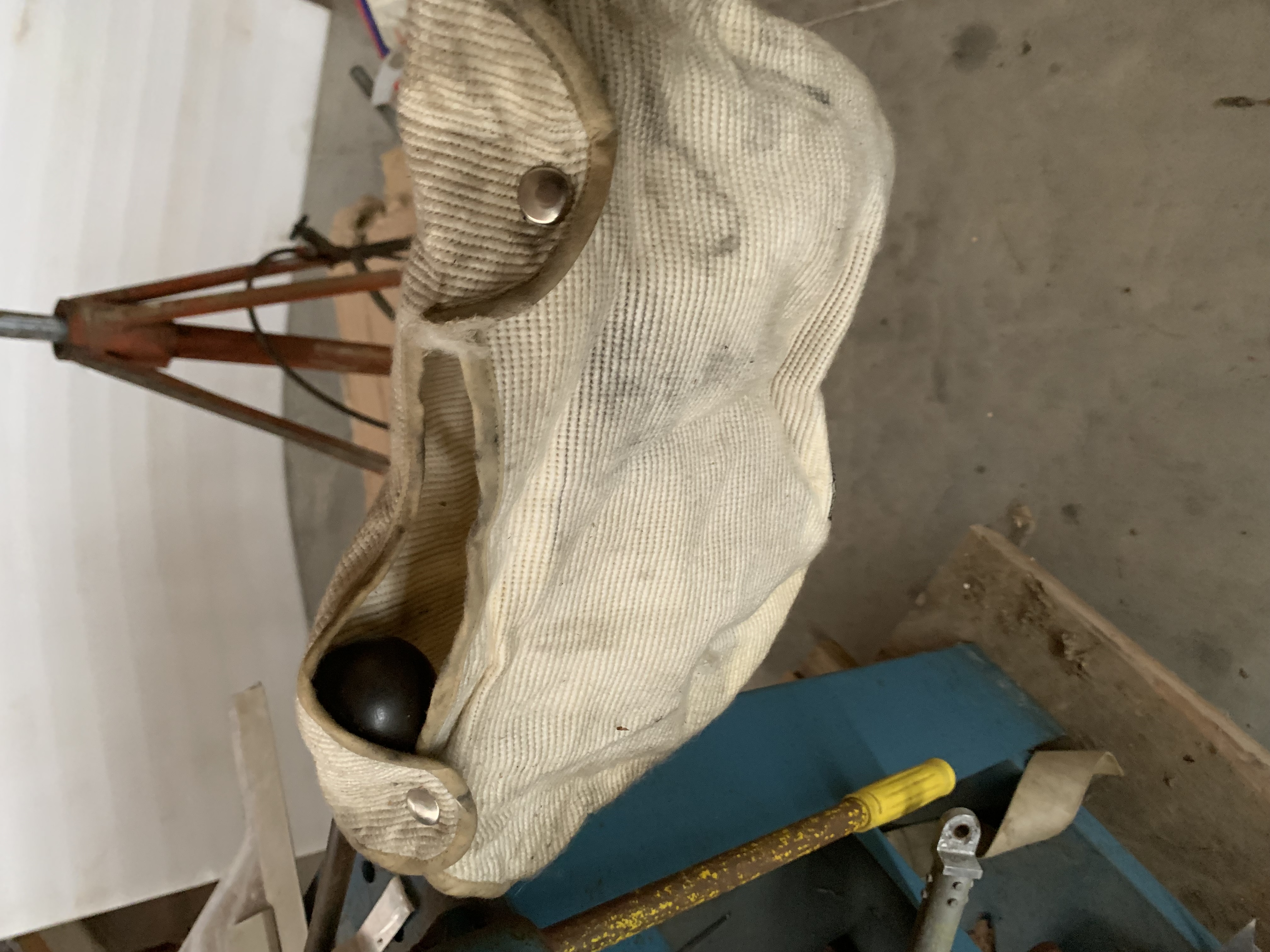

As promised, took some digging to find it. The small squares wrap the induction tubes.
TR

Re: When to baffle
TR wrote:As promised, took some digging to find it. The small squares wrap the induction tubes.
TR
I bought a set from WAG AERO a few years back. Wag has been bought now, so if you can find out who's liquidating their stuff......
It also would not be rocket science to roll your own.

Re: When to baffle
TR
Thanks TR, would you happen to be interested in selling?
I’d be game to get measurements made and provide a free doc for a home brew for others

Re: When to baffle
TR
I want nothing for it, I'll give it to you with the hope you do the same for someone else when you no longer need it. Making a pattern as you suggested is a great idea, how about provide the data to Zane for the BCP database.
Shoot me a DM with your address and I'll drop it in the mail.
