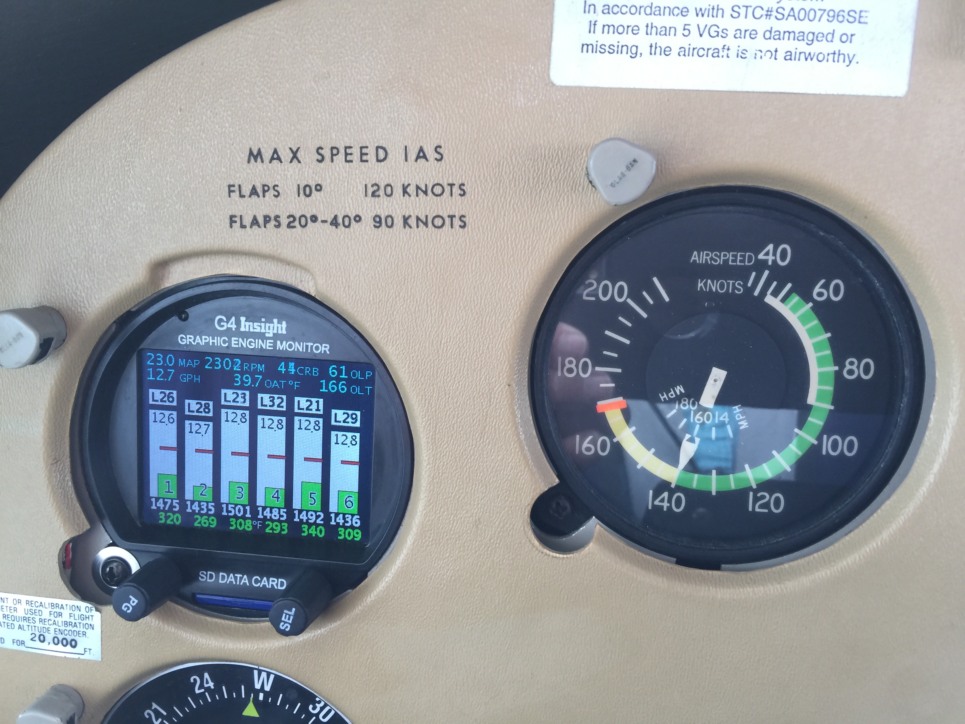

I gained a solid 3kts airspeed with the addition of the Sportsman Stol kit on my PPonk1976 180. The installation consisted of removing the already there Micro VG,s. Install the Sportsman cuff and reinstalling the VG,s. I did not fly the airplane with just the Sportsman.
Bob
