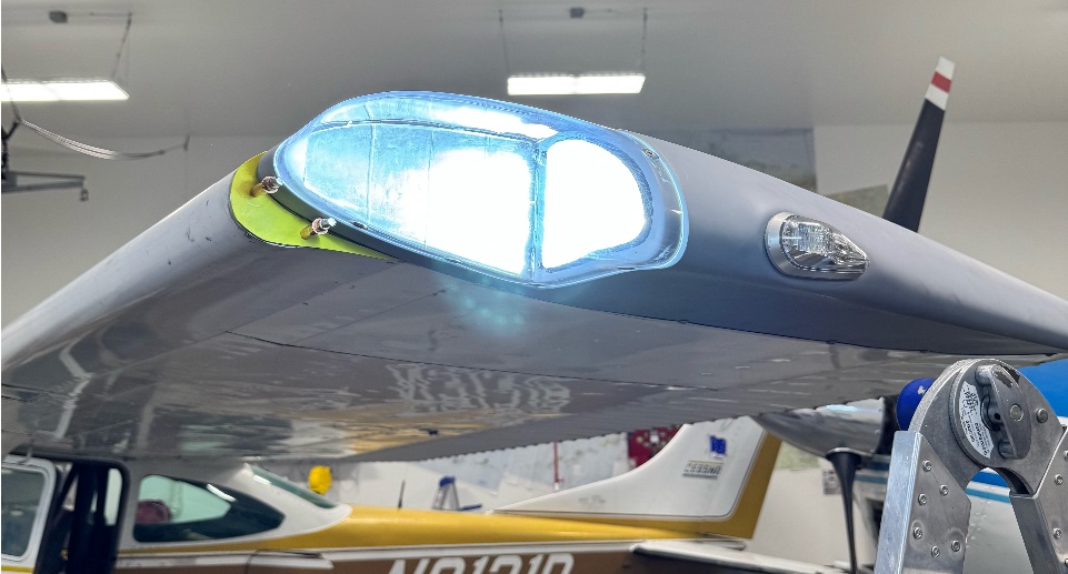

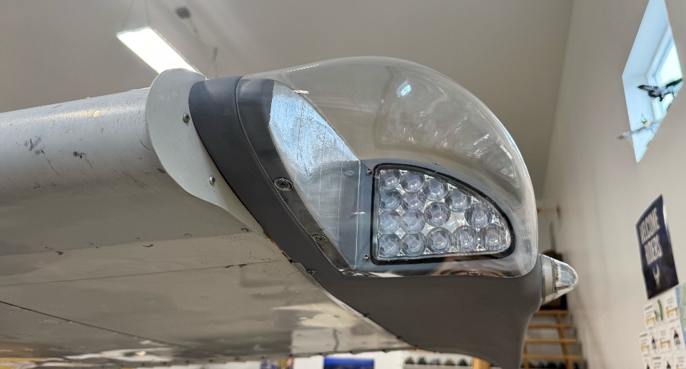

I went with the Quasar on my ‘68 182. I like the look of the LED array vs the single lamp on on the K2U. Bonus with these is the steady Taxi position (lighting up a diffused smaller portion of the array), Landing position (entire array full brightness), and Pulse.
Installation was very straightforward. Stene supplies the switches, circuit breaker, wiring and connectors. The most complicated part for me was modifying my Horton cuff to fit the standard cuff tips (the tips aren’t available for the Horton STOL cuff).
Wingtip 1.jpg (129.91 KiB) Viewed 1313 times
Wingtip 2.jpg (147.66 KiB) Viewed 1313 times
