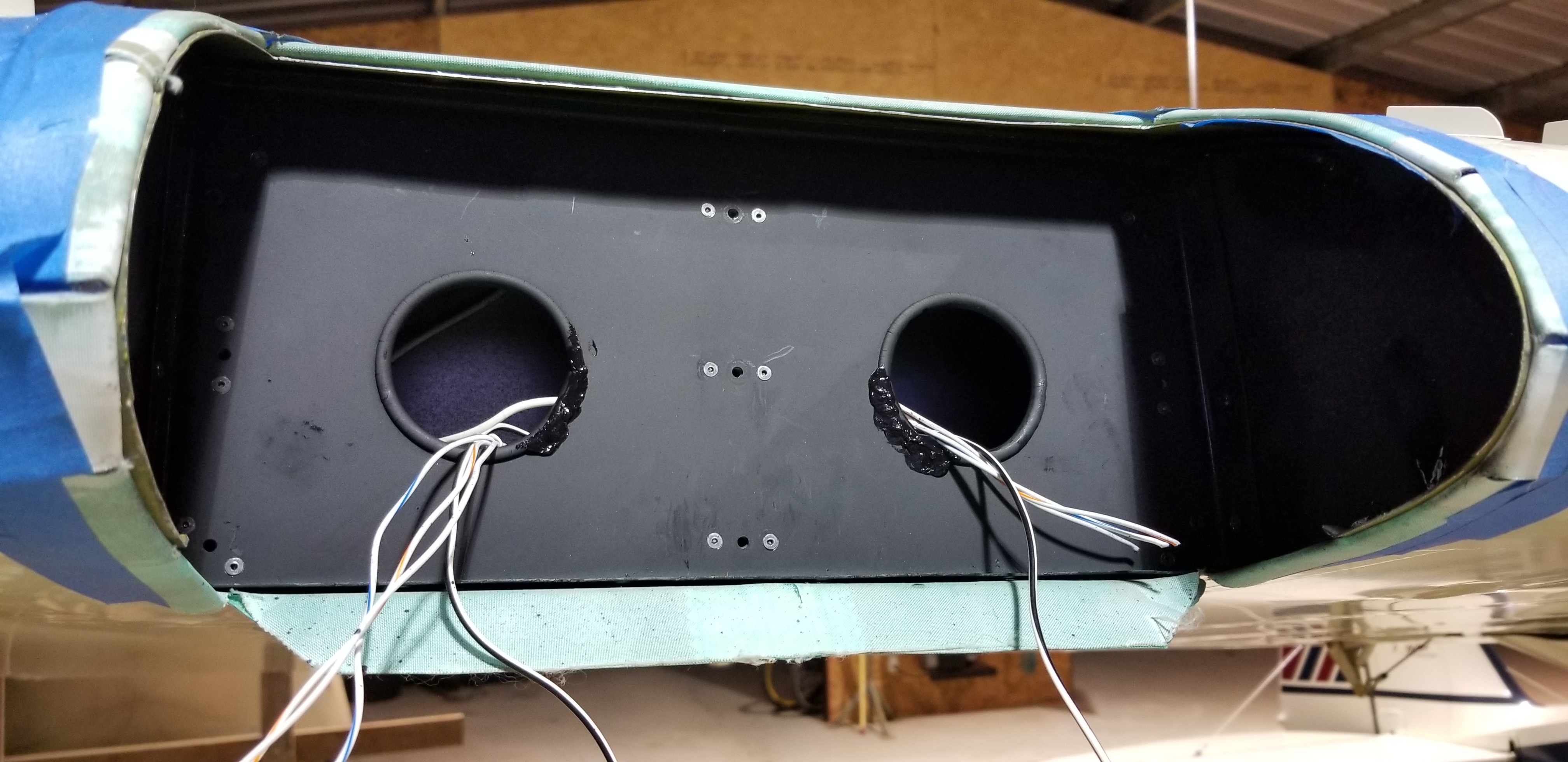

Pacer right landing light
Zane, it's not too bad of a job to add a right side light. The built-in wig-wag is awesome!!
