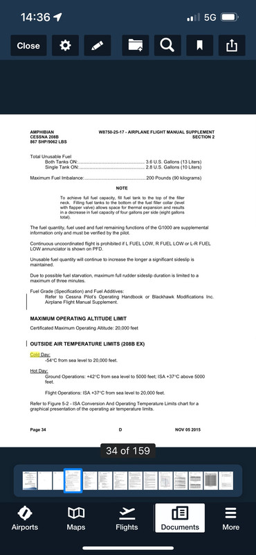

I got nothing in the manual for my plane, however going into the AFM for the 208 amphib (wip 8750s) there’s this
Id say make sure to avoid ice like crazy, so no known icing conditions, including flying in lower visibility
Also make sure you read the cold weather ops supplement for your engine, both cont and lyc have them online
