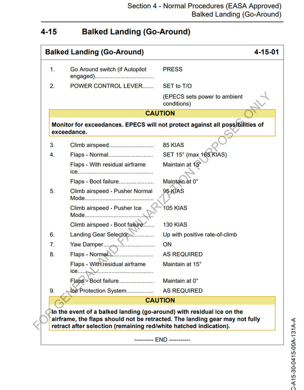

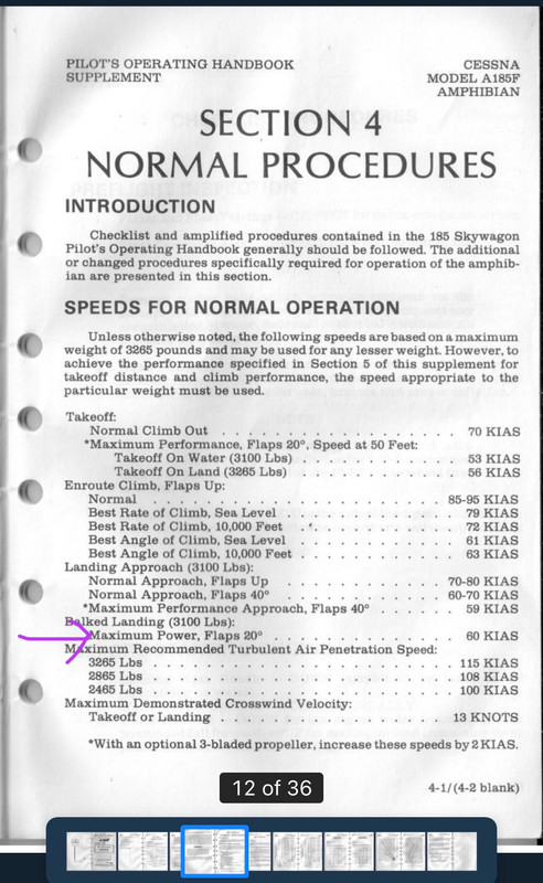

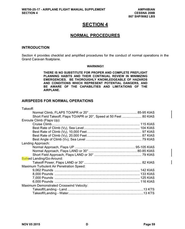

On the go around I’d not want to calculate how much power is needed
185 amphib
208 amphib
L16
PC12
Even on big planes you hit the toga button, on some you can hit it twice for max power vs once for derate, but that’s computer set, and with auto throttles.
I’d just follow the book on a normal go around, maybe a less than full power would still clear the tree, but flying per the POH will clear the tree even more, and more is more better.
It is also 100% defendable should god forbid something happen, if goes sideways on the go around and the NTSV -> FAA finds you didn’t use full power (be it via analyzer data or just video etc) your going to get cooked like a thanksgiving day turkey

Though my 185 normally lives in the amphib configuration, I always just trim the pressure off the controls, same as with anything else
On a go around with full flaps that’s a ton of drag, I figure it needs all available power for the delay, as I only have 2 arms, between adding throttle and getting to flaps 20.
That old adage of we train how we want to preform and we will perform how we train
half power or the like with full flaps on a go around over a long runway or lake probably isn’t a issue, but Murphy's law the one time you need to get some distance between you and a plane that wrongly started its takeoff roll under you, or you get wind shear, etc you’re going to not want to end up with a pitch up attitude with full flaps and anything less than full power IMHO
Shy of large cross winds, or shooting a IAP into large runways, I’m full flaps to land, trim the pressure off

Oddly doing go around in the 208 amphibs I preferred to just make a big sweep on that nice big manual trim wheel, the wheel on the 185 does seem small and stiff in comparison
