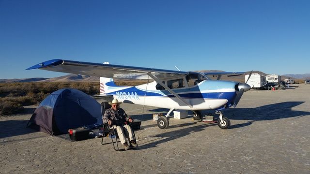

A tougher fork is not going to help. The week link is the firewall. I have a 310 fork with a 600x6. 700's on the mains. It is all I need for what I do. Here is my static display at High Sierra Fly-in. Me not the plane.

qmdv wrote:A tougher fork is not going to help. The week link is the firewall. I have a 310 fork with a 600x6. 700's on the mains. It is all I need for what I do. Here is my static display at High Sierra Fly-in. Me not the plane.
Looks like that was directed to me... I didn't claim it would.. just stating the facts about his setup, and what I saw it handle. Does the HD/tougher whatever it is called fork allow a larger tire, because a larger tire can make a real difference.
