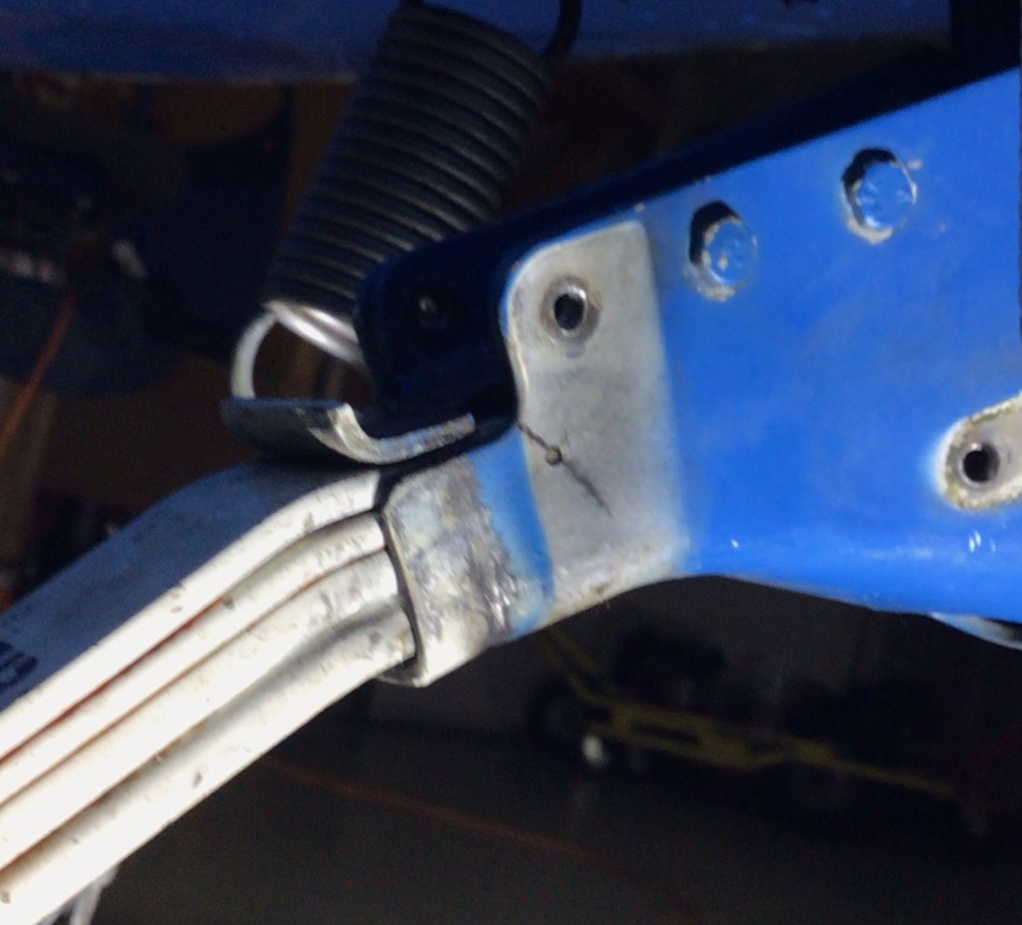

Found this on my plane, not sure if I created it (tailwheel shimmy, big rocks) or was like this when I bought the plane.
Is the something that can be repaired?

Well it looks like it at least started before you, looks like someone tried to fix it with stop drilling that crack. That is not a location I would be ok with stop drilling the crack and calling it a day.

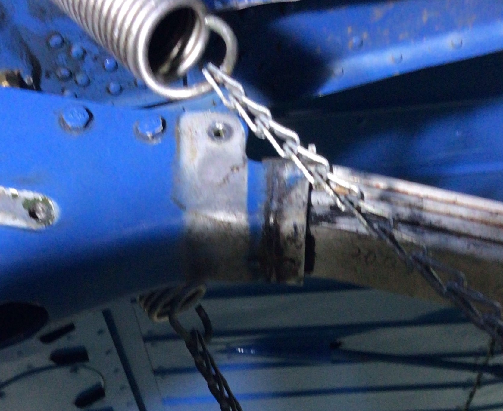

Am I also seeing signs of a previous weld repair further along ?
Given the nature of the "fix", stop drilling and what looks like an earlier repair I'd say it time to do the job right once and for all.
Re: Cessna 170B tailwheel damage.
That rear bracket needs to be replaced. If it were mine and knowing the places you land that plane, I'd be looking hard at getting the T3 bracket and TW assembly field approved for install.

Replace the part. Getting a taller tailwheel/tail spring will increase the chance of a tail first landing and hurt takeoff AOA. Avoid tail first or three point landings, Learn to do tail low wheel landings. Much better for the airframe and control. DENNY

When you replace the bracket look into an L19 bracket. It is a little beefier than the "fishmouth" bracket that you have. It has a slightly different clamping method at the back of the bracket as well. I think where that crack is you need to change it out.

I got a nickel saying you look at the aft bulkhead there’s cracks in it. Tail is definitely the weak link on the 170.
