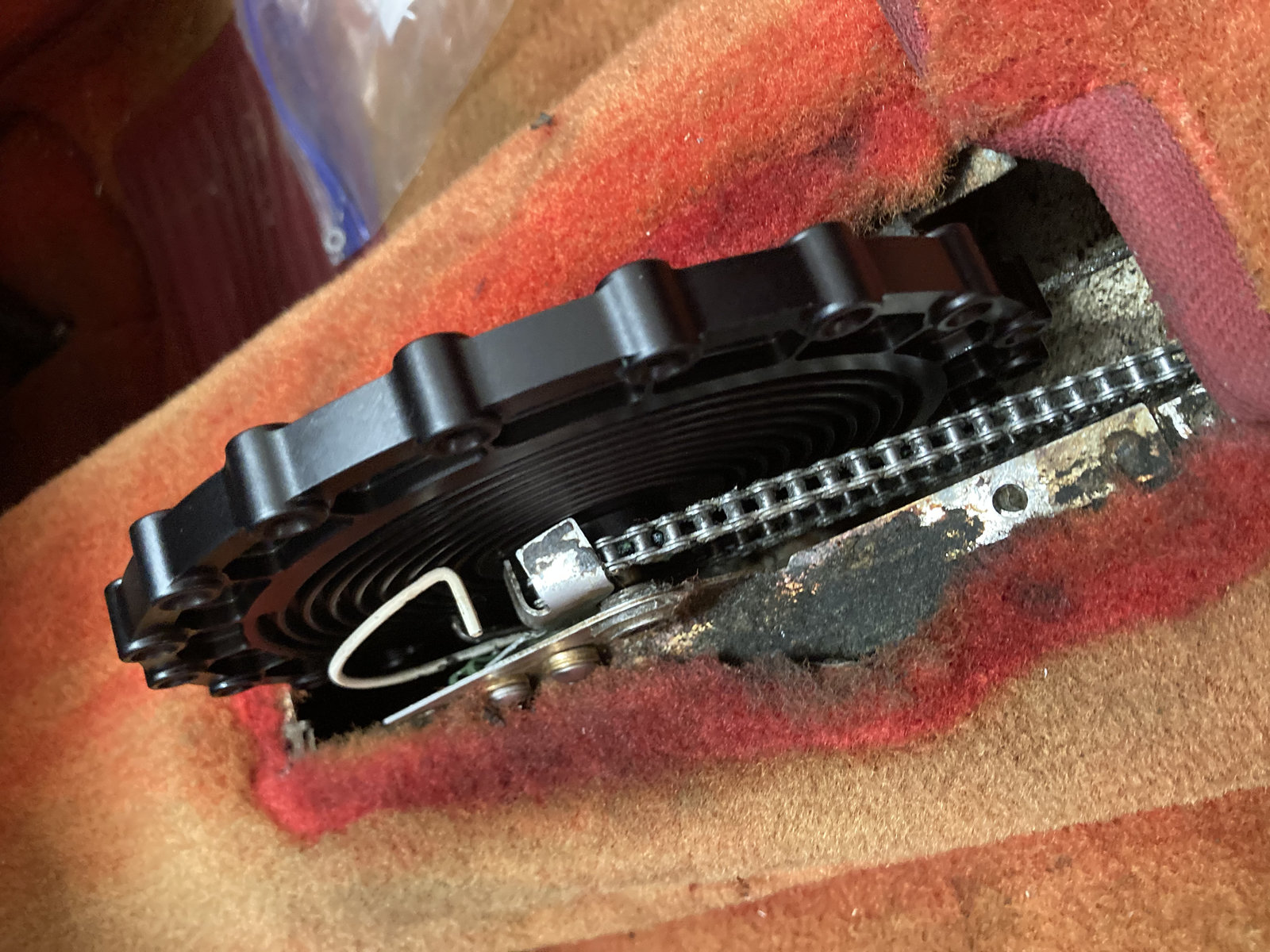

I just wanted to say thanks to everyone on this thread for creating such an informative discussion on a pretty large maintenance task on these old airframes. I just finished installing the McFarlane jackscrew kit and Qmi trim wheel in my 182a after suffering a trim jam. Jrc111’s discussion on rigging the system was invaluable. Thanks again!
Ps. I’m very pleased with the new trim wheel, it has completely eliminated any play in the trim system, and looks nice too!
