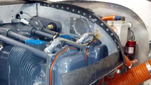

I finally got out to do some flying yesterday afternoon. Unfortunately I ran out of time to fly with all the configurations that I wanted. Here is how I was configured:
Winter kit as discussed above was on.
The oil cooler taped over along the diagonal (basically half covered).
Oil temp on start up was around 50 degrees, same as hanger. After start it dropped into the high 30s as normal.
Outside air temp on the ground was 32 degrees.
On takeoff, a couple of CHTs got warm quicker than normal due to it being warmer outside and having the winter kit on. Ideally I would have liked to have flown it with and without it on, but I ran out if time. Lowering the nose took care of this. I climbed to 7K feet and set it up roughly 100-120 ROP. Power set at 21.5" and 2200 RPM. Oil temps continued to climb during the climb out to read 145-150 on the analog, 148 on the JPI EDM-700. Cowl flaps were closed until a few minutes in when one CHT got a little warm at which time I opened them 2 notches, which from experience is enough to reverse the trend. Again, without the winter kit on, I would expect I could have left them closed. OAT at 7K was 44 degrees on the EDM and 42 degrees on the analog air vent gauge. I calibrated the EDM to it before flight.
Then I went to LOP at the same altitude and temperature. Oil temps stayed between 148-150 degrees. The analog gauge showed 145-150. CHTs were all 300-350 degrees with cowl flaps now fully closed.
The other downside to this flight was that it was relatively short, :41 total from start to shut down. I would have liked for it to be longer and need to do a longer flight at both settings to see how the oil temps react. I'm hoping to get a couple of longer flights in mid week next week. I'll also pull the winter kit off.

I finally got a chance to call the oil cooler place who made my cooler and ask them about this issue. I told them what I am seeing, what I've done, and the results. His thoughts were just as Glidergeek thought: vernatherm. He says seeing the rise in temp that then stayed steady also tells him it isn't working. He says it sounds like it has failed in the extended position and the oil is going through the cooler all the time. He recommended that I take it out, inspect it, and test it.
So, that will be next week's project! I'll let you all know what I find.

Well, it looks like I got this taken care of. Here's what I found.
Last week I got the vernatherm pulled thanks to Glidergeek lending me a custom, purpose made wrench to take it off without removing the prop. With it off, I put it in a pot and heated it up to 190 degrees and could see that the vernatherm was actuating. Two things confused me. One, when I got took it off, I could see that it said 148 F on the vernatherm cap. Second, it seemed to be actuating the total distance that it was supposed to move.
Vernatherm in boiling water
Vernatherm with noticeable movement
Cap of the old vernatherm
Instructions for testing vernatherm.
So, the next day I talked to Cessna Tech Support and Continental. The fellow at Cessna didn't have the specs as to what the temp stamped on cap meant, but the Continental guy said it was the temp when the vernatherm started to move (although based on what I now see, I believe it actually may be the temp when the vernatherm is completely extended. That makes more sense with the test instructions that give you a specific distance at 173F. More on that in a minute). The guy at Cessna felt pretty confident that it was the vernatherm.
So, after sleeping on it, I pulled the trigger and ordered a new one (suckers aren't cheap! $400!). Fast forward and it showed up today. As soon as I got it, I opened it up and knew I had made the right call. Stamped on the cap was 173 F. A temp a full 25 degrees higher than the one on the old original part number. This part has been superseded 4 times and it appears somewhere along the line the temp was raised. So, with the part in hand, I headed to the airport. It went in quickly and soon it was time for a test drive. Big difference! Oil temp seemed to come up faster and before takeoff, it was at 140. With the old one, we were having a hard time getting that in cruise! Shortly after takeoff, it climbed to 165 with an OAT of 45F. LOP it dropped to 160 and stayed there the rest of the flight. On the ground, no leaks.
Cap on the new vernatherm indicating 173F.
So, I think I've put this one to bed. We will be heading to Chicken Strip Friday morning so I'll get a good cross country to see how it does. Thanks to everyone for the input and help. And a big thanks to Russ for the wrench and Rich for the insight/technical help!

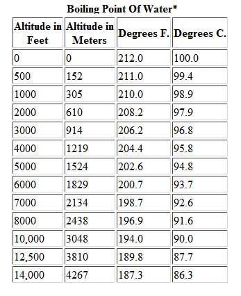

As Zane mentioned, water will still vaporize at less than 212* F, but the closer to 180* - 200* F range the better.
The chart below illustrates how altitude will effect the boiling point of water.

And, bear in mind that, while the oil temp at the sensor may be 180, SOMEwhere in that engine, that oil is in fact in excess of the boiling point. As that water vaporizes there, it passes through the engine and is evacuated through the crankcase vent.
At the Lycoming Piston Engine Service School, they emphasized the notion that if you get the indicated operating temp to 180 and keep it there for a while, you'll cook off most of the moisture in the oil, and your engine will last a lot longer.
So, the magic number is 180 f.
