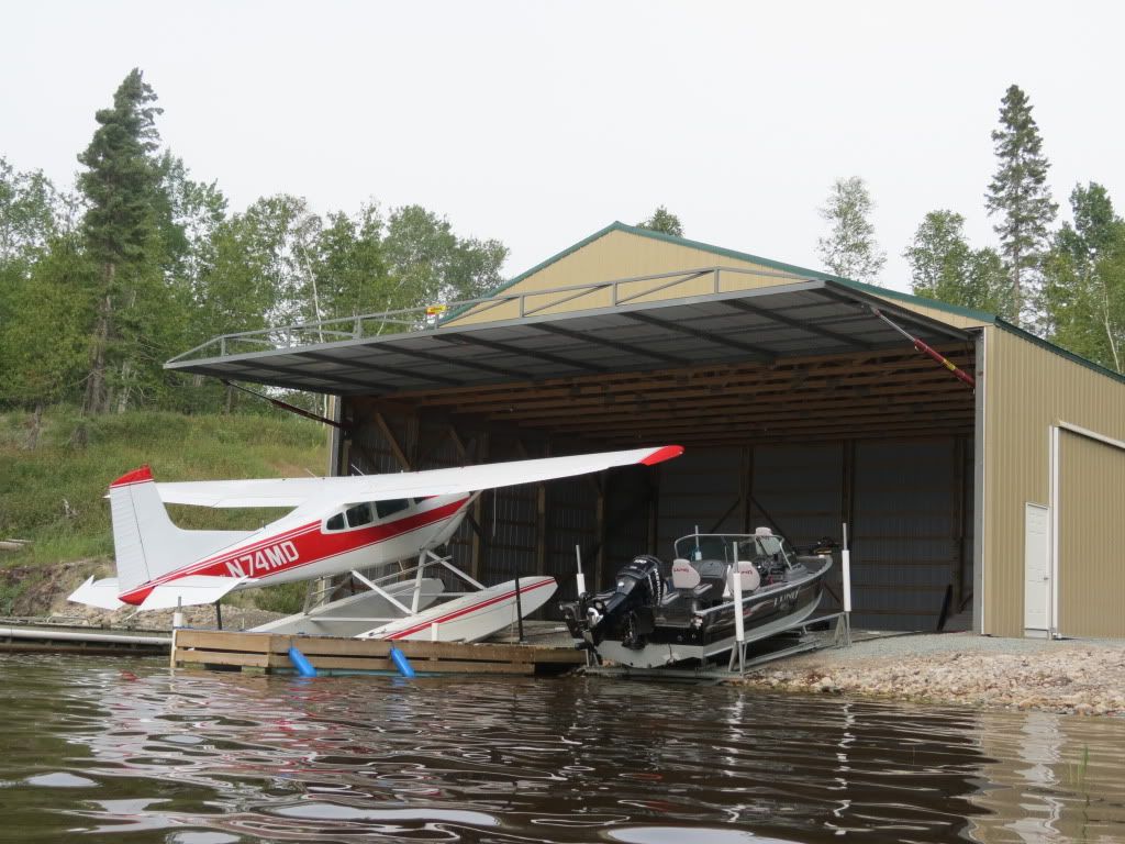

Pictured is the hangar I put up this spring with the 48 ft X 16 ft Schweiss hydraulic door. It does take some beefing up of the building to handle the weight of the door, but very little lost headroom compared to a bi-fold.

steve wrote:Pictured is the hangar I put up this spring with the 48 ft X 16 ft Schweiss hydraulic door. It does take some beefing up of the building to handle the weight of the door, but very little lost headroom compared to a bi-fold.
Steve,
Your place looks awesome! You are indeed a fortunate man. Not much float flying in North Central Idaho, but some around Coeur D'Alene, and Spokane. It is a pretty short season between spring runoff with driftwood then winter ice. I actually sold my wheel skis to help pay for my dozer. The guy that bought them owns the Telkeena Lodge in Alaska. He should get more use out of them than I did. Thanks for the post.
