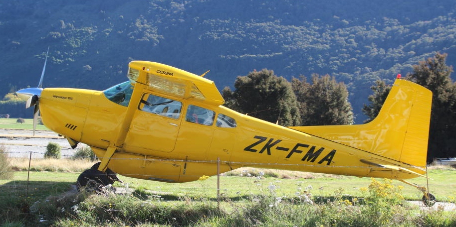

I don't think they are "required" on 185's, perhaps just a good idea. There's an A185F here that's been flying backcountry grass & gravel airstrips for about 25 years without a V-brace. Image
Thanks Bigrenna for all the entertainment, this really is a very cool thread. Where did you get scales capable of weighing a plane?
