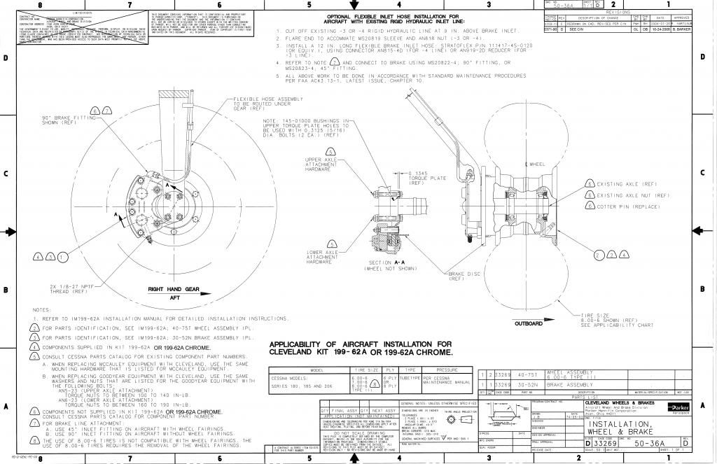

[quote="aktahoe1"]Nice work.
Also noticed your lines are coming in over the strut. Have always put mine under the strut. Is there a correct way? Have always thought that routing them under was correct.
The Cleveland wheel drawing suggest under, where did you get the SS lines?

SS brake lines were sourced through Sacramento Sky Ranch.

So, just to clarify. Are you guys using teflon braided steel hose to replace the hard line? Just commenting and not being critical, but long lengths of flexible braided steel line have been known to cause spongy feeling brakes. :( My 185 has pretty beat up hard lines form all the years of float/wheel changes and I too have been considering the options. #-o

Currently I have hard lines down the legs, and SS to replace the old hard rubber lines. I had the same on the C170 but new hard lines. No experience w/ what Kevin is running, although I suspect we will put new hard lines back after the new year.
