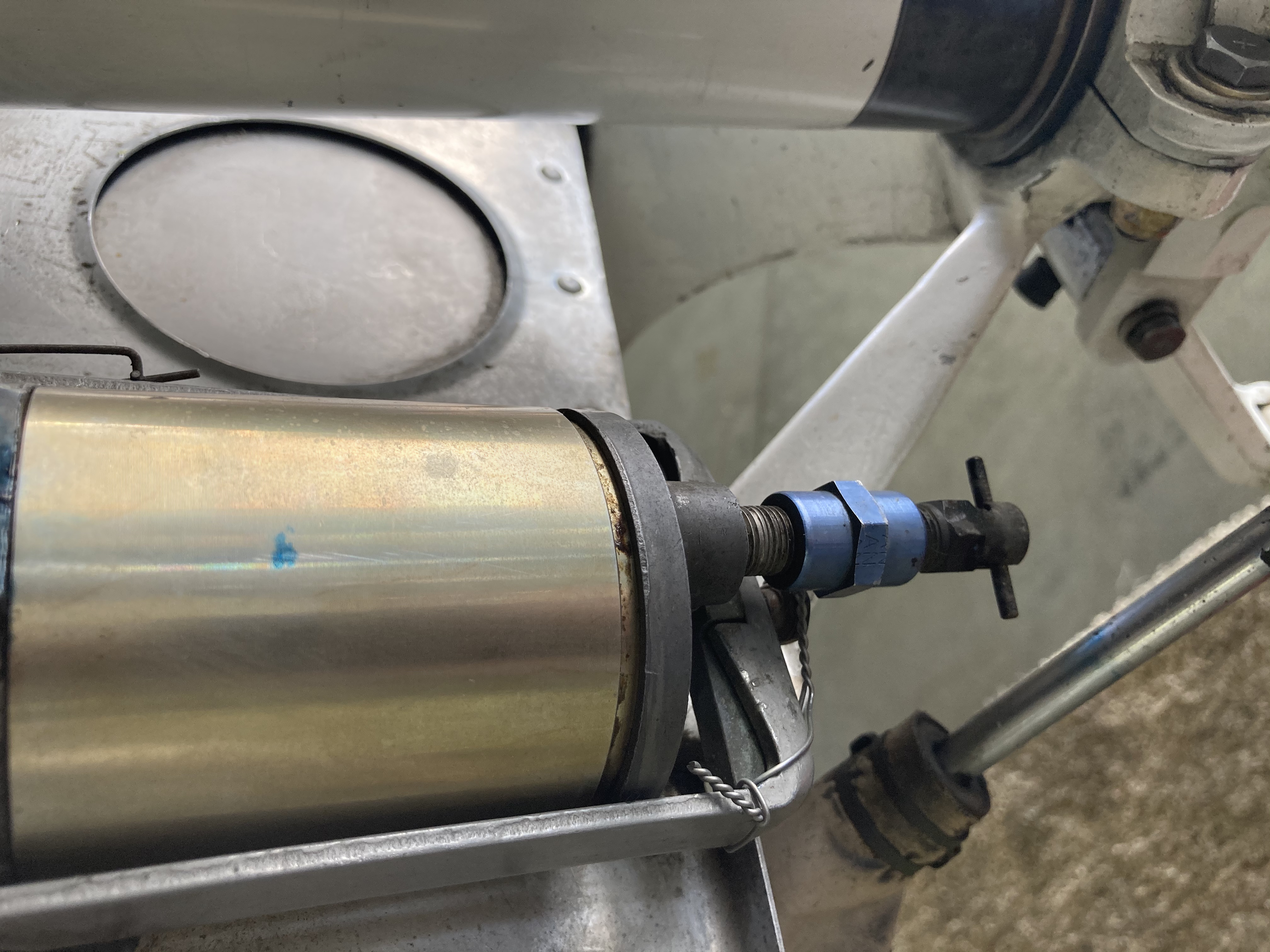

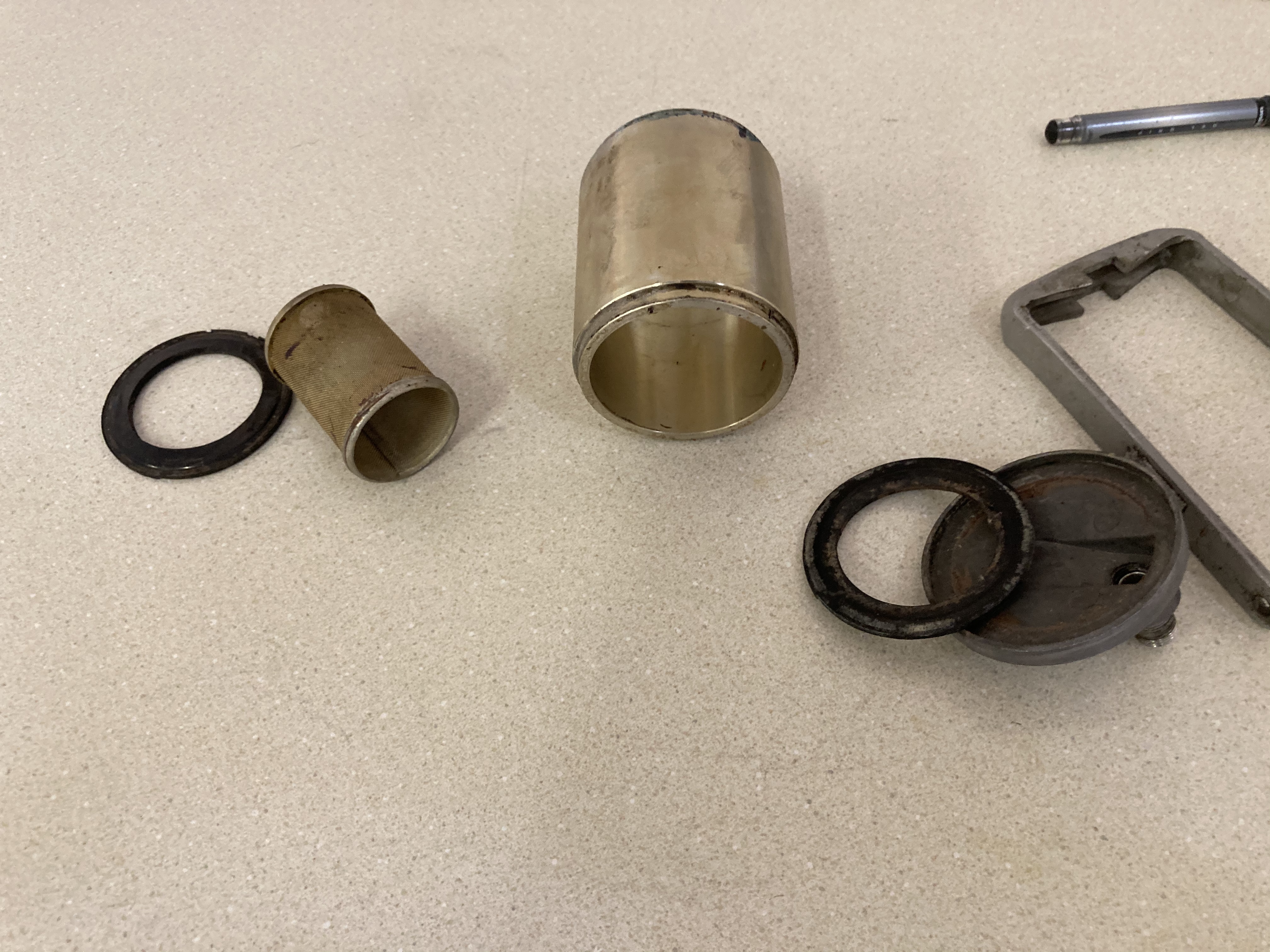

Took my '58 182A out to Panamint Springs Resort a few weeks ago and landed on their private strip behind the gas station. It's in beautiful shape, by the way... Granted, this was my very first time landing on dirt, sooooo maybe it's rough, maybe it's smooth LOL!
Anywho, during preflight before departing the next morning, I pulled the remote fuel drain knob, heard liquid blue money hitting the ground, then proceeded to walk around the aircraft. I noticed fuel still dripping from the drain under the cowling. Fiddled with it a bit, still leaking. Noticed if I pulled down on the lever real hard, the drips would stop... Tried readjusting the cable, still leaking. So, cut the cable off the lever, safety wired the drain lever down nice and tight. Turned fuel back on, no leaks. Went and used the restroom and said bye to some friends, to give the fix a bit of time to make sure it wouldn't start leaking again. Looked good, pushing and pulling, shaking and shimmying I couldn't get it to leak any more. So, I departed and had a smooth and uneventful flight home. I was hoping to hit Stovepipe and Furnace Creek on the way home, but I opted to get home as quick as I could.
After a few interweb searches and talking to my IA, I decided that going through the effort to rebuild and overhaul the 61 year old glass and cork vessel with levers and bails, and all sorts of moving parts, was not nearly as attractive as bolting on a shiny new one. Monday morning I called Steve's Aircraft and ordered up one of their gascolators.
It showed up quick, and when I opened the box I was blown away at how nice it was. Now I may be growing numb to how much "aviation" things cost, but compared all other things "aviation", this thing is a bargain!
All new AN fittings and a new SAF-AIR drain valve to replace the remote cable nonsense and it's ready to fly. Waiting to have it all checked out and signed off and I'll give her a test run.
Just wanted to echo what I've heard many times on here, as well as other sites, that Steve's Aircraft is a joy to do business with and they sell a quality product for a fair price.
A few pics below...

The steering linkage gets in the way of being able to press on the drain valve with the little cup, so I just push with my fingers and catch the fuel in the little cup. I suppose one could add a little 22.5 degree angle adapter to point the drain away from the linkage, but I didn't want the valve sticking out past the cowling any more than it does already.
I eliminated the remote drain cable, but Steve's does have a gascolator that retains the remote cable linkage if you are so inclined.
