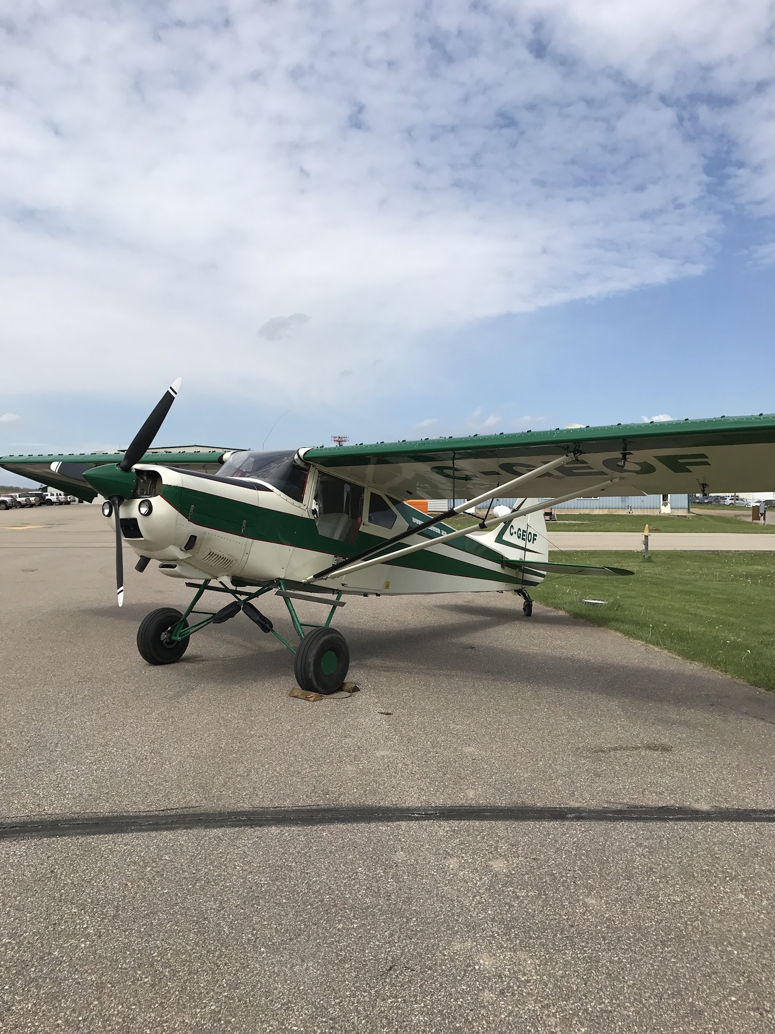

Sure enjoying this thread - some very nice airplanes! Thought I’d add a couple pics of my Bushmaster. Left seaplane door - cub style gear - PA 18 tail - cuffed leading edge - micro vgs- continental 0-470 - 1501lbs empty 3000 lbs gross.

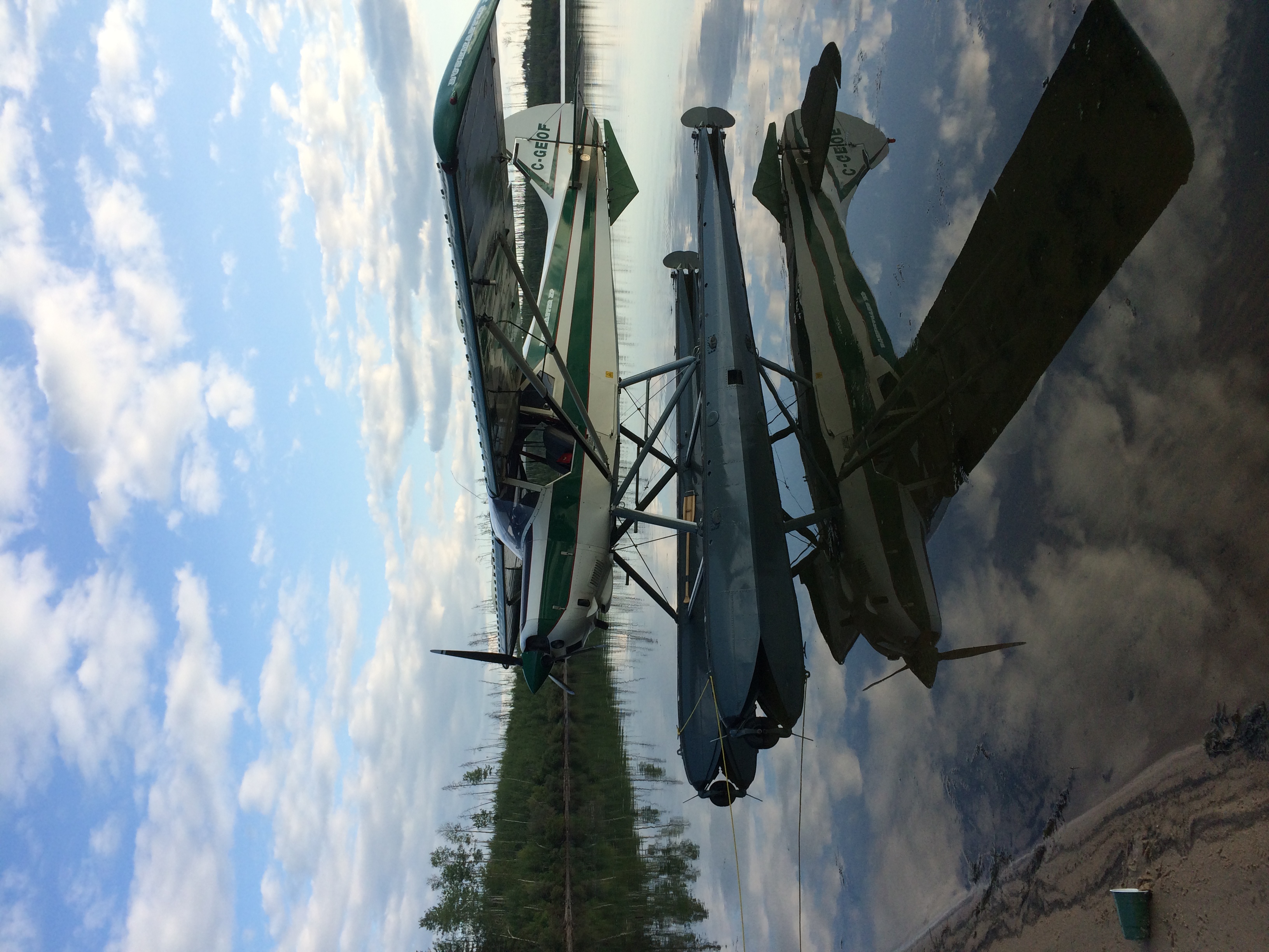

Re: Ultimate PA-22 dream build...
Here is the plane on 2790 amphibs

Ghan, did Savilles build that one? What kind of gear is that. My customers gear just failed at the point where that crossbar joins the front tubing. I've never seen a gear fail like that where it end up going forward.
Hi A1 skinner. I built my airplane- but the Savilles are close neighbours so were a great resource during the build.
The supercub style gear was incorporated to hopefully avoid a break like the one you are working on.
That looks like Ray Woodward’s old airplane - if so it was mostly built out here too

Ya Edy had his hand in building this one. We picked it up in Aberdeen, Sk. Can't remember the owners name. I thought this was 3" extended piper gear, but I need to look it up in the logs. Very nice flying plane, and will continue to be here in a month or so.
Looks like Pacer gear - if you look at the gear on my plane you will see that the forward and rear attach points are much further apart than the pacer style - the thought is that it would take a much harder hit to damage the gear - also the hydrasorbs are out from under the seats allowing for much easier servicing and seasonal float changes.
ghan wrote:Looks like Pacer gear - if you look at the gear on my plane you will see that the forward and rear attach points are much further apart than the pacer style - the thought is that it would take a much harder hit to damage the gear - also the hydrasorbs are out from under the seats allowing for much easier servicing and seasonal float changes.
Ya it's definitely -18 gear with the wide spread and the cabane V underneath. I agree that it's much better then the Pacer gear. If you look at my picture a bit closer you can see the bungees under there.
Ahh - yes- should’ve looked closer! Must have been quite a bump!!
