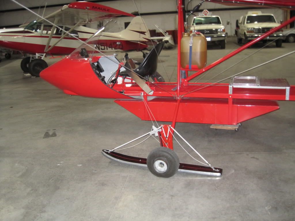

Hello Backcountry Pilots,
Looks cold to me! "Powered lawn furniture on skis"?

James is that your Drifter? Those are great planes if you like eating bugs like some of us do.
I guess I need some new snow boots that aren't made for clipping into bindings. I'm a maniac with a shovel though, fingers crossed.

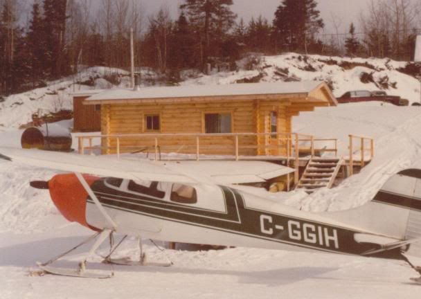

I used to fly my C170B on skis and had a lot of experience flying with my dad in the C180 on skis as well. I flew only off the lakes and never on snow covered fields so only had straight skis. Here are a few things I learned and some tricks to pass along.
* Pack down your parking area and runway with a snowmobile or by taxiing over the area repeatedly. This will freeze the ice better and reduce the dreaded slush overflow that often shows up on lakes especially after heavy snowfalls.
* When warming up the engine at your parking spot apply full flaps. This directs the prop blast down and blows away loose snow.
* Put something under your skis when parked so they don't freeze to the snow. Shake the plane by the wing strut to break the skis free before starting up.
* Taxi with takeoff flaps applied to help get some of the weight off the skis. You will be using considerably more power to taxi than when on wheels.
* Keep your speed up when taxiing in slush. If you get stuck and have a passenger, get the passenger to get out and shake the plane by the wing strut until you can move the plane again. Taxi a few circles around the passenger and then stop on your tracks to pick him up again. Did this lots with my dad.
*Landing on snow on a cloudy day is like landing on glassy water with floats. You can't tell how high you are above the surface. Land near a shoreline if possible and use the glassy water technique.
* Stay away from creek and river mouths on a lake. The ice conditions are usually bad there due to flowing water.
I don't put the C180 on skis, although I have them. The changeover from floats is expensive, the days are short, its hard on the plane (slush, snowmobile tracks, etc.) and generally I just can't justify it . I sure miss ski flying though.
