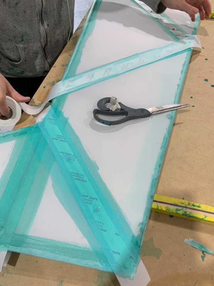

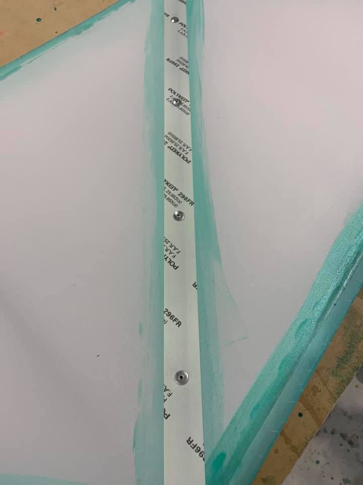

No wonder my belly fabric is drumming itself to death, I'm missing all those cross braces and rivets. Winter project. Now I've got to go back and look at your pre-fabric pictures. Rivets just the AD42BS into an aluminum cross-rib? Noticed the tapes are the narrow 3/8 or 1/2" (can't tell). Factory uses Boeing cargo hold friction tape, Polyken 296FR, but I still have some of the polyfibre stuff around.
aca tape2.jpg (52.25 KiB) Viewed 770 times
aca tape.jpg (27.3 KiB) Viewed 770 times
