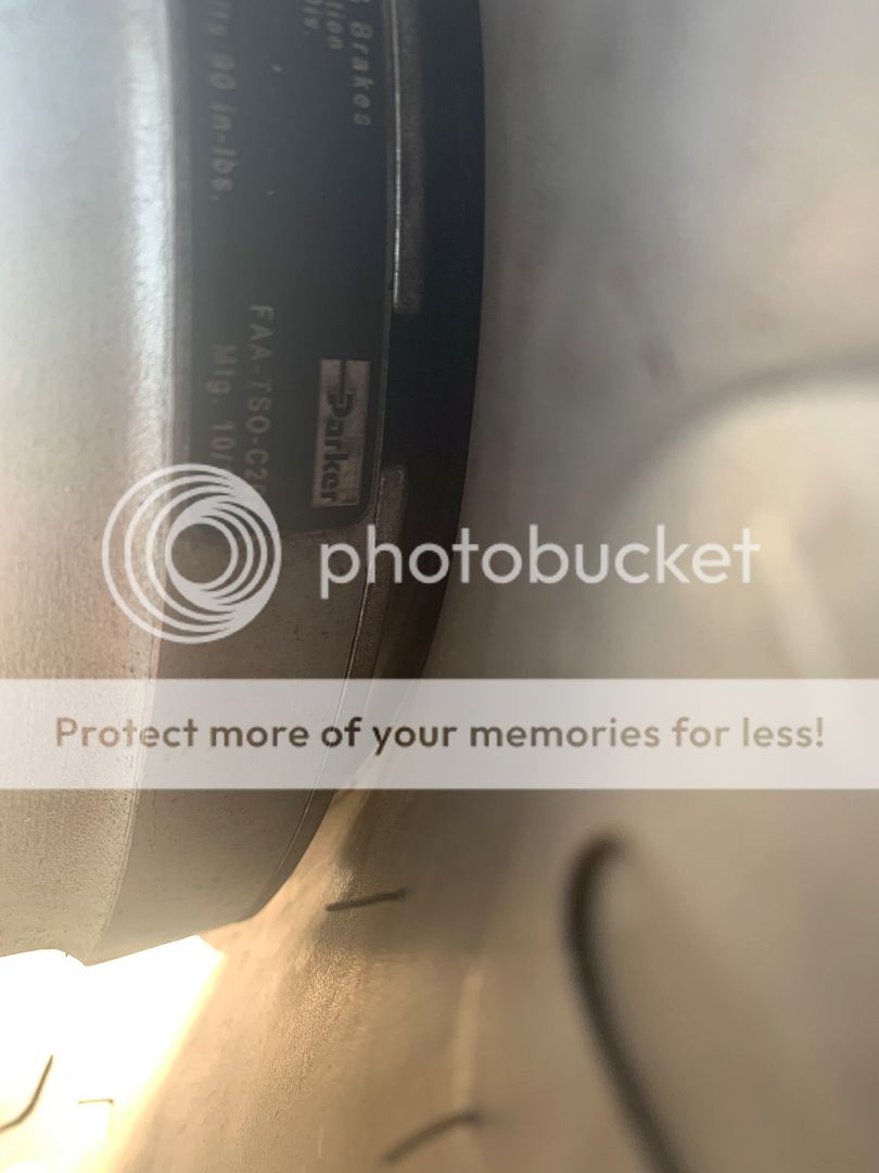

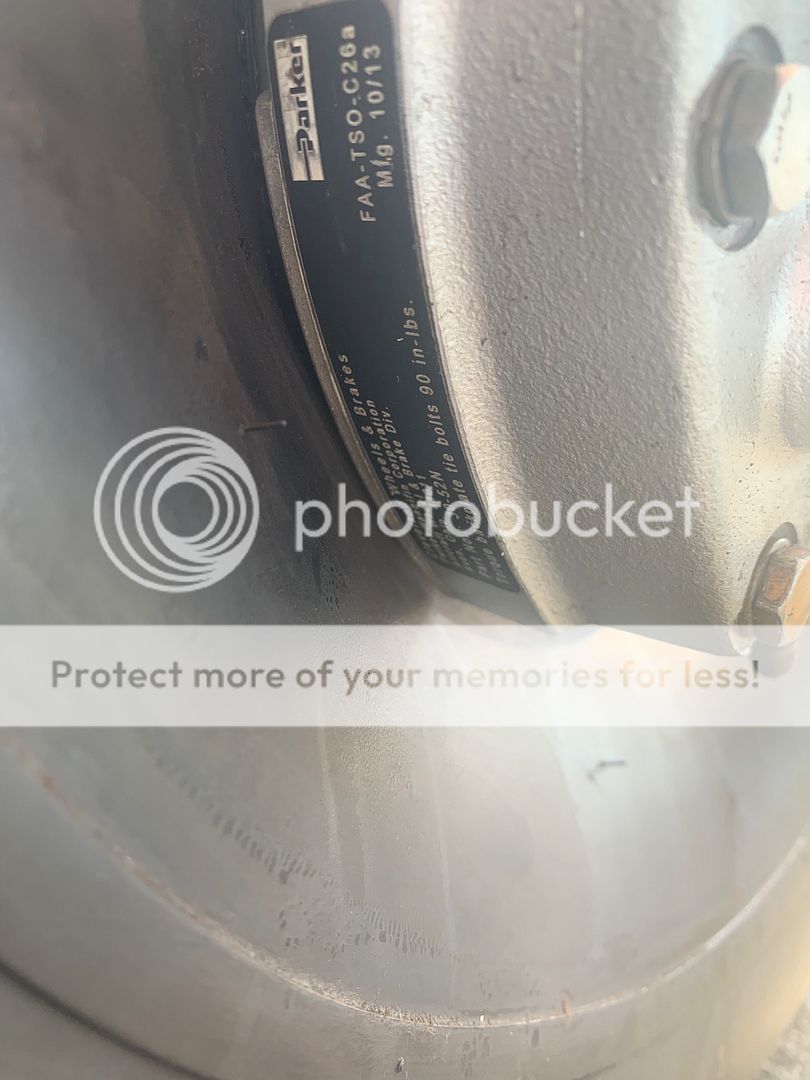

I need some advice from you guys......
So I recently got a field approval to run 26" Goodyears on my 182. I'm running 40-75T Cleveland 6 bolts wheels with 30-52N brakes. If I had to guess I have about 1/8" at minimum and 1/2" at max of existing clearance. See pic below. The existing clearance makes me very nervous although with higher pressures it doesn't rub, even under load and\or compression. Nonetheless, I want a little more clearance. I spoke to Gabe at Alaska Airframes today and for $220 I can get a set of spacers which includes (2) 1/8" spacers for each wheel along with longer bolts. That gives me either an eighth or a quarter inch depending on if I run one or both spacers per wheel. If I run both I assume I'll need to new offset torque plates because of the pin length. New torque plates run $249 each. So, all in I'm dropping $750 for the added 1/4" of clearance.
My question is this; how much clearance is enough?

One spacer per side is enough. Been there, done that.

Nushi wrote:.... If I run both I assume I'll need to new offset torque plates because of the pin length. New torque plates run $249 each. So, all in I'm dropping $750 for the added 1/4" of clearance. ….
Can you buy longer pins for your existing torque plates?
Re: 26" Goodyear Blimp Tire Rubs on Brake Caliper...
Battson wrote:One spacer per side is enough. Been there, done that.
Roger that. Thanks!

I don't know but if it would solve the problem and make financial sense, I definitely will. Gonna start with the spacers and see where that gets me.

When I first put the 29 in Bushwheels on, the close fit to the tire was the first thing I noticed----and kind of worried about. My brake linings were about half worn and I have never had any rubbing. New brake linings might be a problem but have wondered about grinding new down to half and leave things the way they are.
