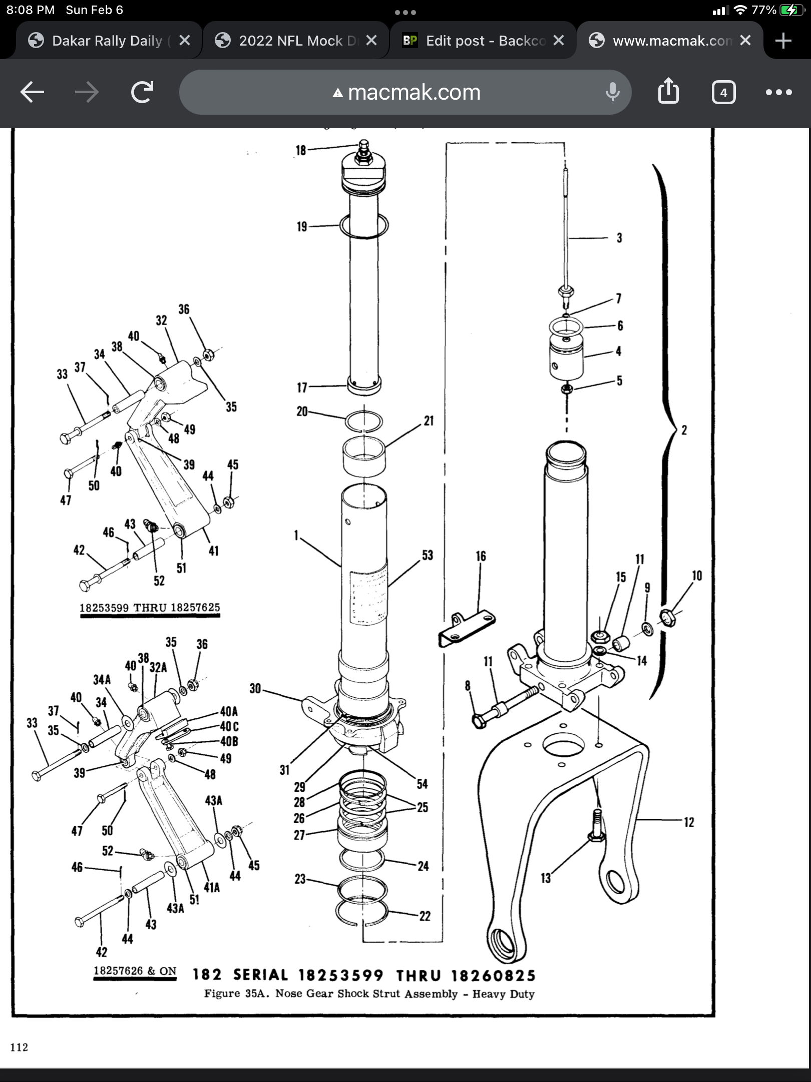

Addicted2climbing wrote:Hello All,
A friend of mine is considering adding a 310 fork and 600 tire to his 1960 C172. In the past this was an easy 337 to get, but seems its tougher now. We are in Los Angeles area and curious if anyone can share a 337 form for the 310 fork on a narrow body C172? If we were in Alaska this likely would be a non issue since its such a common mod.
I had heard it was an option on the narrow body C172 but I am beginning to think that was incorrect info. I know the T41 had it and a few later model wide body C172 but he cant find it in his parts manual. On my C182p it shows as an option and when I install mine its just a logbook entry. Would be great if it were the same for him. Anyhow any advice or help would be appreciated. Feel free to PM me if you have a 337 you want to share and I will reply with my email.
Marc
Are you sure your 182P is included in the serial number range for HD option?
I have a ‘71 182P and it’s serial number range is NOT included in HD option. It’s listed in parts manual but the HD option ended with the N model. Check your serial number. Airglass is only option unless you know god…..
I understand you were inquiring about a ‘60 172.
