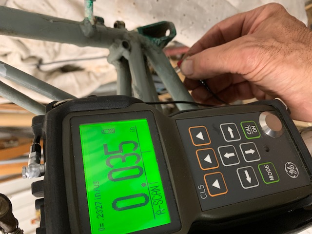

I have to disagree with your "pilot friend". Non-Destructive Inspection (NDI) is employed regularly across industries and specifically called out to ensure structural integrity of tubular structures in aircraft by manufacturers and is mandated in type specific Service Bulletins and AD's. The Beaver is one such example where we use an Ultrasonic Thickness Tester to confirm wall thickness of tubular structures such as the forward tubular frame (birdcage), rudder pedal torque tubes, and forward fuselage (doorpost) struts.
Although not mandated, I just completed mapping the entire tubular frame wall thicknesses on our '54 PA-18A as I have it stripped for re-cover. I desired to know the wall thickness of my entire frame as now is the time to remove and replace tube if required. UT is an invaluable tool to identify wall thickness allowing one to determine if the tube continues to meet design strength criterion. I would certainly employ UT on a tubular frame during pre-purchase inspection. Yes, there are areas of "cover" that are not accessible, however, there are enough accessible locations (longerons/rudder post for example) providing enough data to make a walk away or proceed assessment. Do not fear the tubular structure, there is a reason it is an enduring engineering practice.

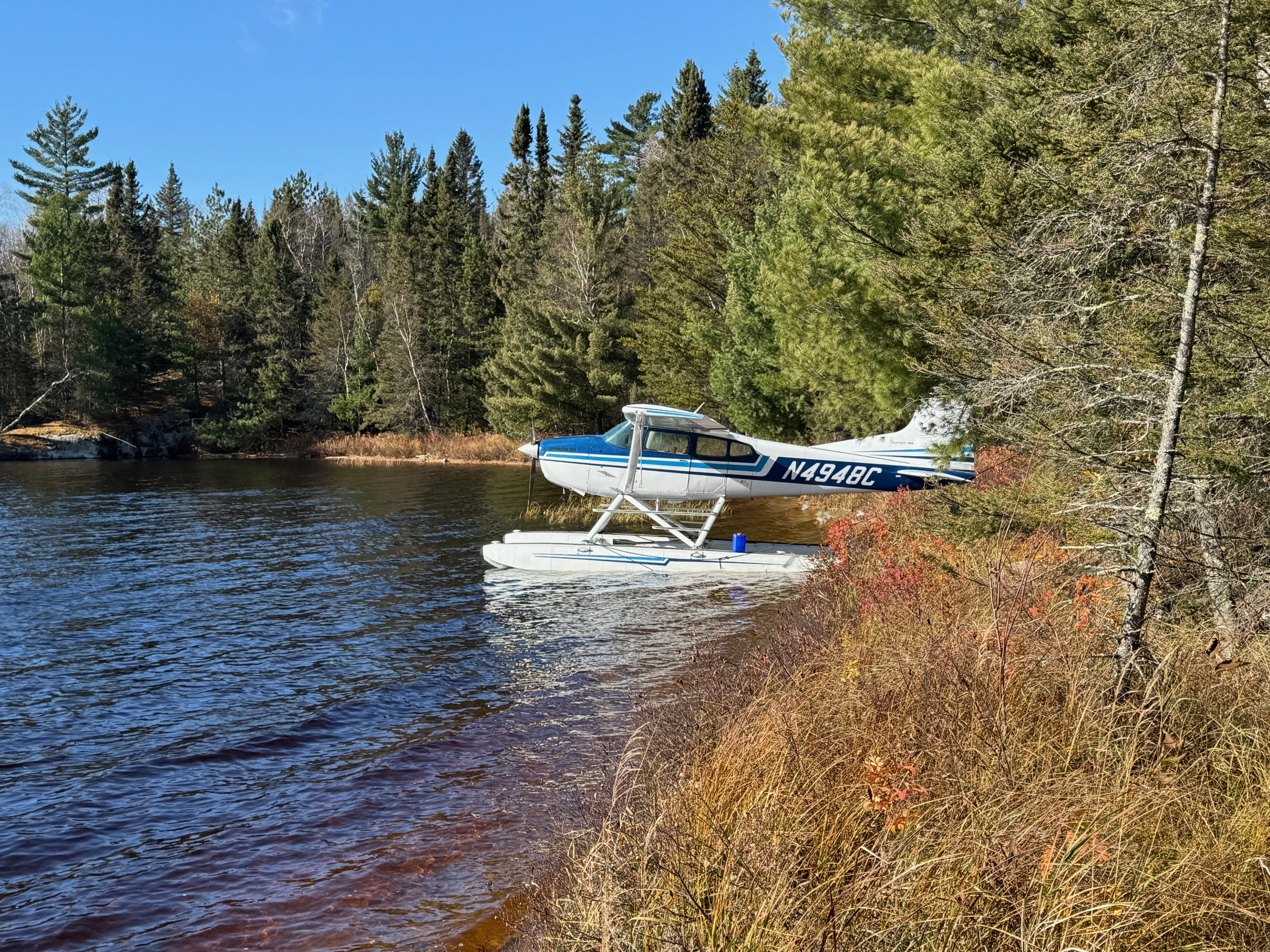

Since you live around here and the vast majority of backcountry flying opportunities are on floats, one thing to consider is the tail.
You will often be parking on a beach, and the water level varies with rain.
My tail often ends up in the sticks, and you can trim them back ect but the stuff grows fast and the water comes up so inevitably the tail makes contact with some sticks.
I would be pretty nervous with a fabric tail. You would probably have to nose in and tie down, then cut like a maniac well beyond any where the wind might blow the branches into your tail. Then spin the plane and tie down again.

TR wrote:I just completed mapping the entire tubular frame wall thicknesses on our '54 PA-18A
TR
What is this device called?
Edit: GE Inspection Technologies CL5 Ultrasonic Thickness Gauge. I see a number of similar devices out there that are described as "coating thickness measuring devices" but unsure if that will penetrate .035" steel.

Geeze, thanks. Another gizmo I would sure like to have. how muchy monies ?????

shorton wrote:Geeze, thanks. Another gizmo I would sure like to have. how muchy monies ?????
The unit pictured is no longer in production, however, it is available and as long as one carries out the calibration procedures prior to use, it does exactly what it was designed to do. This unit was recently available for $1000 as I recall from a company called Instrumart which sells and rents test equipment. This unit was in its rental arsenal and being phased out. There is a lot of science behind NDI in general and Ultrasonic Test (UT) specifically. Generally, if NDI is mandated it must be accomplished by a level II technician or above which is beyond the skillset of the typical A/P and IA. Having said that, if not mandated, have at it. I recommend some training on the particular unit and press on.
