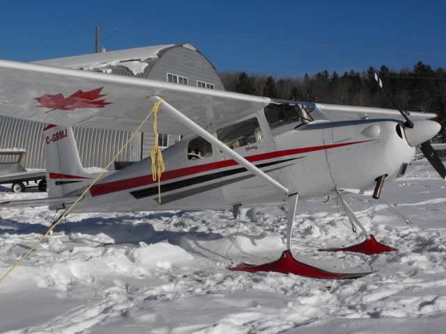

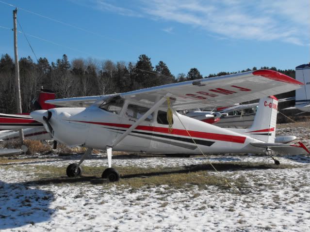

Re: Announcement re: Fravel 172 Tailwheel Conversion STC
With a whole pile of work they come out like this.............
Hey Bill....................
Why don't you send me a plane ticket and I'll just come on down there and help
you :o
Jimmy M offline
Posts: 26
Joined: Wed Oct 21, 2009 4:28 am
Location: Sudbury Ontario
Jim Martin
Aeronca Chief homebuilt 160 hp
'56 172 taildragger 180 hp
Re: Fravel 172 Tailwheel Conversion STC
EZFlap wrote:..... If I invested the kind of capital that is needed to buy new Cessna parts (several thousand, over fifteen if you count new gear legs), that will only increase my cost of developing the STC, which will only add that much more to the price I have to charge......
I was thinking of used parts, either bought by the piece or aquired as part of a complete fuselage as my friend did. But good luck with the borrowing, and with improving the STC.
you
Looking at that second photo, it appears to me that you really need to go see Wup over at Bushwheels.
I'd send you a ticket to Hollywood, but you might be uncomfortably cold when you got here... this place may be a little too extreme weather for you Ontario guys. Last night the temperature in Los Angeles plunged down to +50 degrees F !
