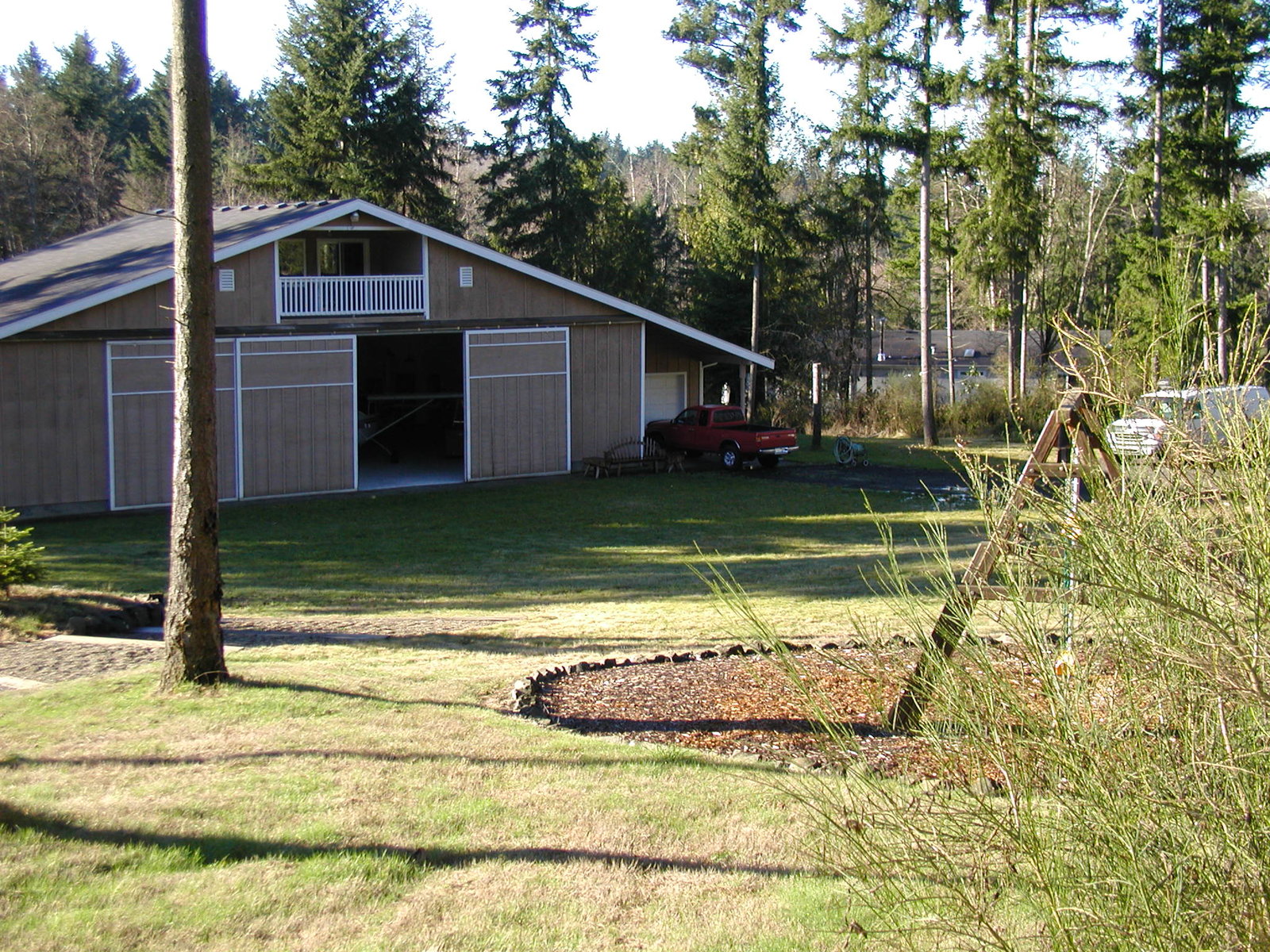

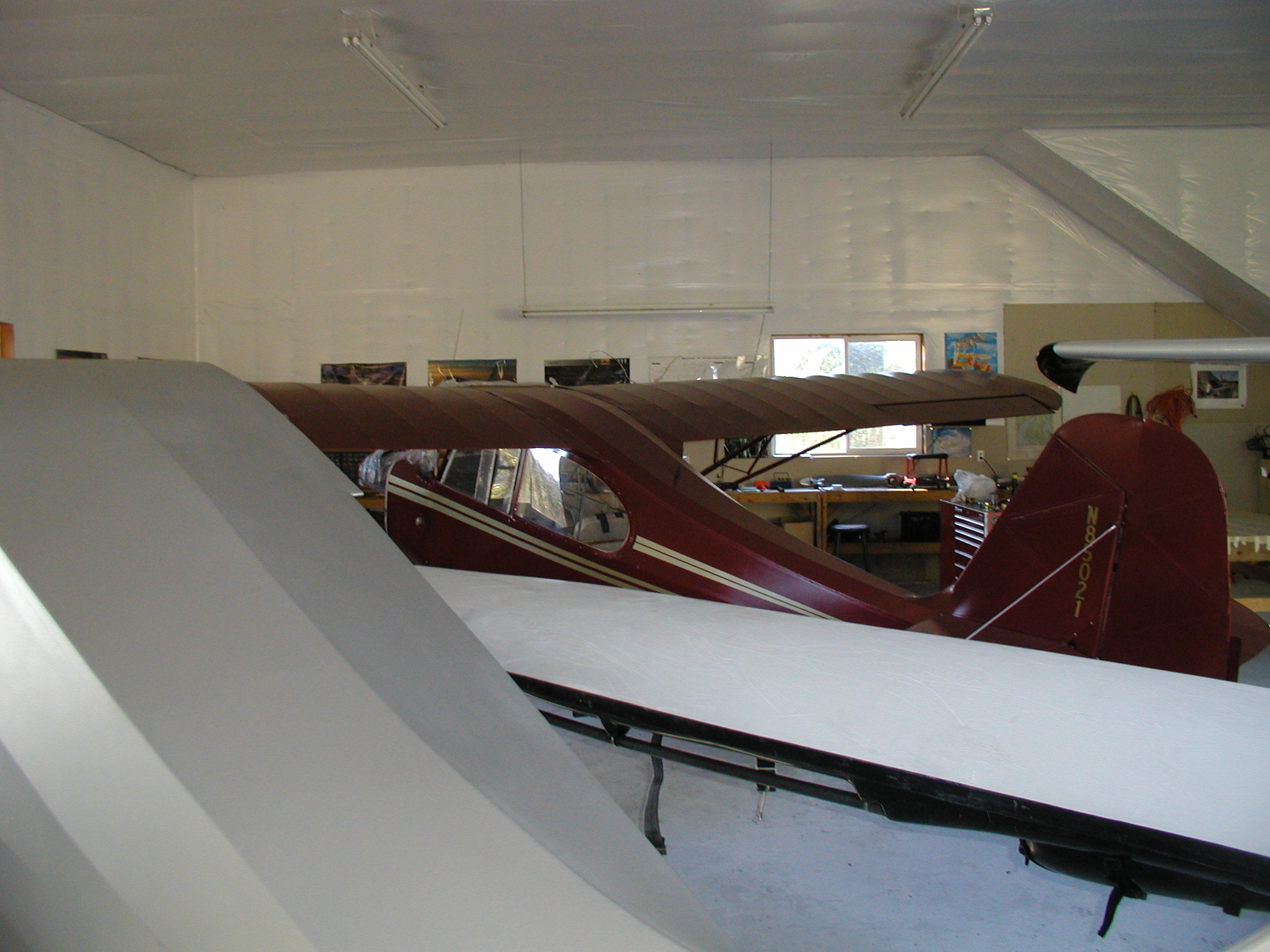

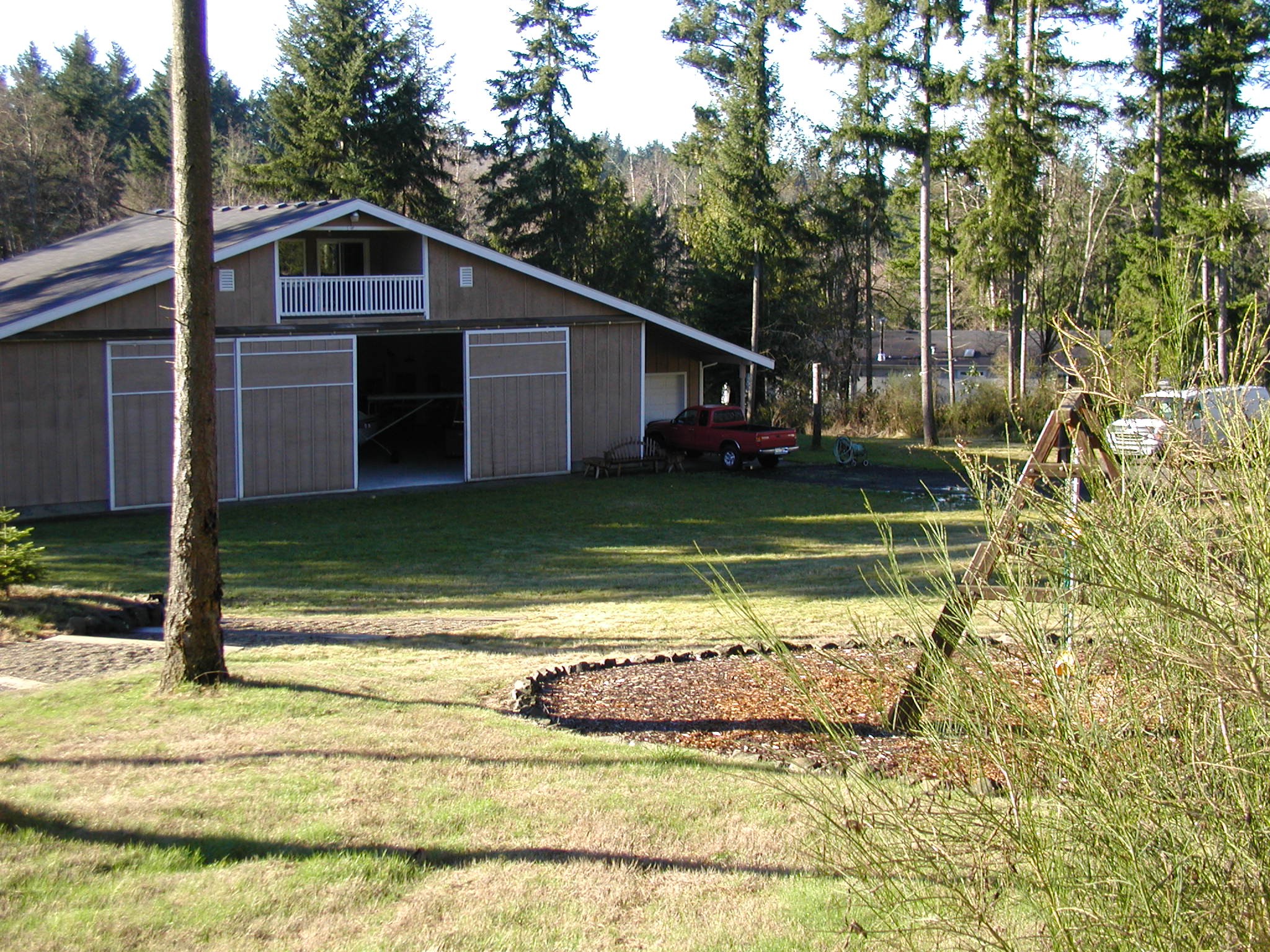

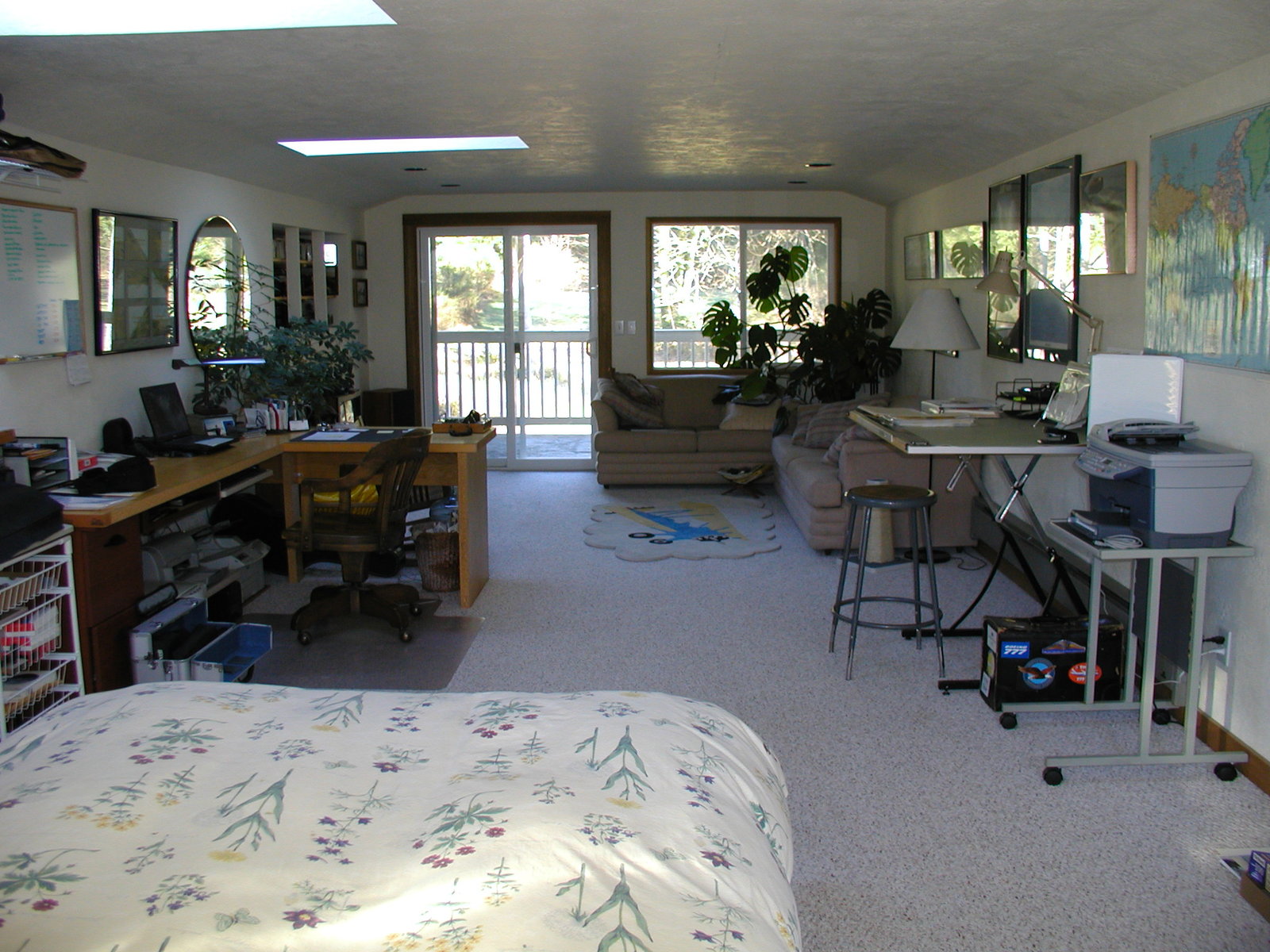

All good info..... It depends on where you are building and what the local covenants are too. If possible, avoid the use of terms like "Hangar", "Bathroom" and "Living Space", etc. if building on an airpark. If building on an airport you may have a problem avoiding those terms which will bring in tighter compliance standards.
I built this in Kitsap Co, on an airpark as a shop space. The open area in the trusses was engineered to meets floor loading but not called a living space though it was. There was no 'kitchen' by definition, though I had one by keeping the sink in the shop and not having a oven. The 'bathroom' was built after the last required inspection (structural only) as a lean too on the back of the building then hooked up to the septic for the house which was built later. Long story, but I avoided all of the rules around hangars, wiring, fire protection, occupancy and on and on and on.
The building was 42' deep, 60' wide, 14' high. The open area in the trusses was 42' deep, 20' wide. On the end I had a 14' wide by 50' deep drive in shop that had double doors opening into the hangar. The main door was 40' wide by 14' high. I built it to fit a Stearman, Bonanza and Champ which is what I had. Later a Champ, 182 and Maule all fit easily. In my opinion, width is more useful than depth. I have a 60 x 60 box now, the 42 x 60 made more sense and was easier to build in wood.
It was heated by a propane hanging shop heater, insulated with 4' wide rolls of tyvek back insulation meaning I did not have to sheet rock to make a clean barrier and have great light reflection.
When the house was built since the shop was neither a hangar nor dwelling it had no bearing on the septic system, nor having a second dwelling on a lot smaller than what was allowed for at the time.
Just needed to know how to make the current codes work the way I wanted them.
