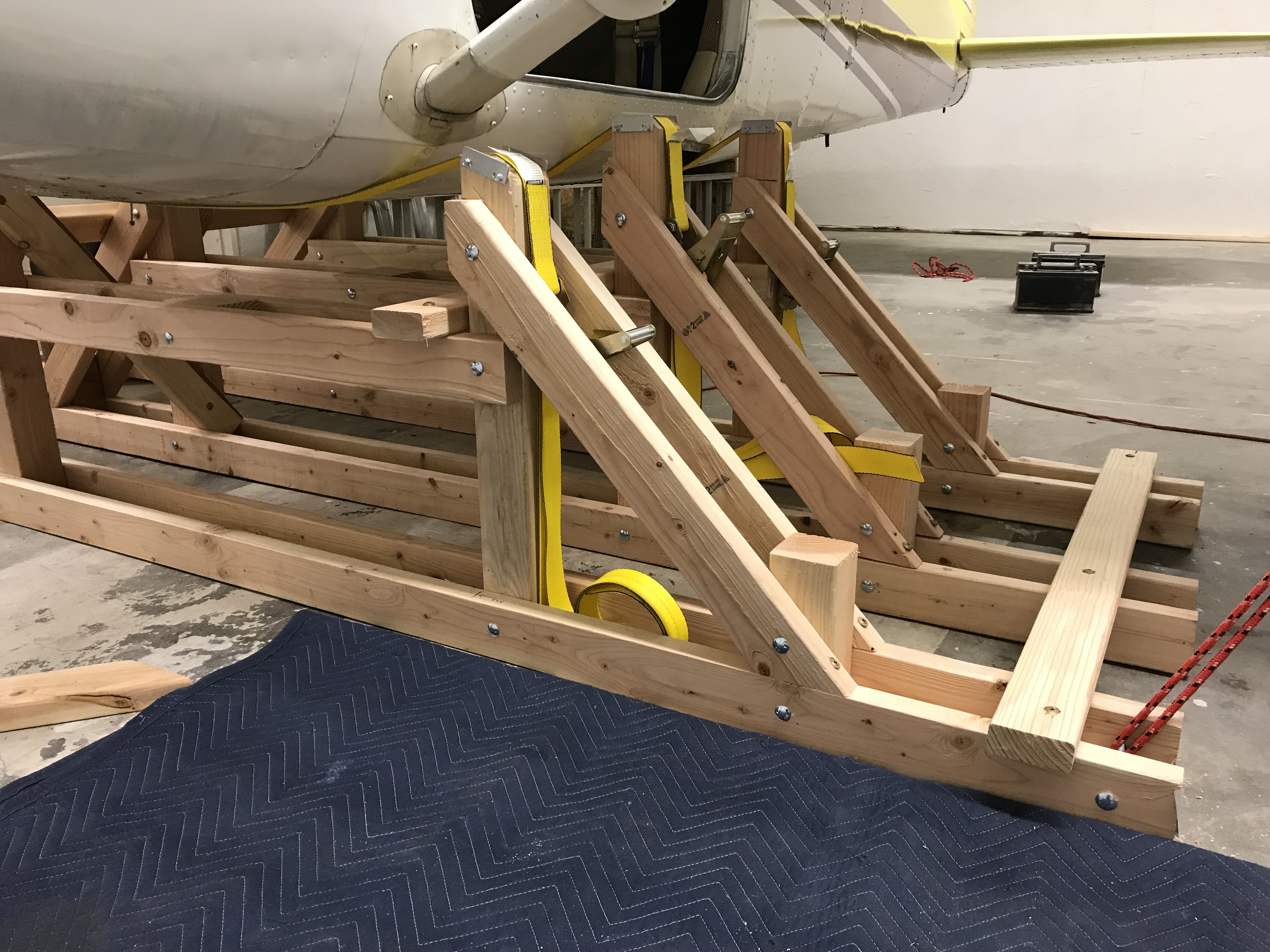

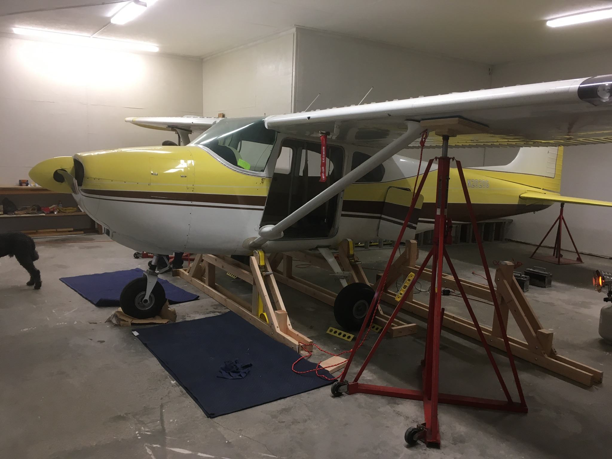

Here’s what I built to get the gear off and sent out for refurbish. Took about $200 in parts and a day’s work. Ironically I couldn’t find any “bundling straps” anywhere in my city. Everything has hooks on it and I just wanted a plain 20’ strap with a ratchet. I finally ordered online from Rachet Straps USA. The straps are great. 2500 lb working load and nice heavy rachets. Only about $15/ea. I figure I can give them to my mechanic when finished in exchange for a few sign-offs. These can be used on any number of 182’s and smaller. Make them a little wider for anything larger. The airplane ended up with about 80 lbs on the nosewheel and everything else balanced nicely with 1/2 tanks. Tied the wings to the end of the forward floor base so the plane won’t rock much. I can climb in and easily work on it. The cradles are positioned under the 3 major cross-pieces of the cabin area. I also made the load distributing pads (12” square) for the stands to go into. 2 pieces of 3/4” plywood glued together and topped with a piece of glued on ensolite pad. I have to give the jacks back until the gear returns so I needed this kind of alternative for the next month.

BirdyinBOI wrote:Here’s what I built to get the gear off and sent out for refurbish.
That is awesome! I saved the photos for future reference. Do you happen to have any others showing different angles?

I must admit that is an admirable setup you built. As with many engineering problems there are several ways to achieve the same result. We had several solutions to deal with aircraft that needed to be gearless. On larger aircraft, like Twin Otters we made fitted cradles from plywood with carpet for padding, usually 8-12" wide. For smaller aircraft we used the simplest solution, giant foam blocks we acquired salvage from floating lake docks. They where 36x36x120. So something like a 182 we would lower it on two with some smaller foam block to meet the curve. As far as an aircraft was concerned, it was like laying on a big marshmallow. If they still ad wings attached, then we used some wooden pogos on the outboard ends of the wing, usually just clamped to the end wing rib with the tip removed. We even transported damaged aircraft on trailers on these foam blocks. They had the advantage of absorbing shocks from our deteriorating roads..

Thanks!
Another pic or two...
