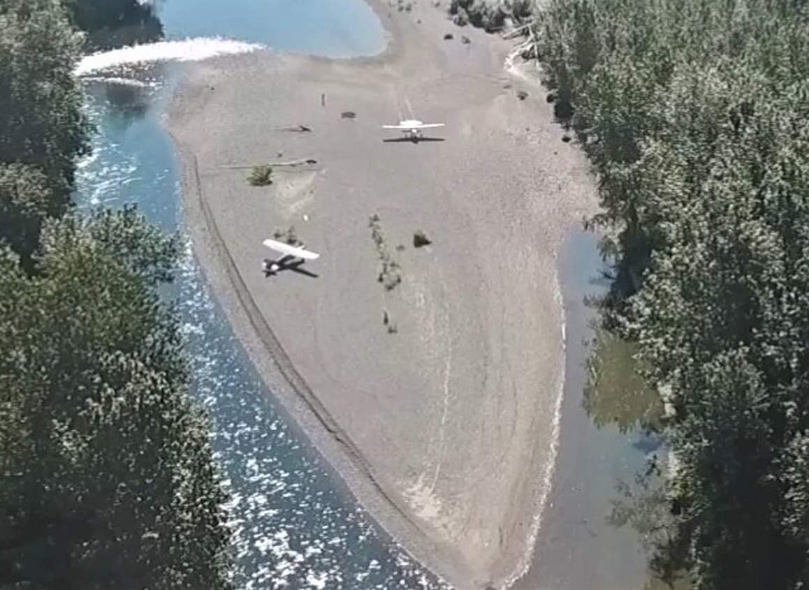

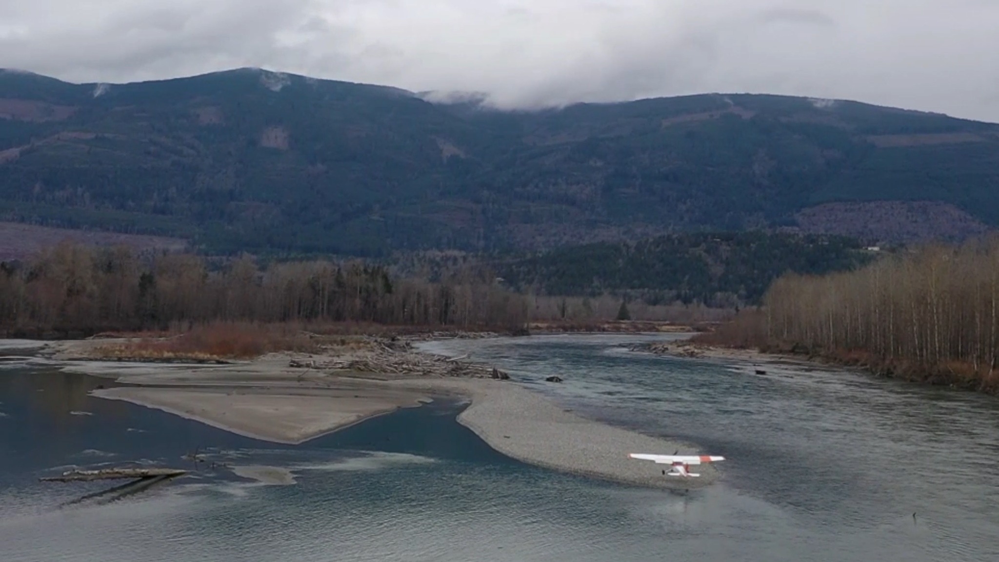

Want to add, the AoA indicator will teach you to fly the wing and find the limits of your plane.
Only way to land at this places in my 182 its by flying very slow and riding the stall warning, in my case I learned with the AoA indicator, of course you can learn without it, but trust me a device that teaches you to fly the wing its not useless, its also very accurate Vx, Vy, Vg.

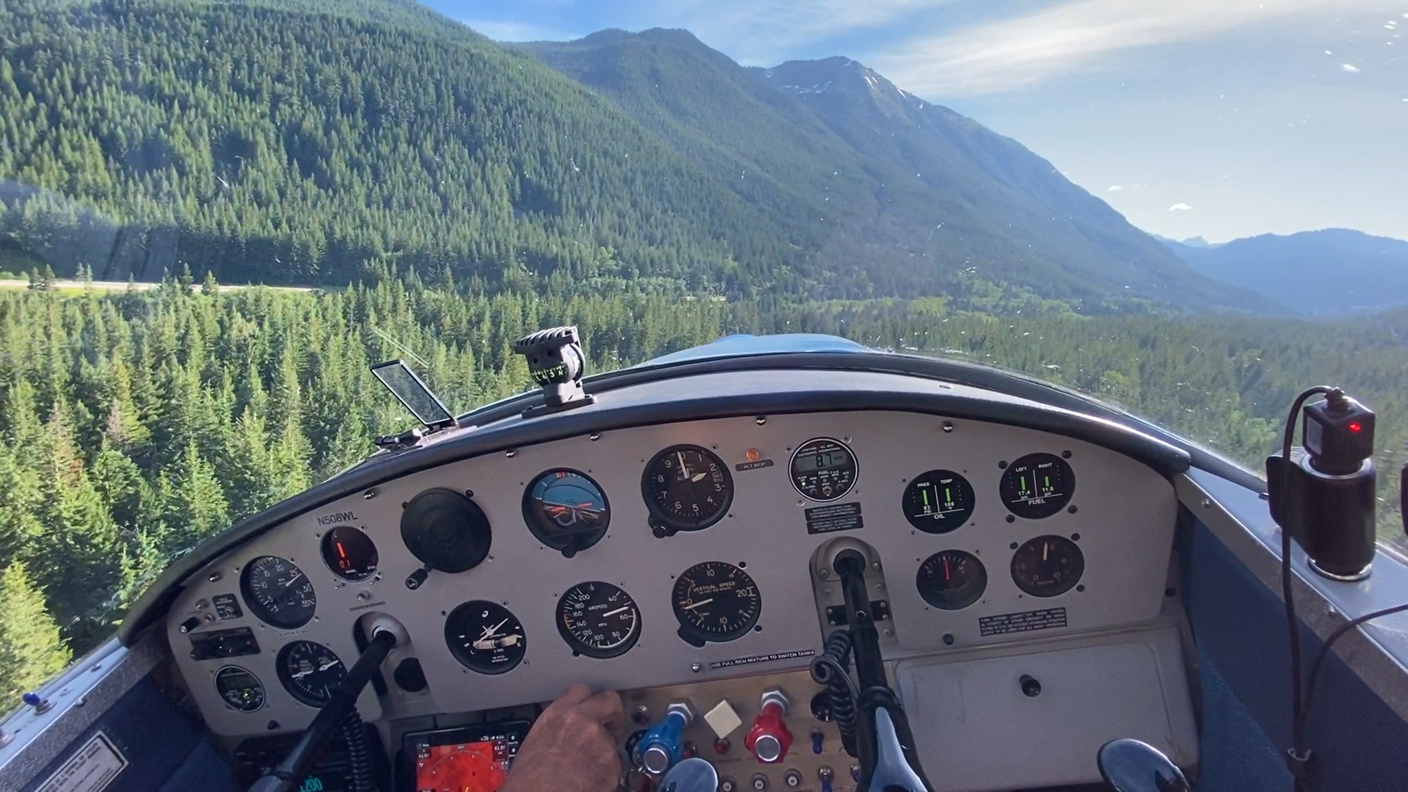

Totally agree with MTV about the training nowadays, you can see the 747 patterns all over the place.
I don't like cluttering the panel and cockpit either, no Ipad, no Iphone, just one small GPS, you can see in picture the AoA HUD with the slip indicator.(There is an AV30 now where the black instrument cover is)
No need to look inside the cockpit when maneuvering or landing.
Calibration its easy , I did mine 10 years ago in the 182, and never had to do it again.
The AoA indicator is no replacement for slow flight or stalls practice , those should be practiced often if the pilot wants to be proficient in the plane they fly, which its an important factor because there are lots of pilots that never practice a stall, slow flight or an emergency after getting their license, an AoA indicator can help this pilots and save them from mistakes.
